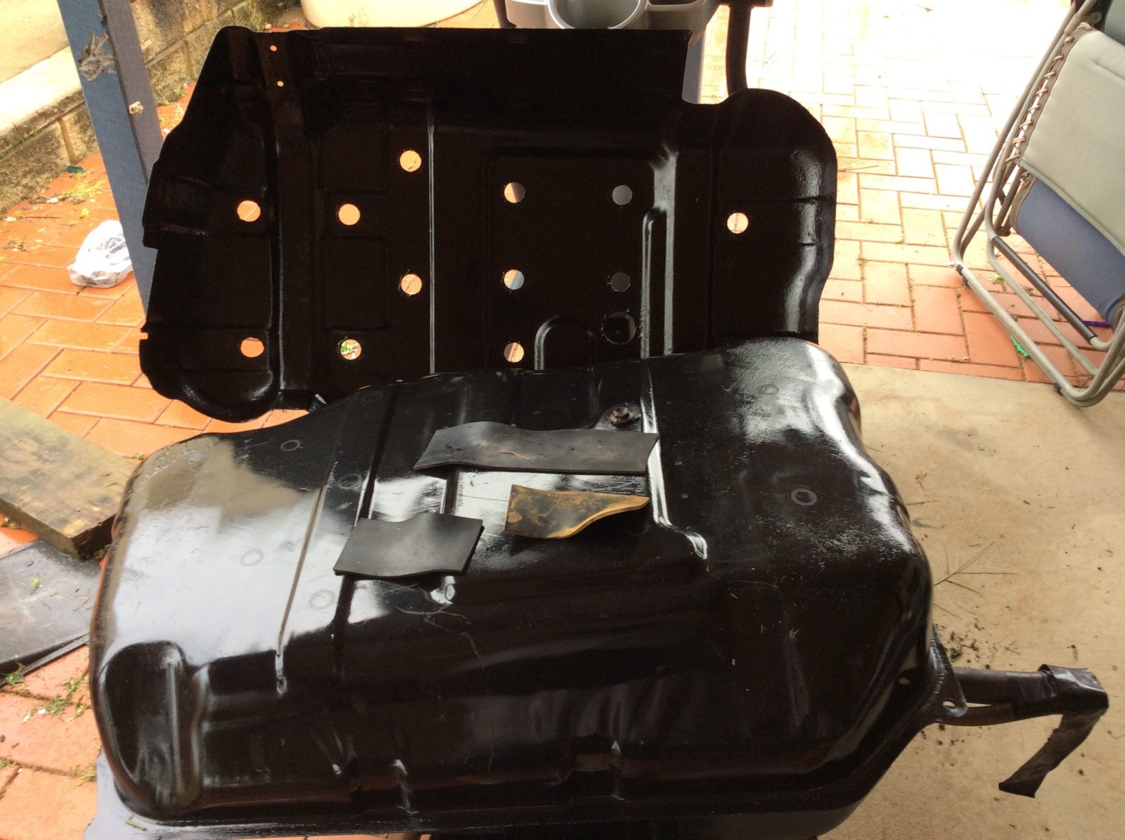

Hi My name is Warwick I have an 2005 standard 105 and live in North Queensland. I need some help please. I had a leak in the main tank so I took it out to repair and address some corrosion on the tank and tank guard. This took longer than planned and I mistakenly didn’t take photos beforehand or along the way. I’ve been able o find photos of where the wear rubber strips go on top of the tank (attached photo) but am unsure where they go in between tank bottom and guard. Does anyone have a picture or can identify where on the bottom of a 105 main tank showing the rubber is either on tank bottom or stone guard top? I have three left over rubber pieces that after completing top and there’s a photo of them sitting on the cleaned up tank and stone guard.
