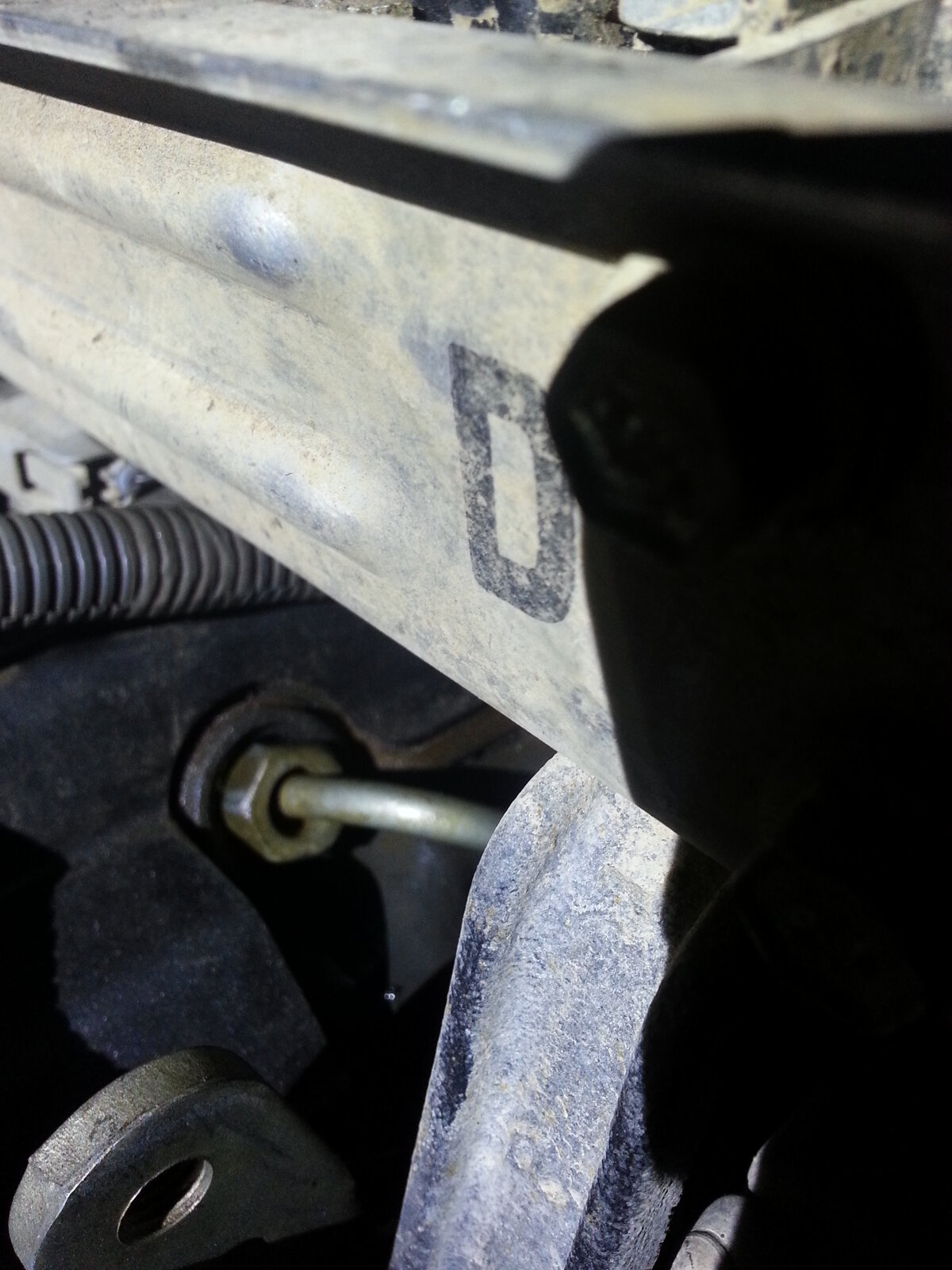

When I get home, I take a another look at the engine, and spot where the fuel leak is coming from...
Yup that's the fuel inlet pipe from the common rail to No 1 pot. So I email our friendly parts guy Simon for a price for the nozzle seal, and also the pipe.
