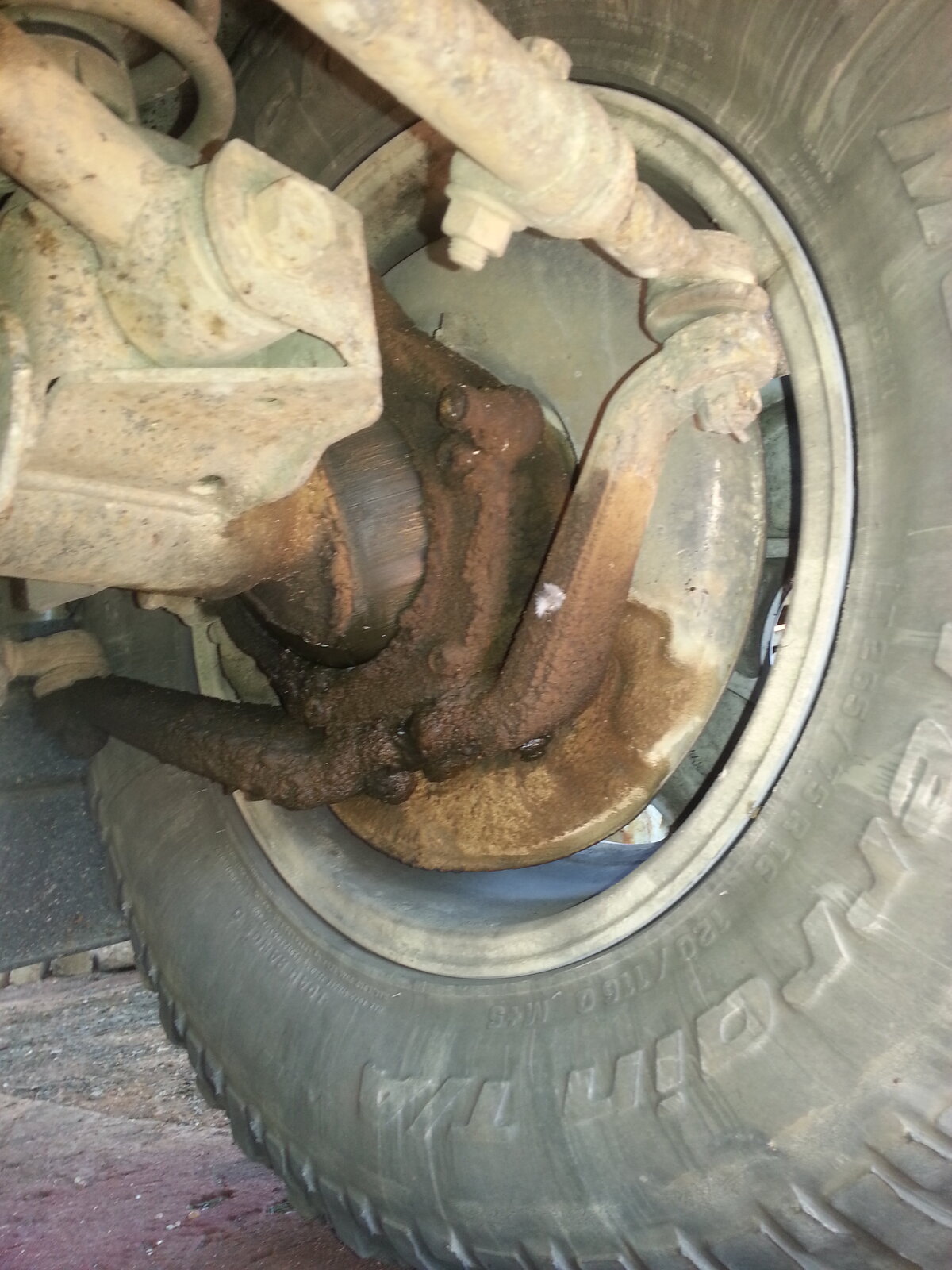

I think this needs some cleaning first:
I'm thinking that looks like the drive shaft oil seals leaking, allowing diff oil into the CV grease. Not good and the knuckle grease will probably be polluting the diff oil in return, which isn't good for the diff.
It's worth stripping down the front axle and doing some renewal before any collateral damage is done.

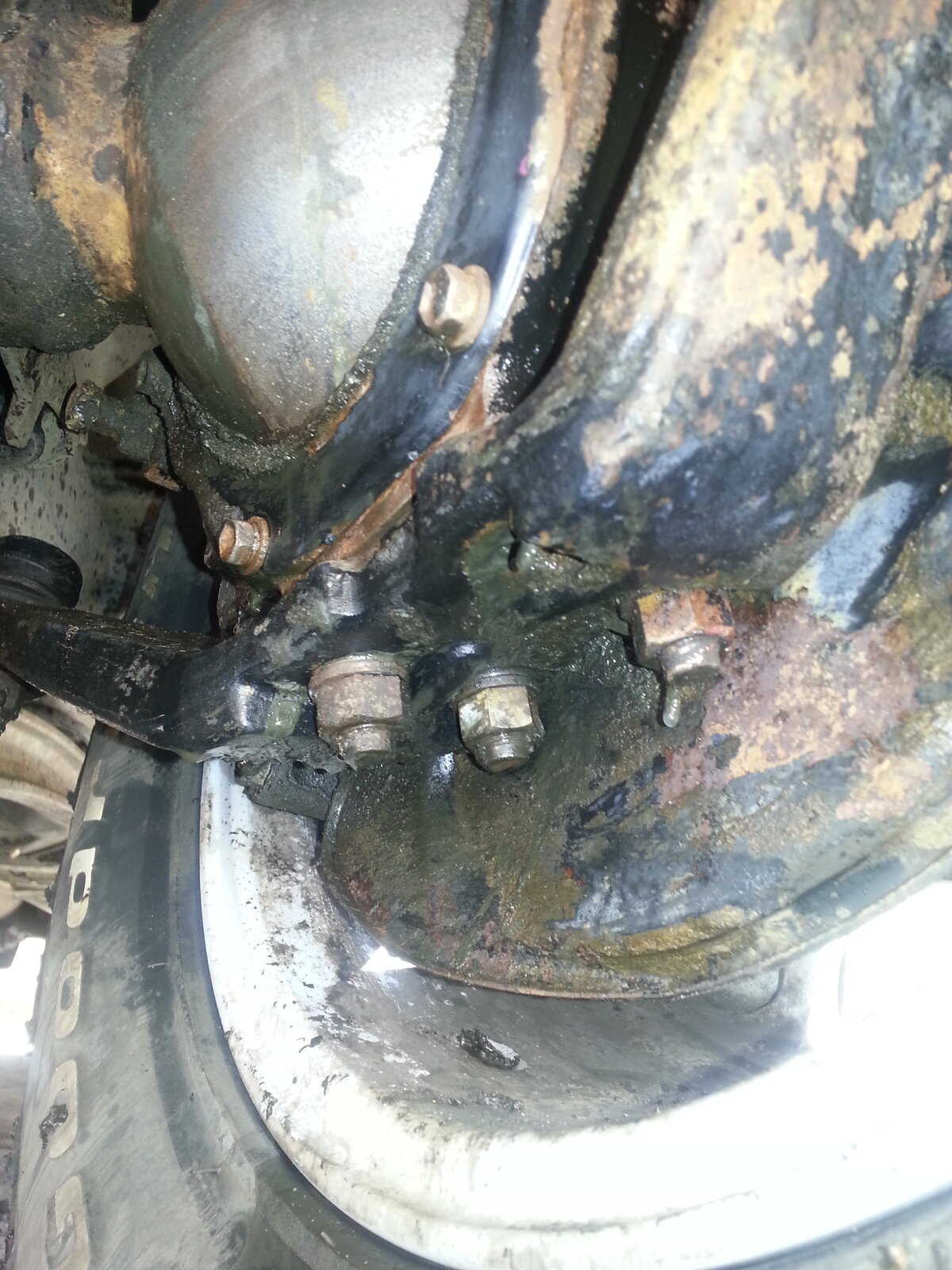

Yeah - I figured the seals needed replacing. In preparation of stripping the front axle I did some cleaning today.. hmmm arn't there supposed to be 4 bolts holding the steering arm :think:
Are they just stud bolts or something else? Anyway I'll head over to the dealer some time and find out... hopefully not too much hassle to fix..
I think I'll paint the axle and various bits and bobs there while I'm at it.
Pretty sure it is somewhere between 5 and 3 studs, yes. They are a twin ended stud, with a cone washer, flat washer and a nut. Generally the nut doesn't come off the stud, the stud unscrews and falls out complete. I chemically cleaned the threads, warmed the arm and stud locked the studs in. I left them overnight somewhere warm to let them fully bond then fitted them and torqued the nuts up in rotation. Half tempted to look at using tab washers or maybe wiring the nuts in place. They shouldn't come loos if done properly and checked regulalry I guess.
As a matter of interest Chris, do the threaded holes go right through into the CV chamber or are they blind?
I mean, if one should drop out as in James' case, will grease migrate out of the CV chamber as it appears to be doing in the photos? :think:
The holes do go right through Clive yes. You could actually do something inside the hub to fix them in there if you wanted to.
The CV grease doesn't really migrate much at all. Even with gravity. But what does happen is that the inner axle seal fails and the oil that enters the hub washes the grease out. That's why it look so damn awful.

I think the bolt has actually broken off, I tried pushing a skrewdriver in to check but it only goes about 1cm in. I hope there is a bit of the bolt sticking out on the other side which would make it easier to remove...

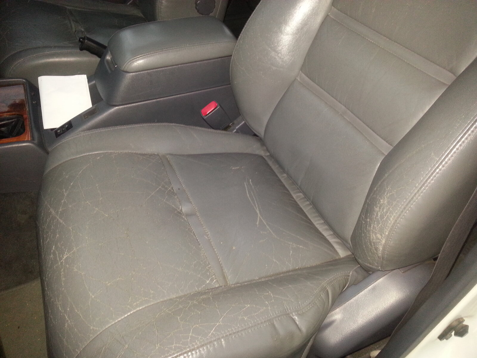

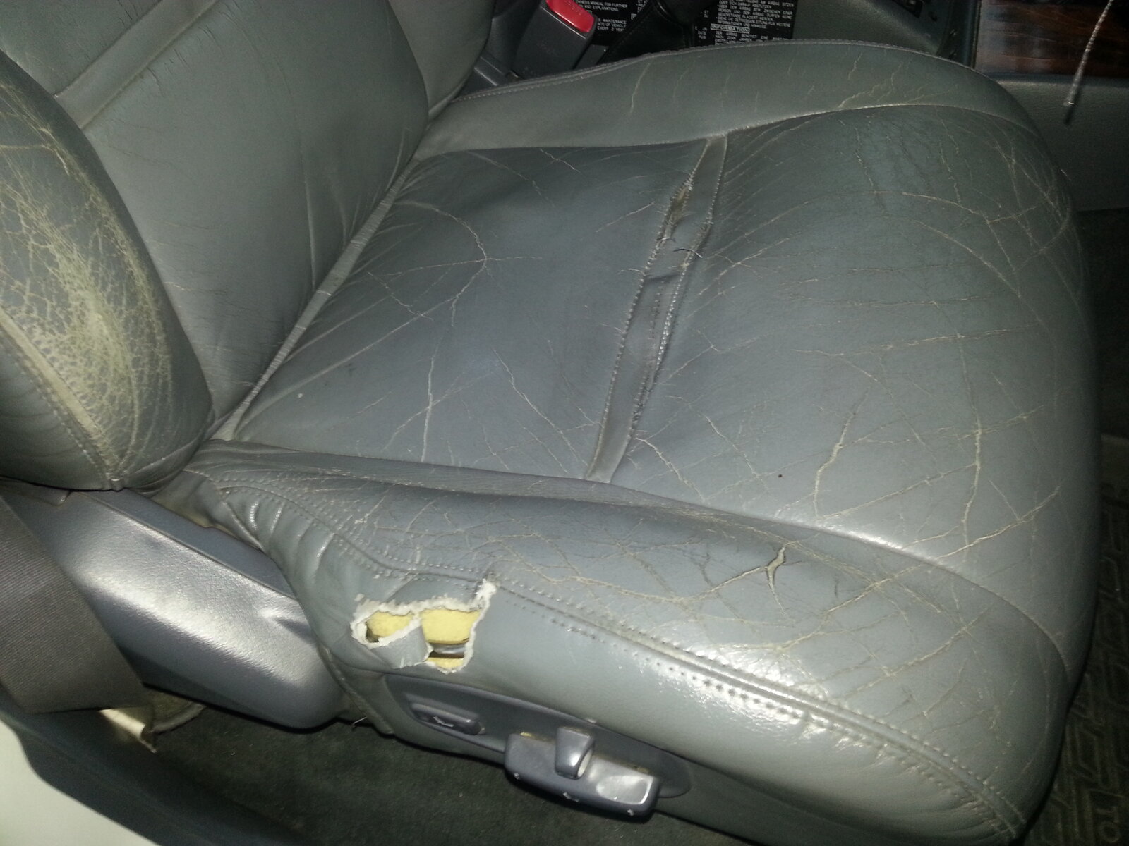

Tomorrow I'm gonna get these fixed up. The upholster will replace the leather on the front seats and make a canvas cover for the back ones.
Over the last weekend I rebuilt the front left steering knuckle, put a new studbolt in where the old one had broken off and glued all of them in place. Although its a relatively straight forward its a real PITA to do - not to mention the cleaning required. I also took the opportunity to paint the hub.

Got my back seat back, on Monday too. Got them covered with grey canvas. Should give some protection against the kids and dog..
Hopefully the front seats are done soon.
