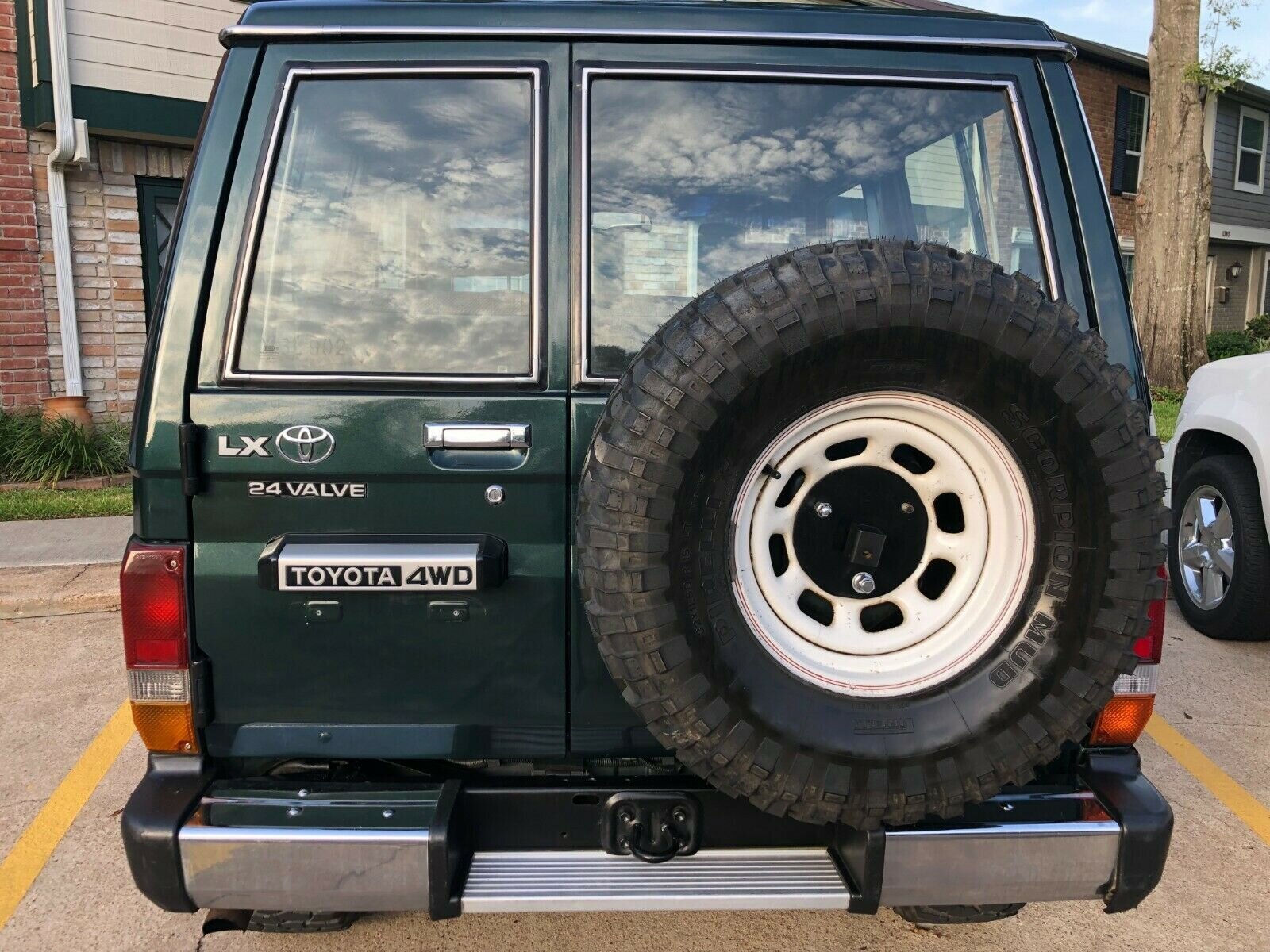

My FZJ 70 with original steel wheels are 15 inch. I've been searching for original tire size too. I've not been able to find the tire size data yet. I've attached a photo for you. This one was built in Venezuela and I'm not certain if the origin makes a difference in the actual wheels that were fitted originally. I'll let you know if I dig up anything.
