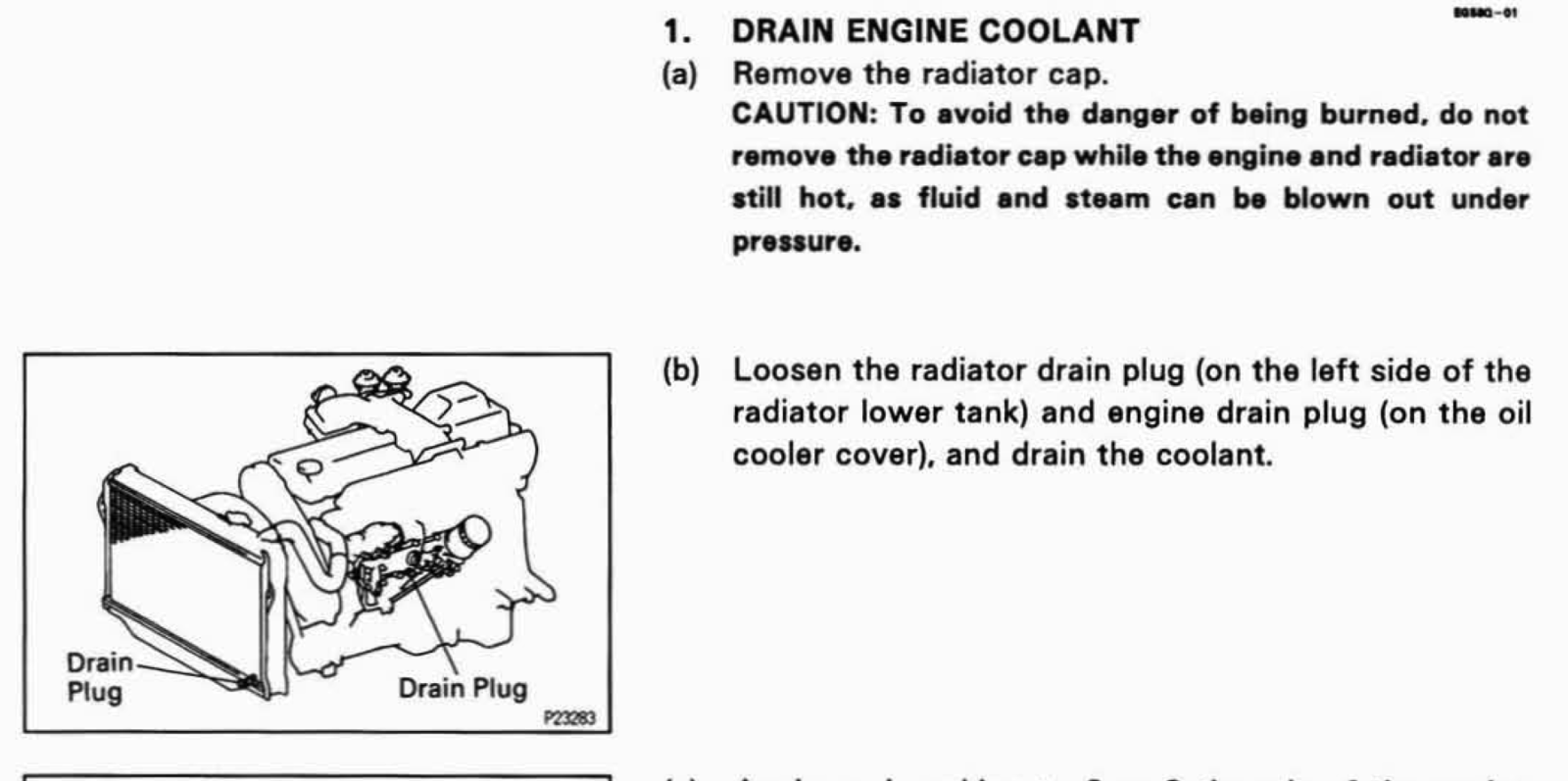

Can anyone point me in the direction of the drain plug on the block. I know its been covered before but for the life of me can i find it

No sign of a drain plug on mine in the position mentioned, just what looks like a core plug as in Lexie's photo. The FSM for the 1FT motor shows the drain plug on the oil cooler cover forward of the oil filter so maybe we're looking in the wrong place?

Trust Mr T to hide the dam thing behind IP .. tut tut
