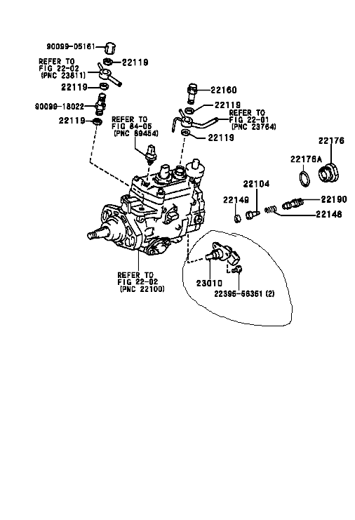

can the timing control valve in the fuel pump cause all that cuz i found that the wire connector to it is burnt
also the engine wiring harness is bit old but it works fine i guess it had some repairs in the past
I'm not sure, but I guess it could. I'd fix the burnt connector and make sure there's 12v going to it etc,,, for starters anyway.
