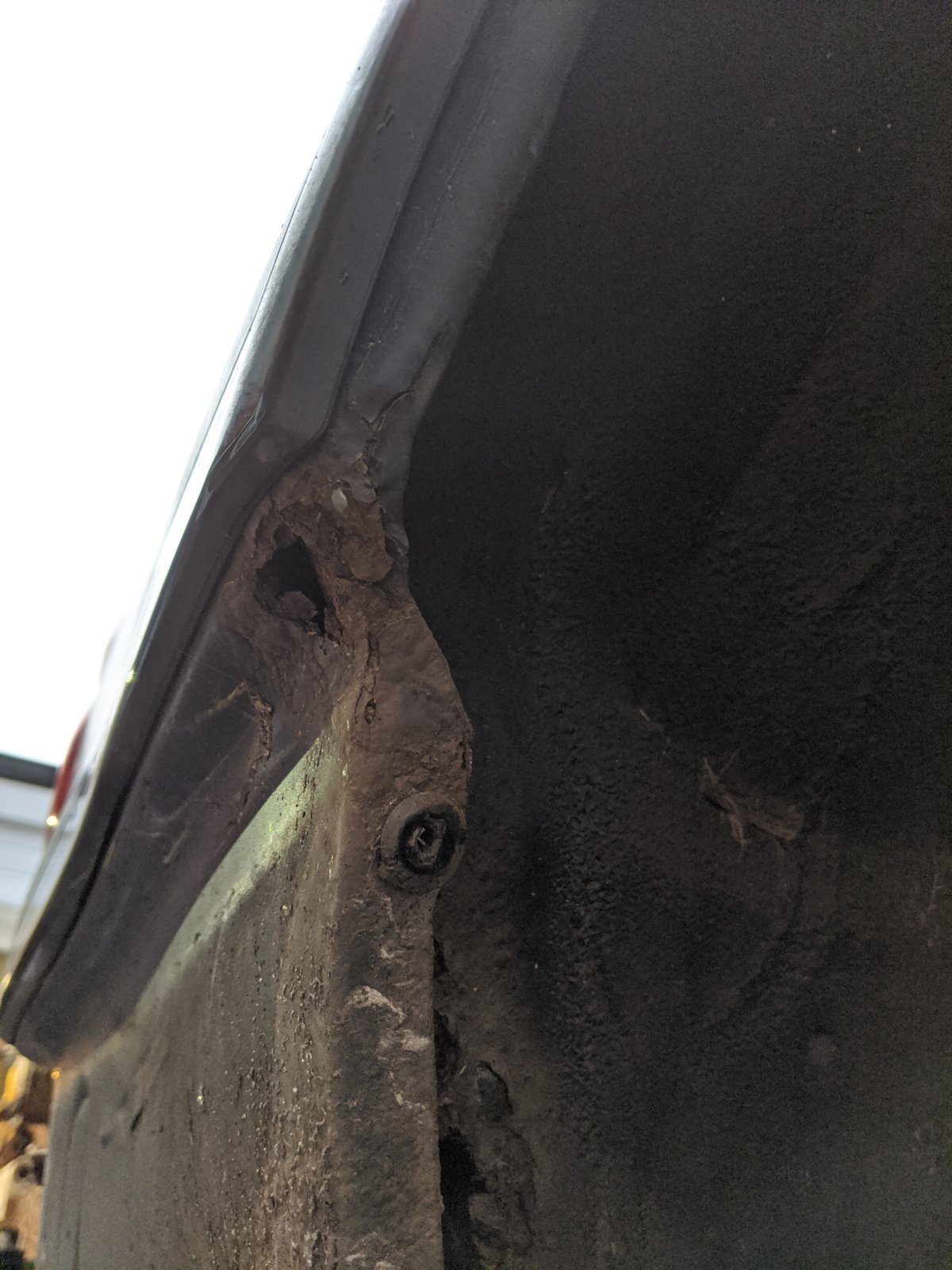

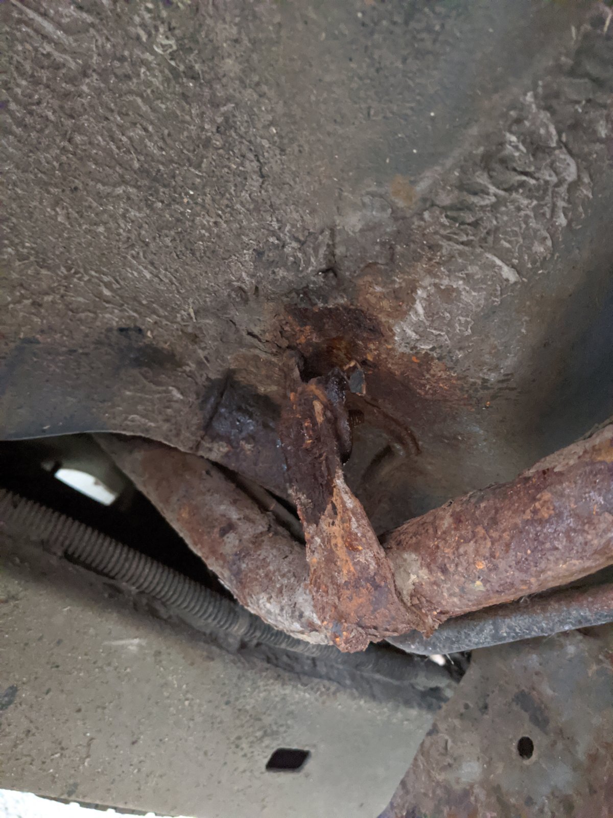

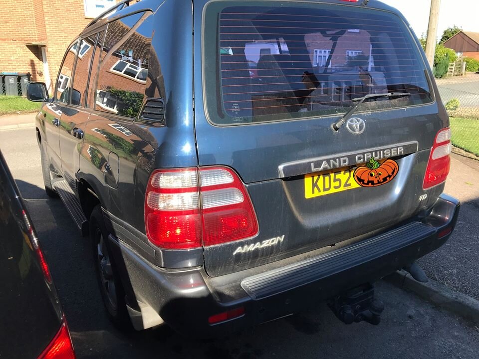

Knowing that its got rust that needs tackling ive removed the rear bumper. Its not great in behind there so rather sooner than later. One side has lost a mudflap bracket and the fuel filler neck is not attached to the body anymore so that needs doing too now !
Upon removing the bumper the original 4 parking sensors are not connected and the replacement 4 are so brittle they are falling out so I think ill be getting the holes filled in and just using a reversing camera.

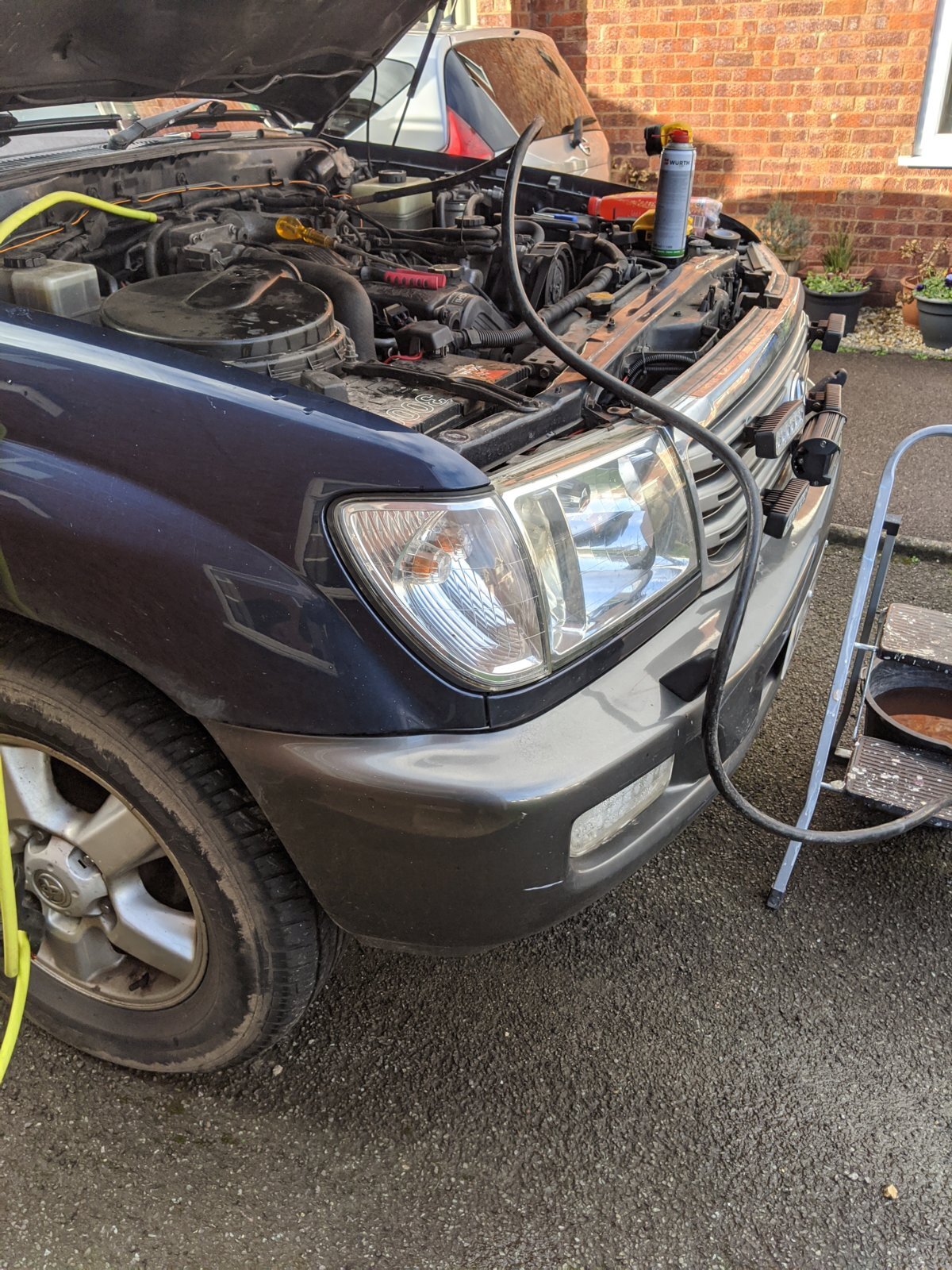

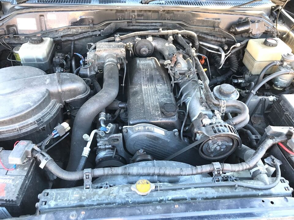

Finally ive been looking at my heater system to see why its not very warm. Coolant level was ok so checked the fan and that seemed ok to. Flushed the heater matrix and got some crap out. Also removed the interior temperature sensor that was full of dust and gave that a blow out too.
With all that it seems that the heaters both front and rear and now improved - ill have to keep an eye on things as all thats left that not been tested is the thermostat but thats for another day !
