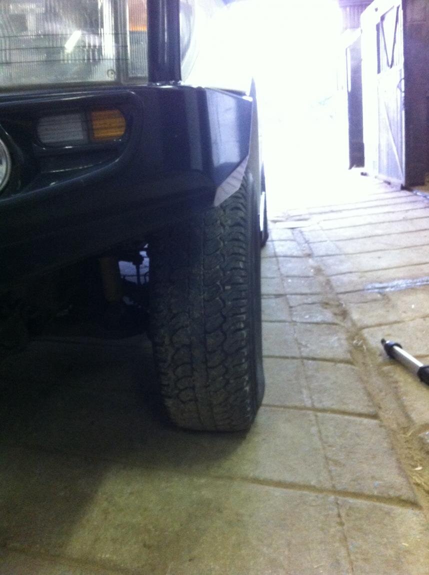

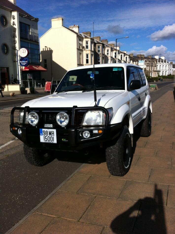

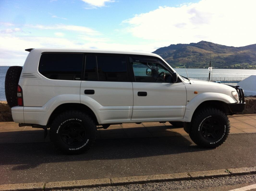

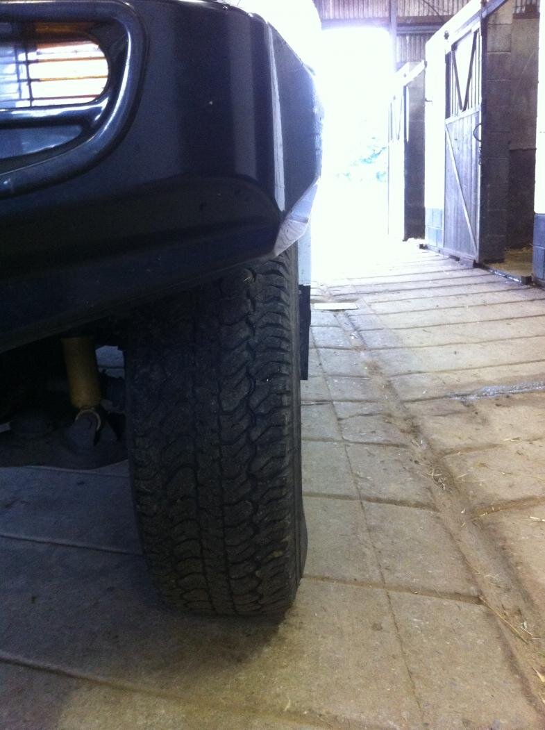

Gav - here are pics before and after spacers on standard wheels and tyres!
berfore...
after....
ok, pics above are a bit arseways.... anyhow, theres 2 of it with standard wheels and tyres before and after the spacers for Gav! and the other 3 are of it fitted with ome suspension, 255 85 r16 bf muds and last pic is of a recent trip to uk where it got itself a maggiolina rtt! will do up a small build thread when i get a chance next week! away again this weekend on a charity 4x4 challenge!
