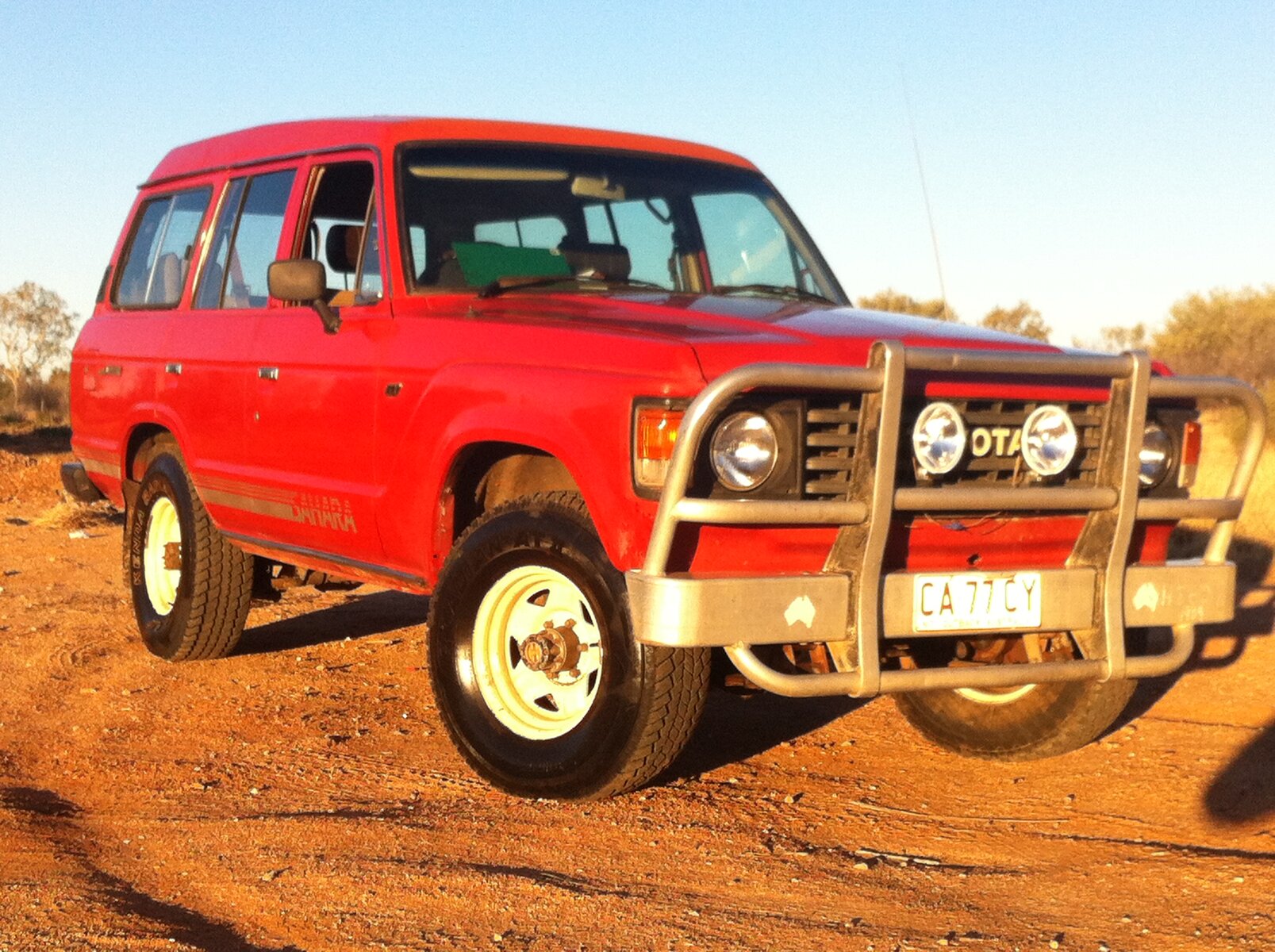

    This is it after the has been done and a quick cut and polish. Not quite sure though how to make the picture any bigger.

    Ok, it loaded up to a decent size then.

    Wow it looks great. We just don't get them in this country in that condition. I have a couple of Turbo Kits S/H if you want to PM me. Even with shipping it may work out viable.

    Thanks mate. The beauty of it is that it's spent all of it's life in Central Australia meaning there is no rust. Well, apart from one or two minor spots on the panel work but otherwise all good. I'll do some more searching around and I might get in contact later about your S/H kits. Thanks again.

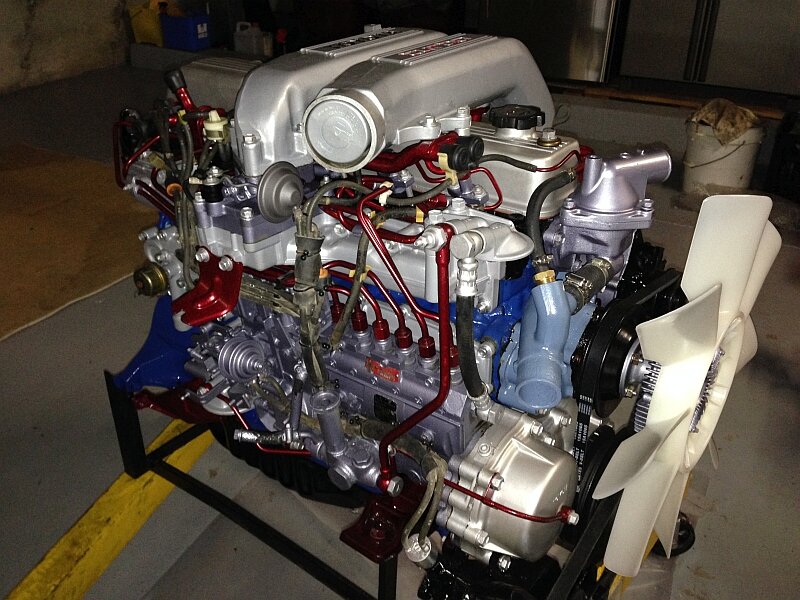

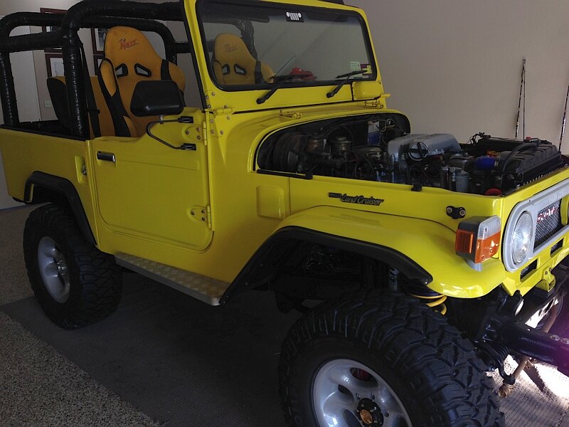

    Drop a 12ht into it, you will always be wondering otherwise?

    oh dear, I just made a mess!! where the hell did that engine come from?

    Hi I wood love one of them a big :thumbup:Wot a engine Tony .

    Thanks Tony. That's a beautiful motor watrob. I've even had to save the image to show to my mate. I'd love to have one of those in the rig. I came across one here for $4500 AUD but I'm yet to look at it. Did you anodise the components yourself? It's given me inspiration.

    Rule of thumb is that you don't turbo a old 2H diesel, they should be rebuilt first.
    The 12HT has oil squirting for the pistons, different engine compression, different head, direct fuel injection, larger IP and is strengthened between piston 1 and 2, and turbo is water cooled as well as oil fed. Mated to a 3" exhaust with the IP turned up a touch they are good for 150hp, up from the standard 135hp.

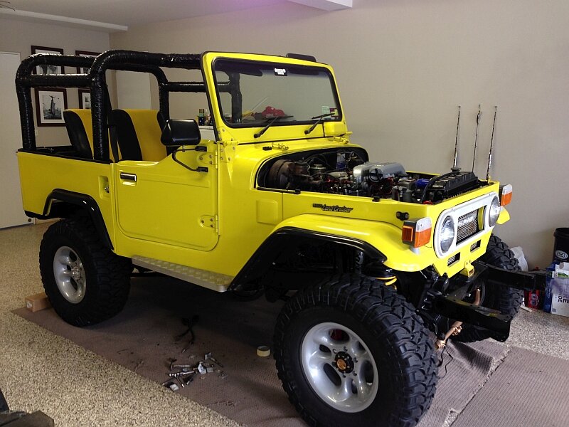

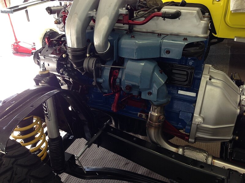

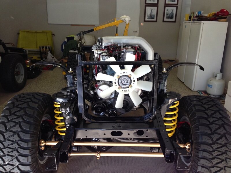

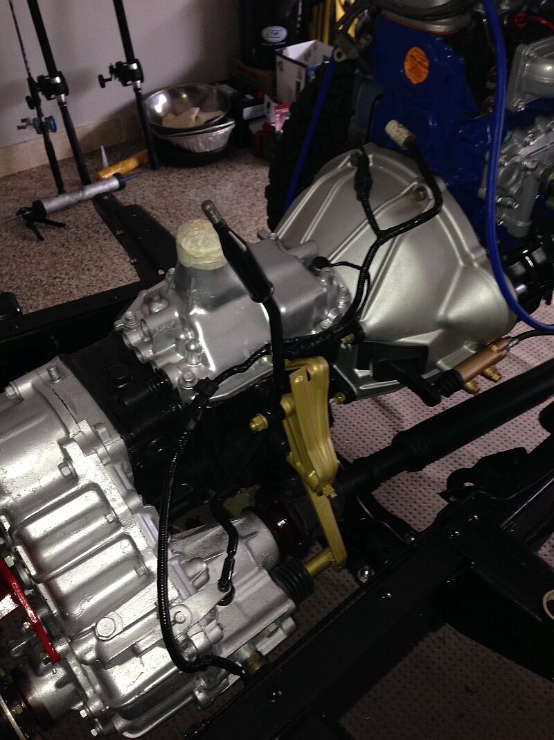

    I want to see more pictures of that truck, that looks sweet!!

    here are a few more
