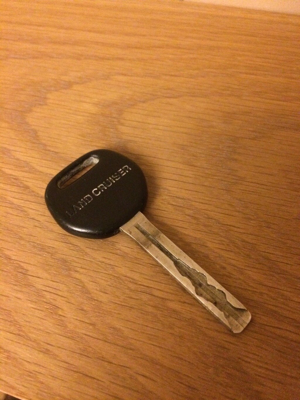

I only have one key for my 80 plus It has a starter button fitted which I assume is because the ignition switch has failed.
We have a 80 petrol here which I'm going to use for parts and it has three keys. If I swap the locks and barrel over how can I get it working? Does the 80 have a immobiliser box that can be swapped also?
Cheers, Mart

Going back to the question you ask. You should be able to use the key. Your truck will be starting without using the transponder.
I will take a look, cheers folks.
If I turn the key to start without using the button the solinoid does clicks like it wants to go. It is a genuine and old key that I have with it.
Sounds like its been modified to bypass the immobiliser. If you want to get it back to standard you will need a fair bit off a same spec vehicle from a breaker, ie Keys,barrel, signal reciever and ECU which recognises the key, also all the door lock,tailgate and glove box. Also the alarm from a similiar year will fit straight in, the TVSS system but you will need the fobs which match.

I've just had a quick look. The key and locks look original. Wiring to pump looks factory too.
There is a chance that when the previous owner bought it with no keys that they just ordered a key from toyota off the vin number and they were lucky that the truck hadn't had a lock set change at some point then.
As far as I'm aware you won't be able to use the lock set out of the petrol unless you leave the original key cable tied onto the steering colum. That way it will pic up the transponder in the key.

Strange setup, but if the immobiliser is still in circuit you should be able to program it to accept the keys from the petrol using your existing key. You can test that by disconnecting the transponder coil that is around the ignition barrel. If you disconnect that and the truck still starts the immobiliser has been bypassed. If it won't start, the immobiliser is working so try programming it to accept the petrol keys before swapping locks etc.

The immobiliser ECU can take up to 4 spare keys before it becomes 'full' but it can be wiped to remove all old keys (excluding the master) and new keys reprogrammed. This is the issue I had when I bought my LC with only one key, luckily the master key and ordered a spare. The ECU was found to have it's full complement of keys by the dealer and wouldn't take any more until the old one's were removed. There is a slight chance that wiping the ECU will render it useless, according to the dealer who did mine, requiring a new ECU and lockset. No idea how it's done though, sorry, but as far as I could see there were no special tools or diagnostic equipment (laptop etc) required.
Actually there are several different systems fitted to 80's so we need to know more about the truck, what year, what the key you do have looks like. Do the keys for the petrol 80 look the same as the key you have for the diesel 80? They do need to be using the same key/transponder type to be compatible.
Am I right in thinking this isn't even a coded key?

The truck was bought off eBay Jon by the previous owner. It had no keys etc and was down near the docks somewhere.
They have obviously just fitted a new set of locks and I expect the transponder key doesn't send a signal to the fuel stop as it must have 12v feed to it?
Happy days, I'll just get another key cut tomorrow.
