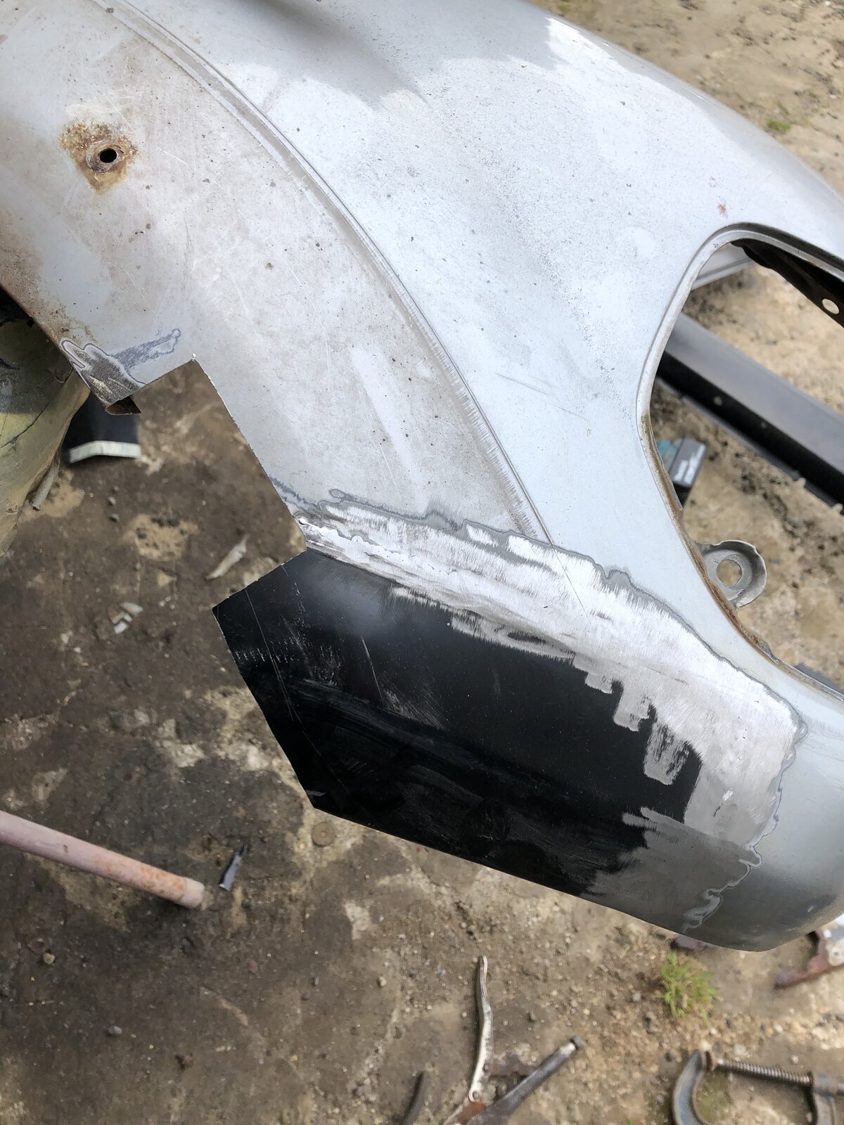

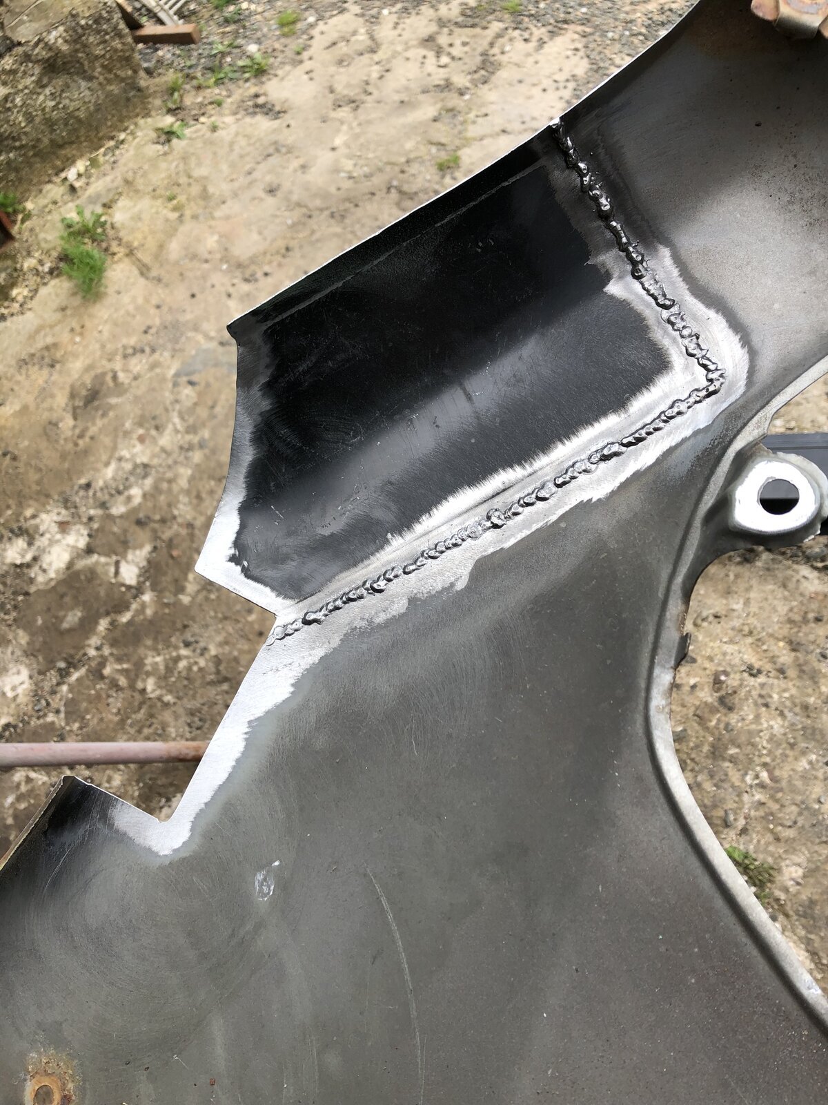

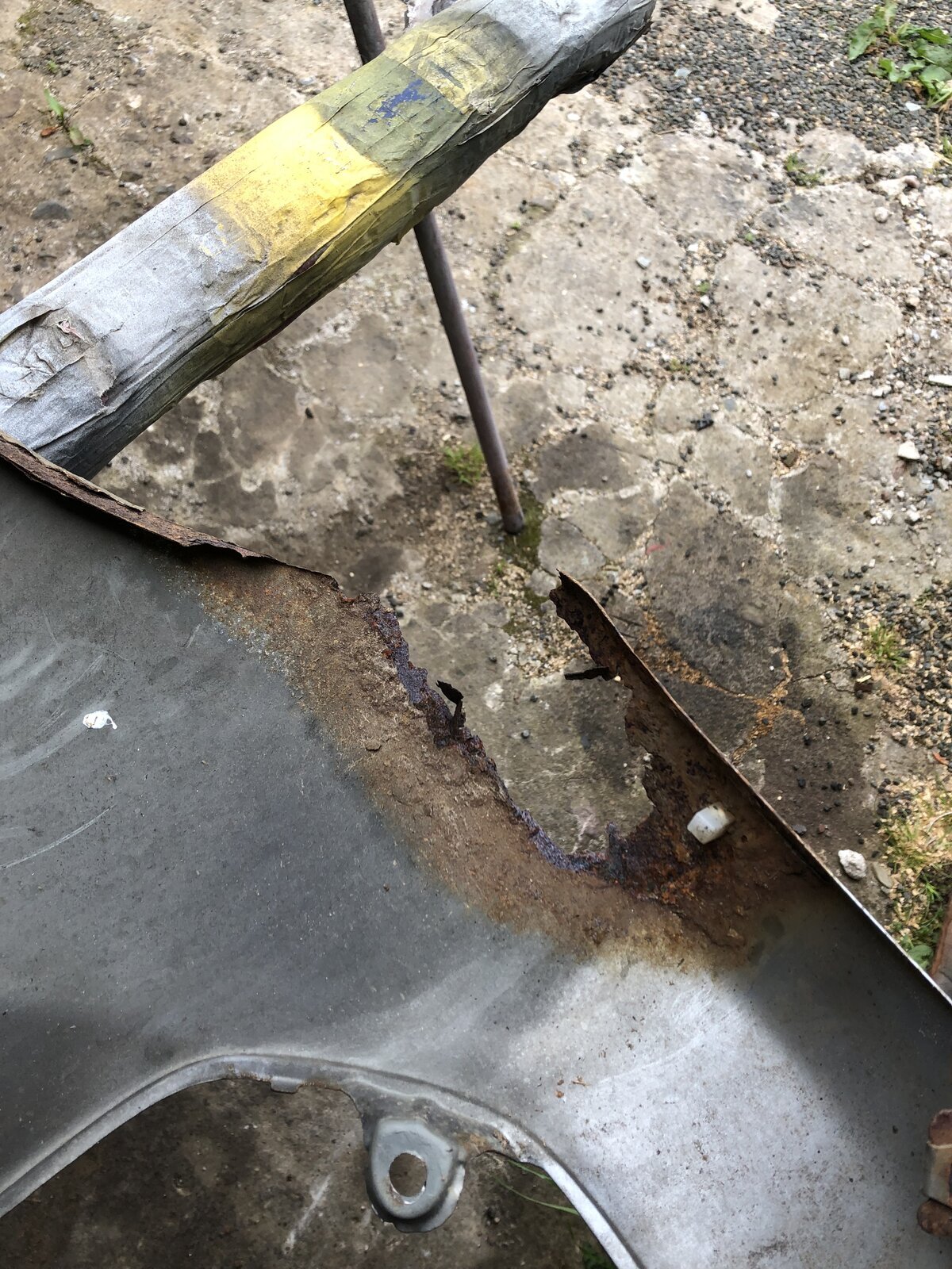

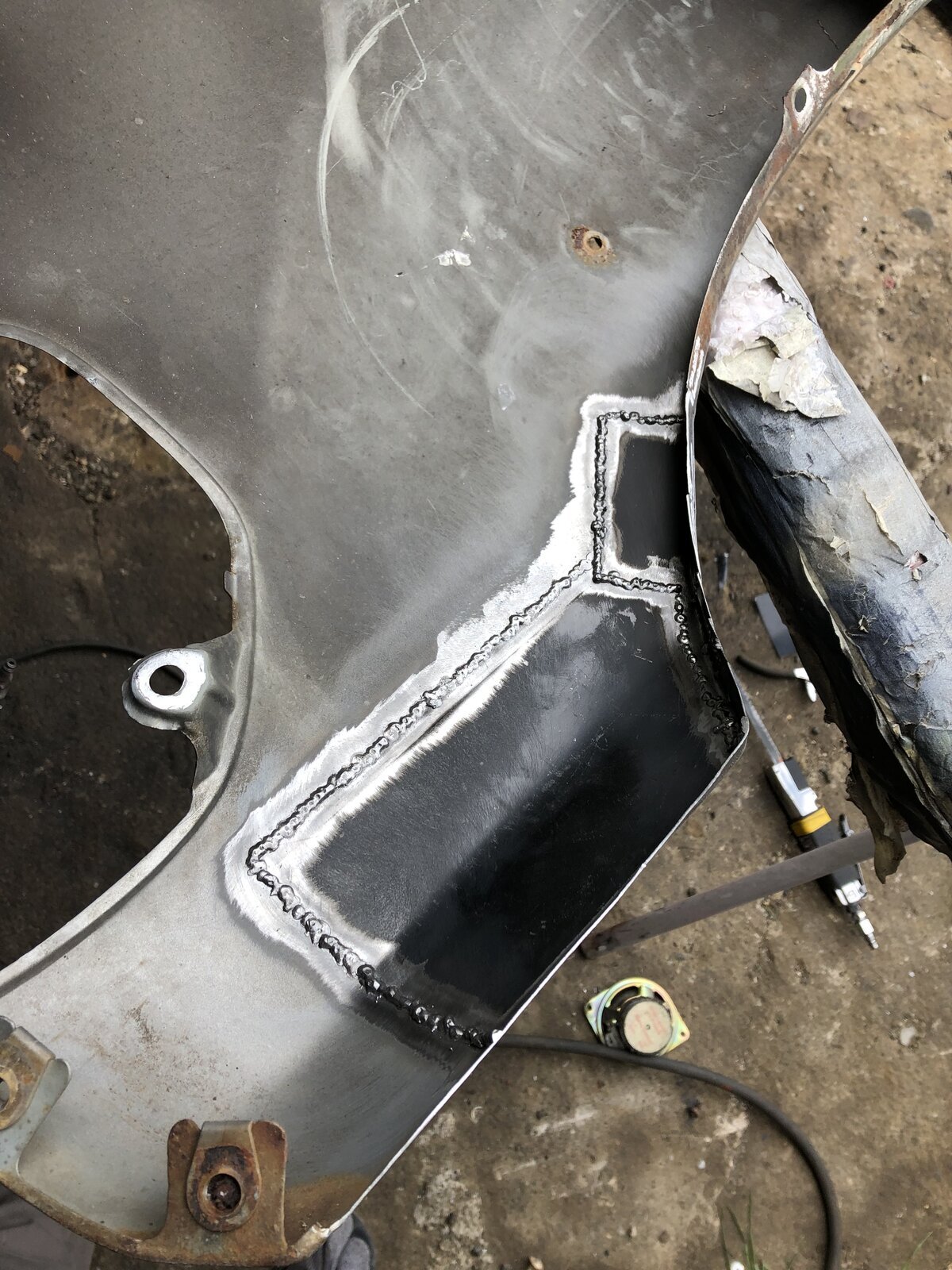

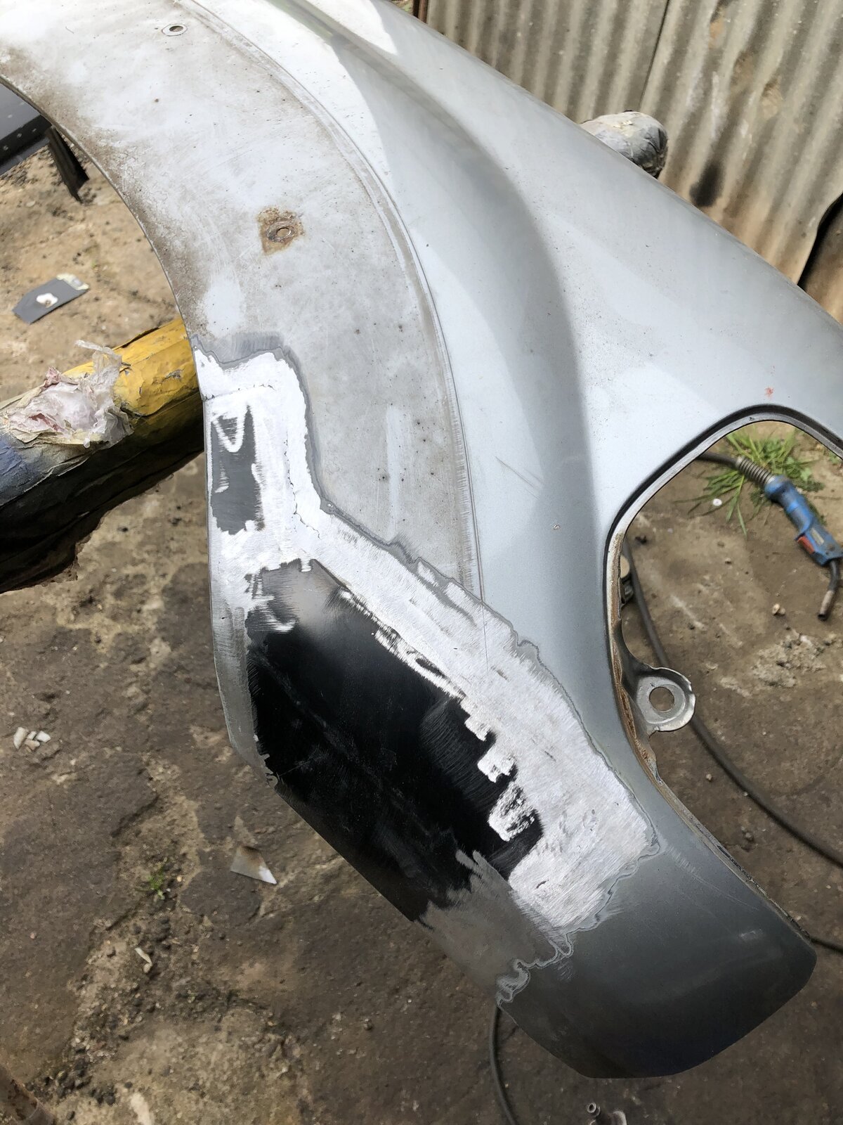

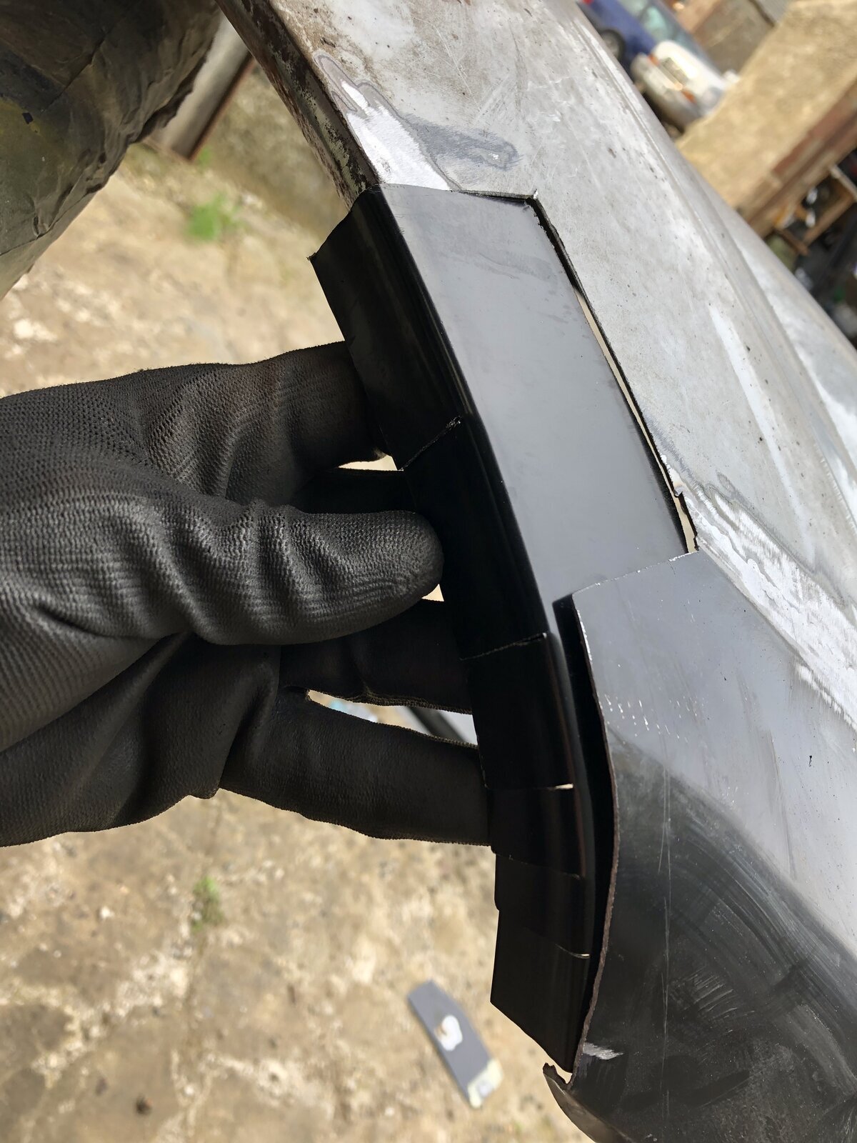

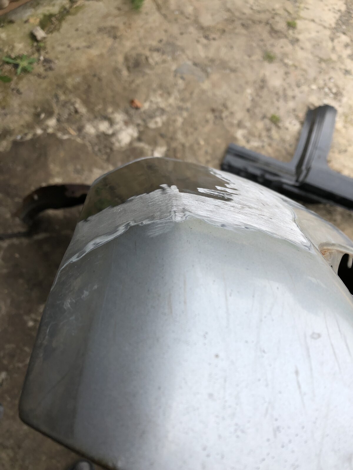

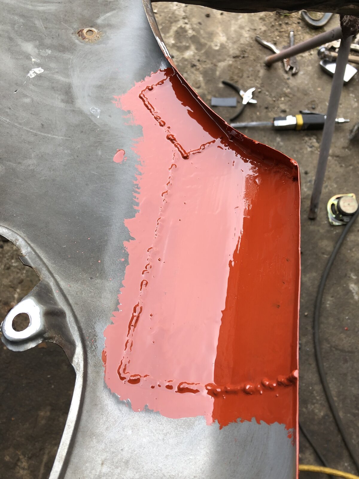

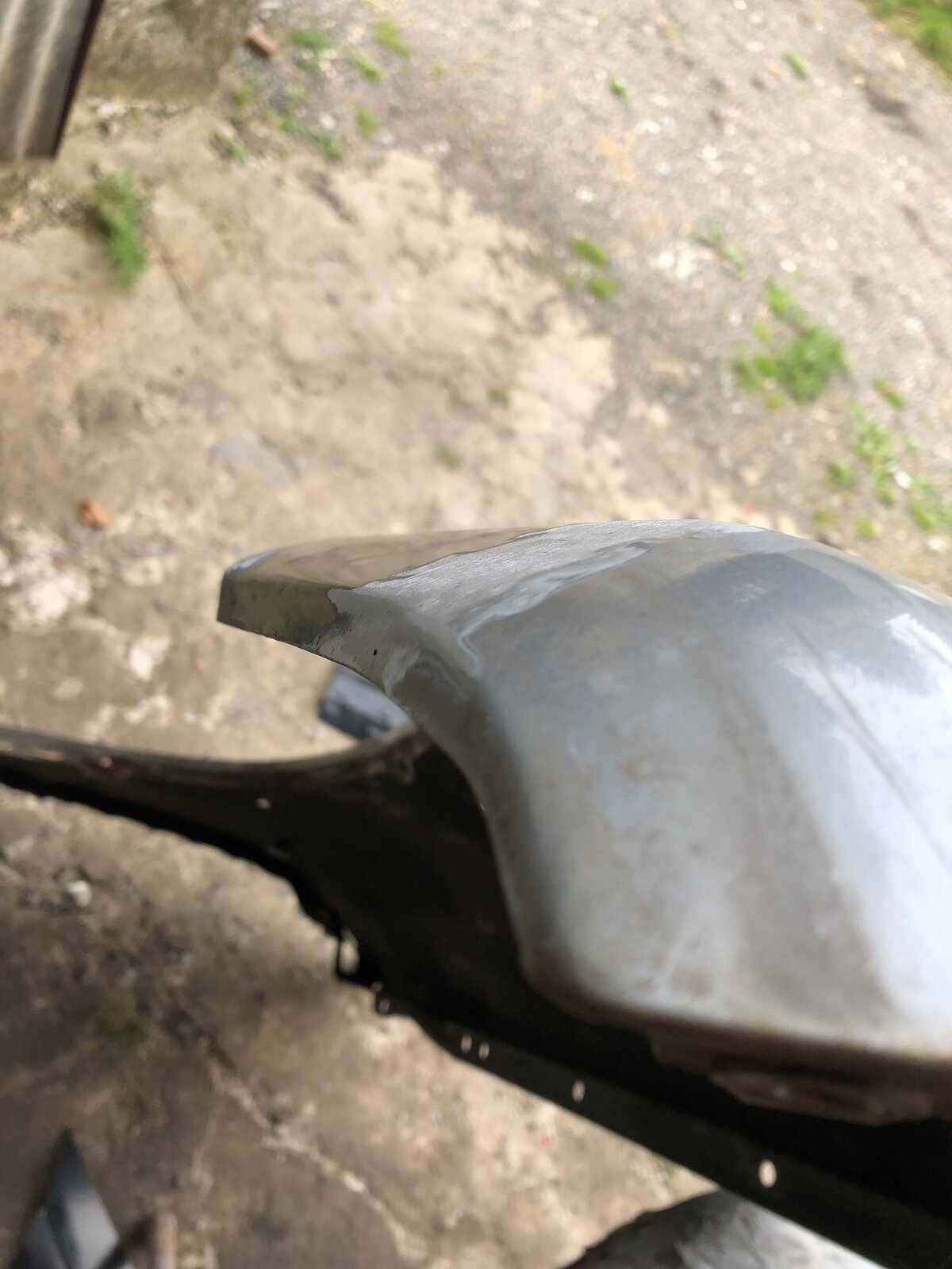

These wings came off my donor truck, didn’t realise how bad they were untill I removed the plastic arch trim….still better than the ones on mine.
I’ve been a panel beater for 11 years now starting when I was 16, finally tooled up at home now enough to take on repairs.
Thought I’d show some pictures of how it’s done.
