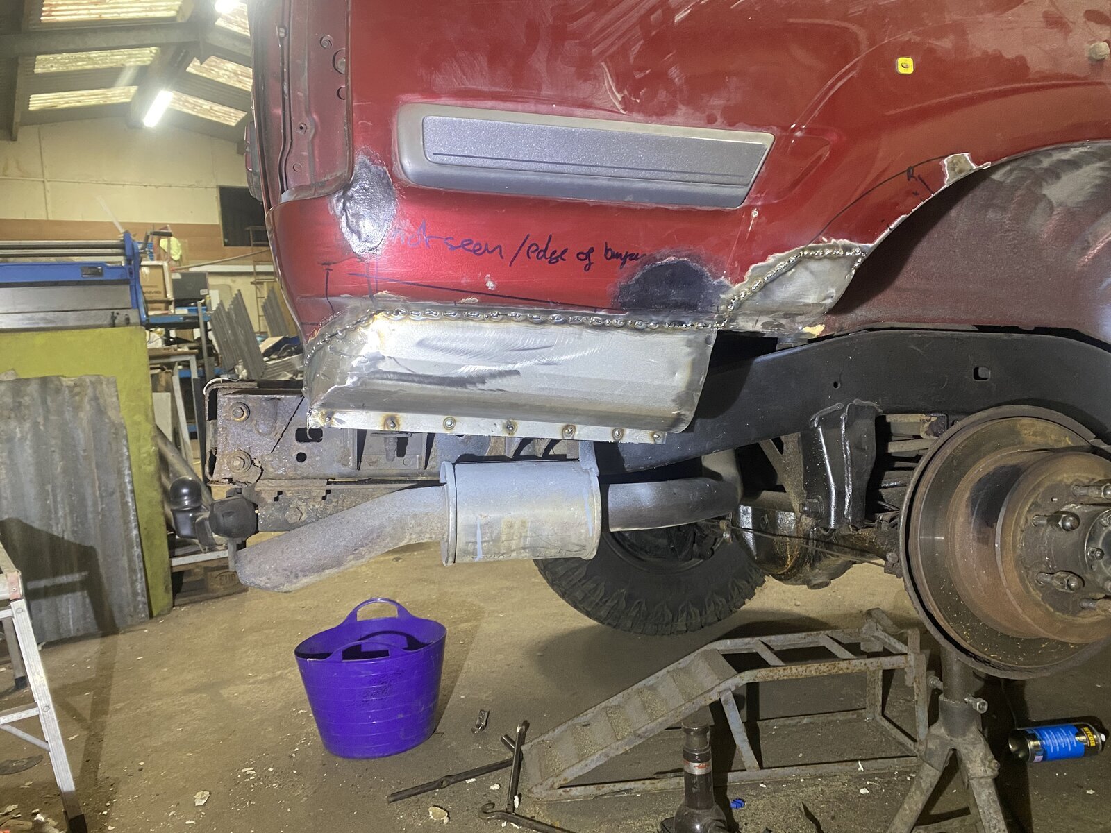

FINALLY finished the welding this morning! Everything has a coat of primer and a generous coating of underseal / filler where required and I hope to get back to the workshop for a couple of hours tonight for a bit of sanding / painting
I'm no stranger to rust repairs and I knew it would need a bit of attention when I bought it, but I wasn't expecting that much!
