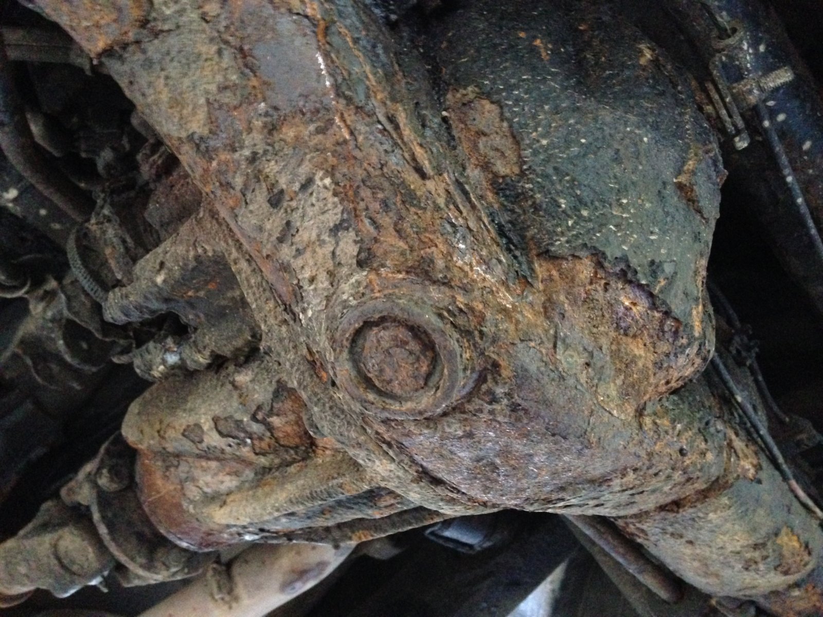

Milner sell brand new rear axles. They're empty of course so you need to swap your diff etc over to it, but it would be like one from the factory. That's a shocker. I guess the locker motor has gone too. You could get a scrap on in better nick, but you'd need to know the diff ratio first.

The big problem with the Collie axles is that the drain holes arent big enough at the base of the turrets, they get blocked up and water sits there, then the turret breaks off unexpectedly.

Having been through the headache of the rusty rear turrets, sourcing a 2nd hand one, discovering that was as bad as the original and then paying an engineering place to sort it all out. I would have bought a new casing if Milners had them at the time. I think any 2nd hand axle will need a little work to it unless you find a very good one.

Trevor does have a spare rear axle off Lil Blue but I think it's earmarked. He does also deal with Milners and of course shipping an axle to your house is no small undertaking. If you are within striking distance of Brackley, I'd give him a call and get the job done properly plus I'd have it done with his special Buzzweld coating before it goes on. There's no telling how good the paint will be on a replacement axle. Whatever you do, I'd get it coated before you stick any bits on it. Protect your investment.
