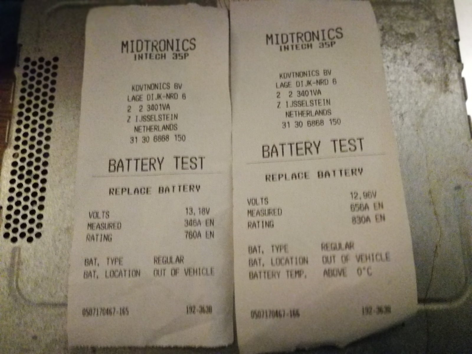

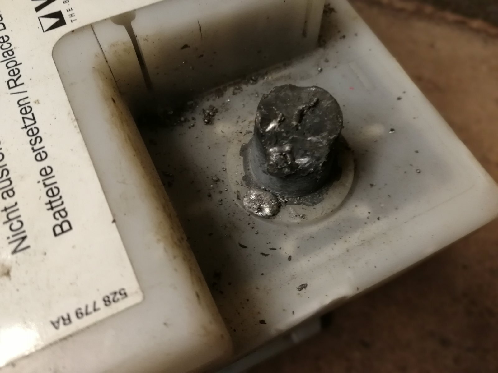

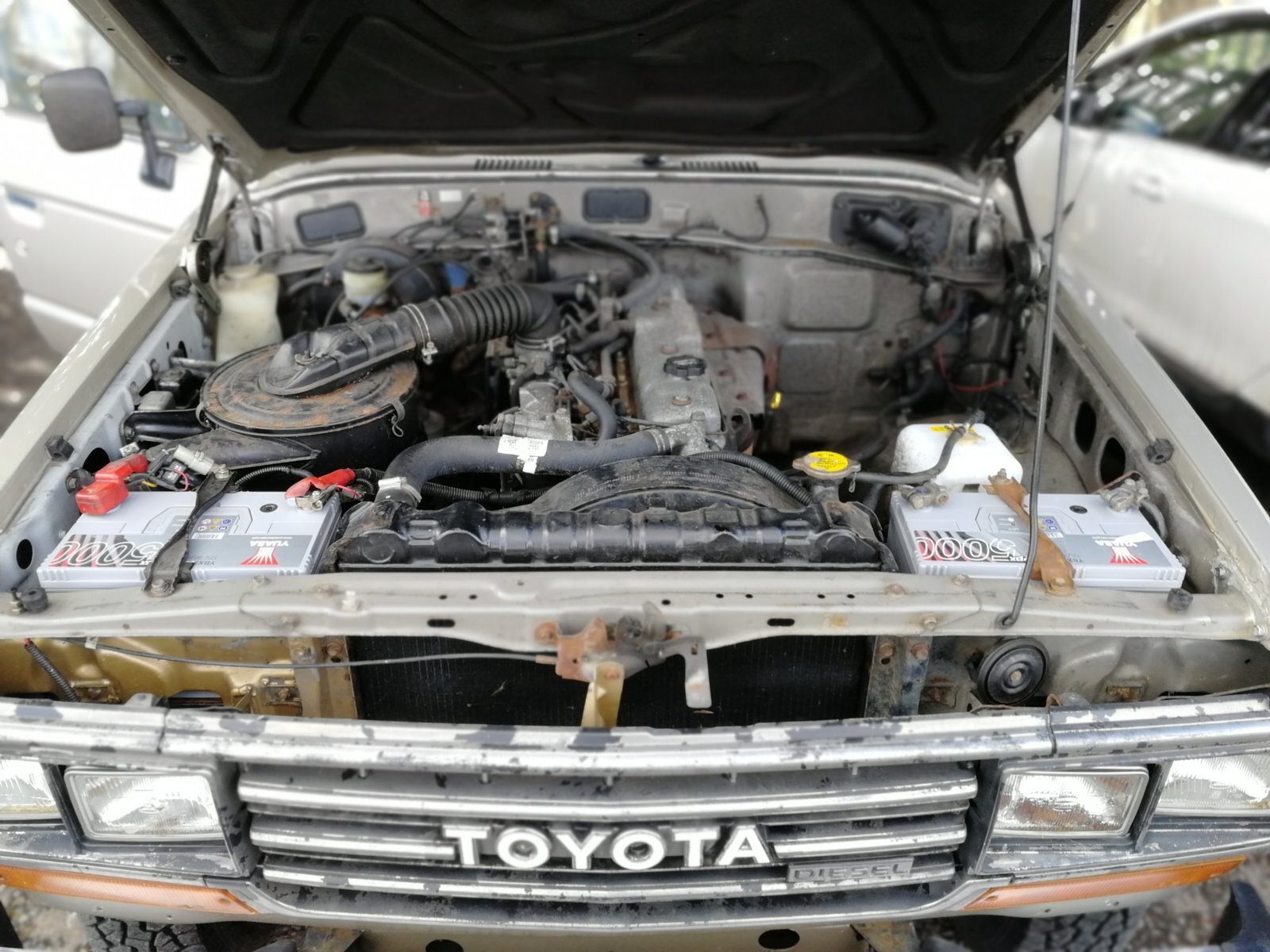

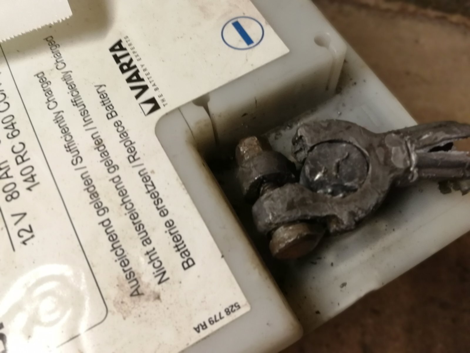

Bit of an update on my cold start issue then.
First I ditched on of the original batteries that:
  1. was giving 95CCA instead of the rated 640CCA.
  2. had arc'd between the terminal and the broken clamp
I replaced that battery with one I had kicking about, it improved the cranking but still wasn't very keen on starting. However those batteries were still below spec:
So decided to fork out on two new batteries:
Unfortunately the new batteries did not cure the cold start issue, although the truck now seems keener to fire up on part warm condition, i.e after 9 hours of being parked up outside.
So next stage is now to investigate the glow plugs as suggested above, starting to a continuity test as recommended by Andy (mate, nice talking to you BTW).
On the positive side, the two new battery are "electrically balanced" (if such term exists) in the sense that the voltage doesn't seem to fluctuate between the two as it used to be the case previously.

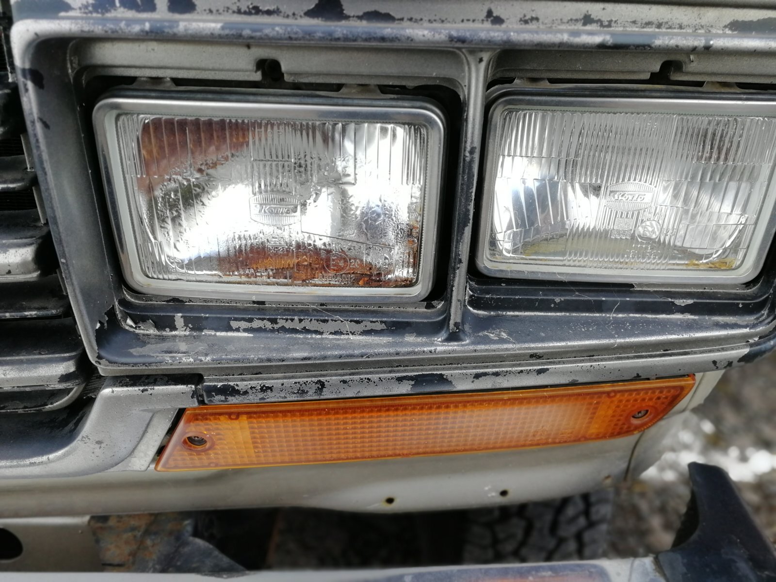

Once I have gone to the bottom of starting issue, those are the bits I will be tackling:

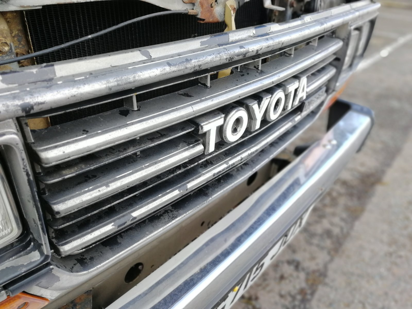

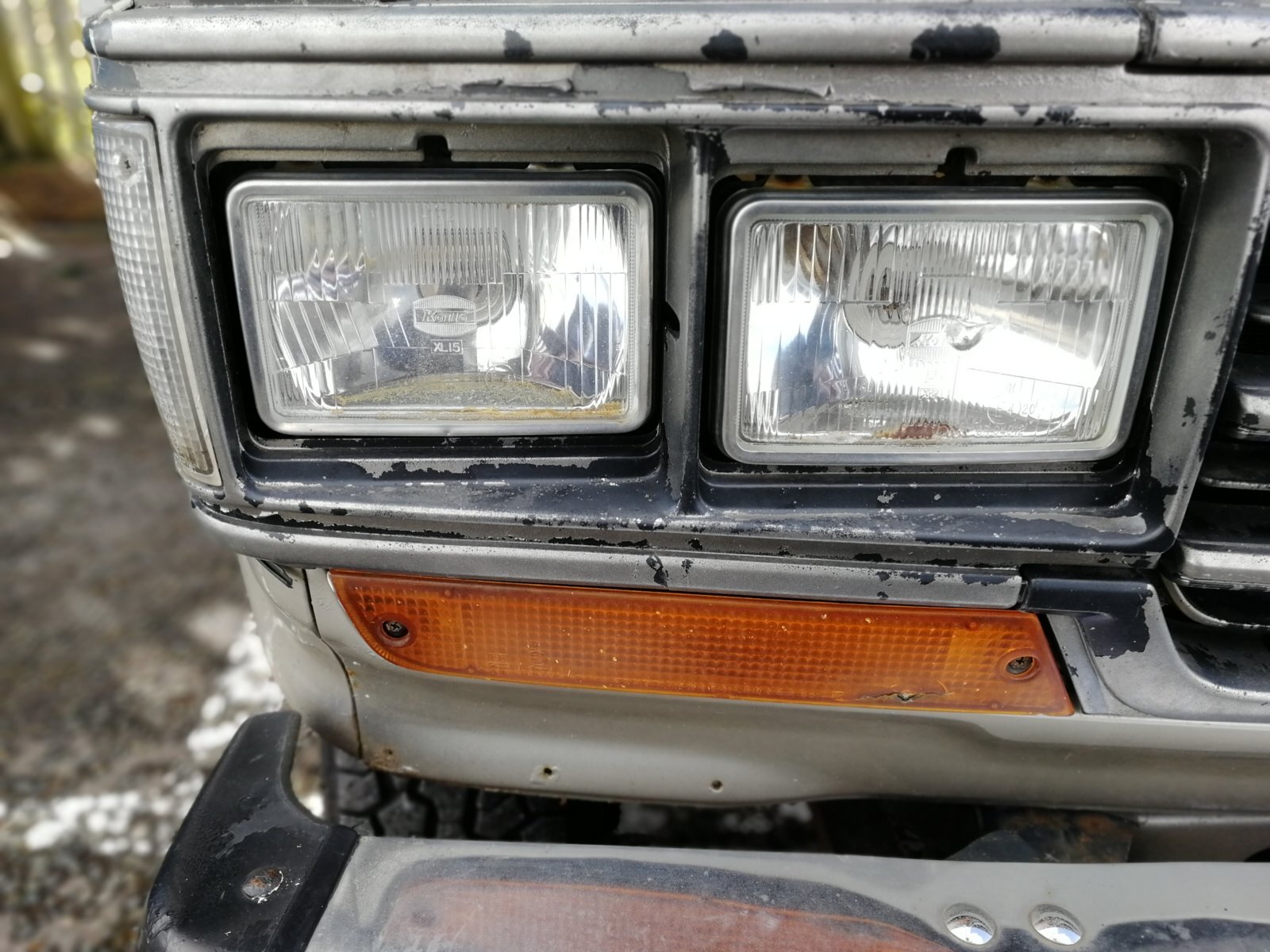

Questionable painting job on the front grille - I will attempt to bring it back to the original grey plastic appearance:
Replace the headlights units - any going for sale on here?

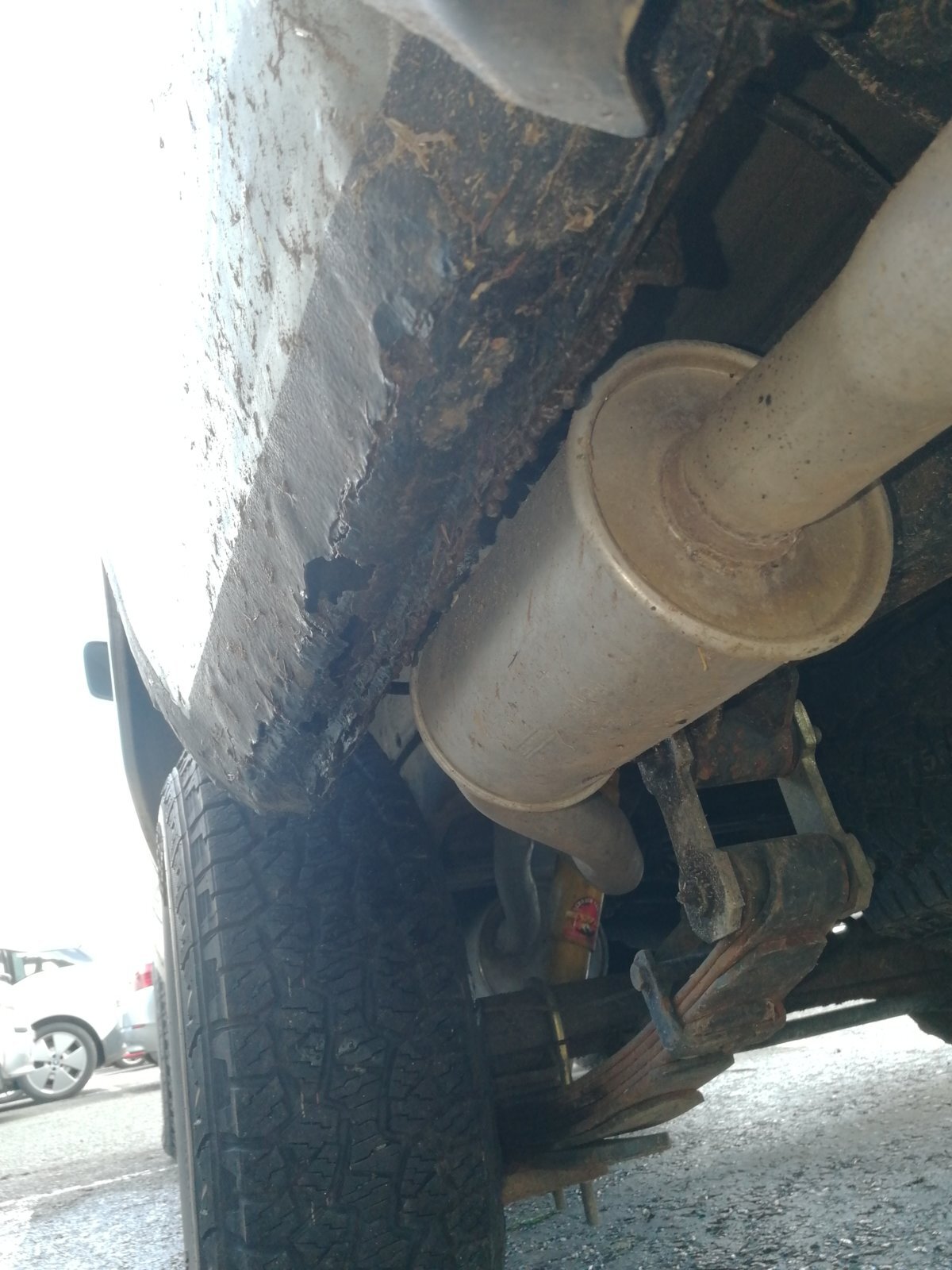

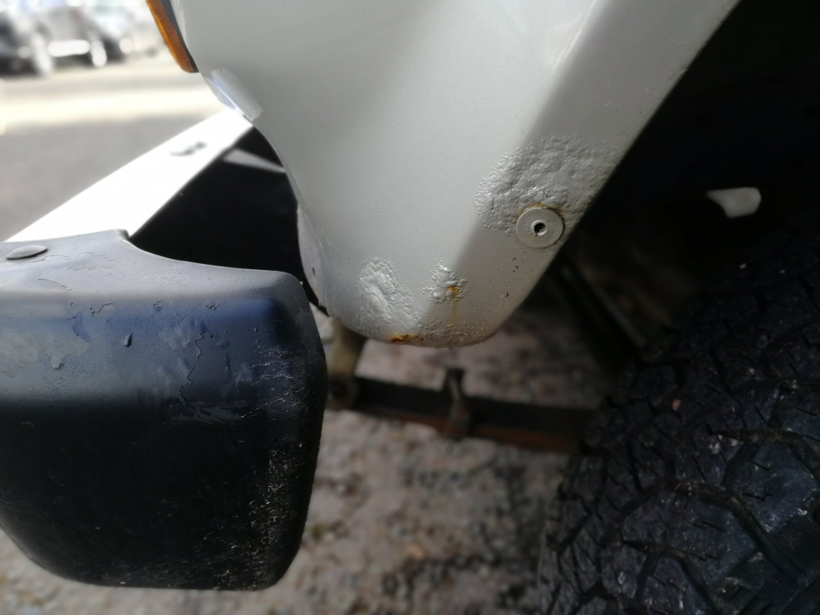

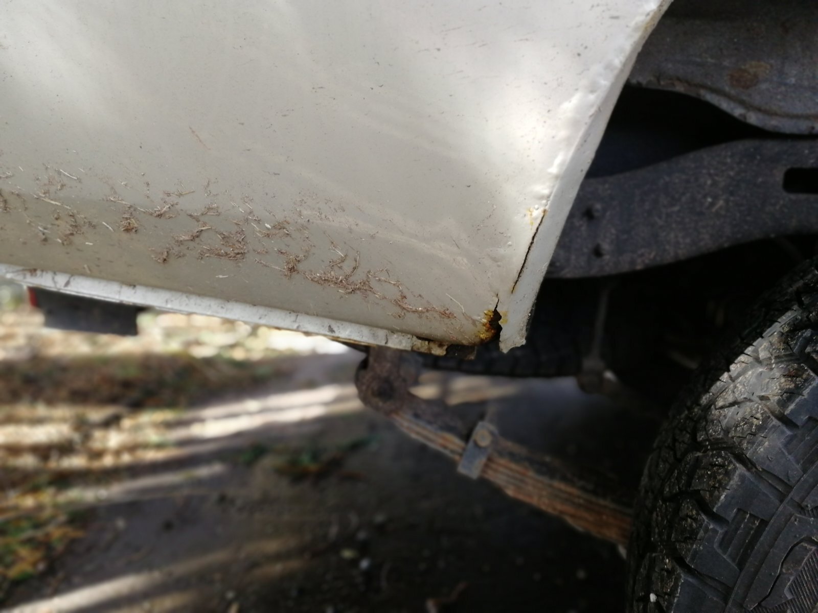

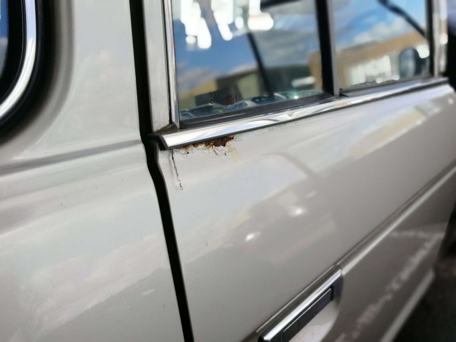

Sort out the rust, mainly the rear arches:

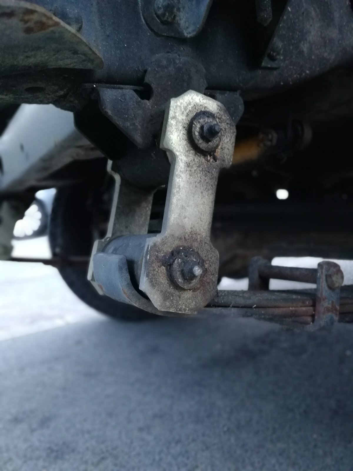

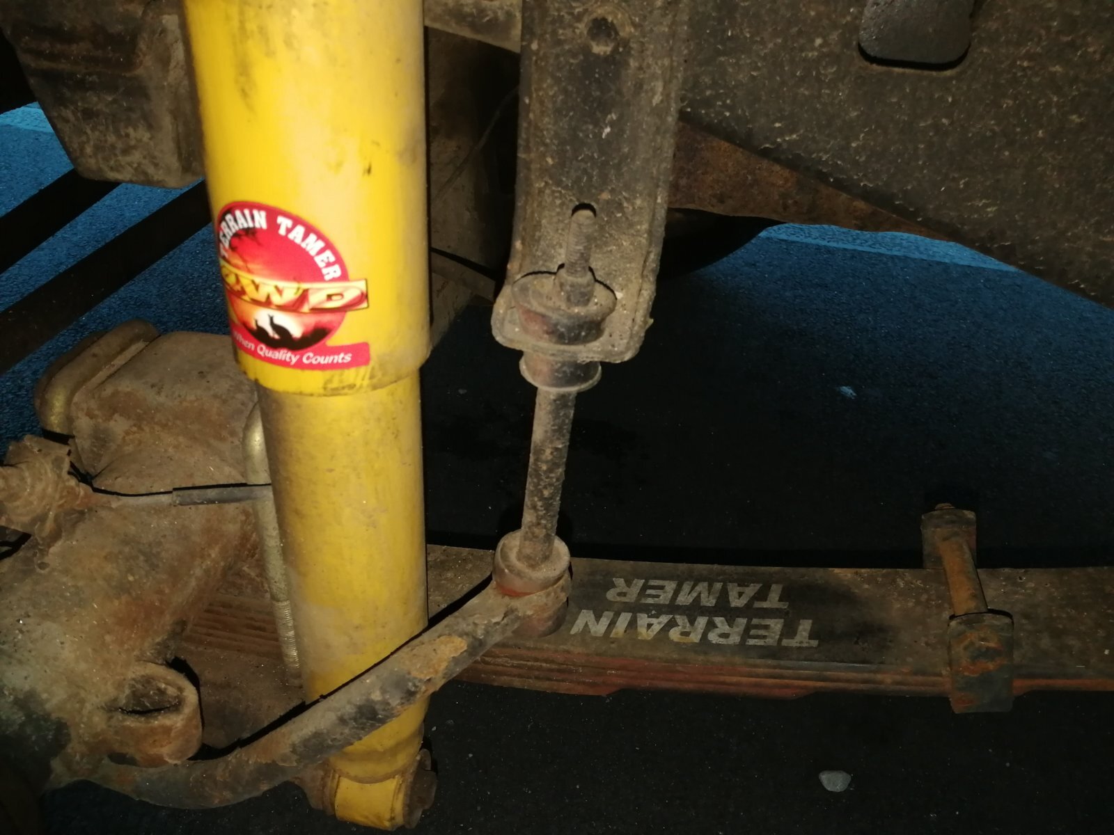

Hi Nick, my how it has deteriorated since I had it. I did have my suspicions when I bought it way back when but was in decent shape when I sold it 3-4 years ago.
It shows what salt and water do to bodywork.
Possibly it has the same springs on as when I sold it?? maybe.
Overall it is not too bad for a nearly 30 year old Japanese car, and I understand those 60-series like to rust.
I have been around the whole body work with a magnet and there doesn't appear to be any filler bodged job. I am keeping my fingers firmly crossed as I am tipping this!
The visible rust isn't too alarming, I think, and I should get those sorted professionally over the summer.
The springs are aftermarket Terrain Tamers, a bit bouncy but not back breaking.
Nick.
I think the terrain tamer springs are rated for +250kg front and rear @iwan_t24 had these i think?
