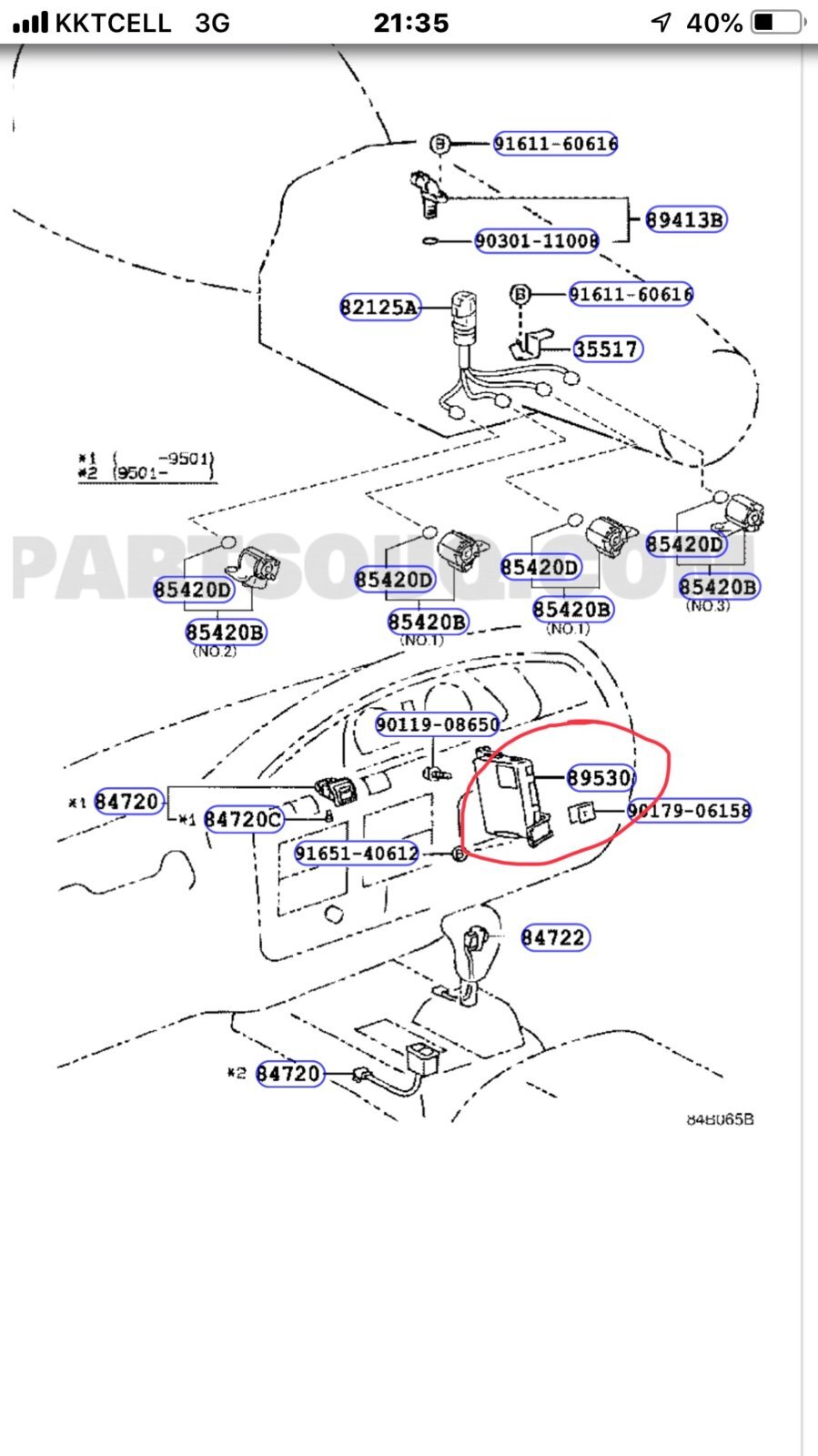

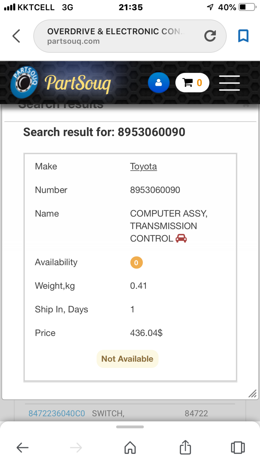

P.s i'm thinking could it be an electronic issue certainly need to investigate somehow.
Upon doing some research it seems there should be a electronic transmission unit in the dash that may be faulty so first port of call is to take this out and get it looked at. Fingers crossed this could be the fix :pray:
478104B6-6001-42A1-AED4-8FD9A2E84590.png CA624F6F-1DFF-4B80-BBE3-F3BF0C1F1851.jpeg
Not saying it couldn’t happen but I’ve not heard of a control unit failure. Torque converters do fail and heat in particular can kill them. IIRC there is also a lock-up solenoid.
