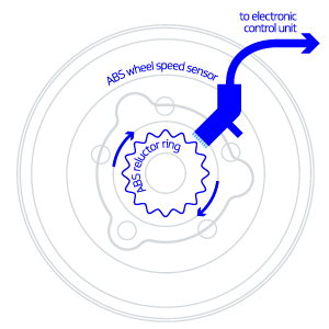

Most likely a wheel speed sensor not giving the right pulses. This could be because of a loose wheel bearing, or that the notched ring is full of rust or debris.
where are those rings located? easy to access?
