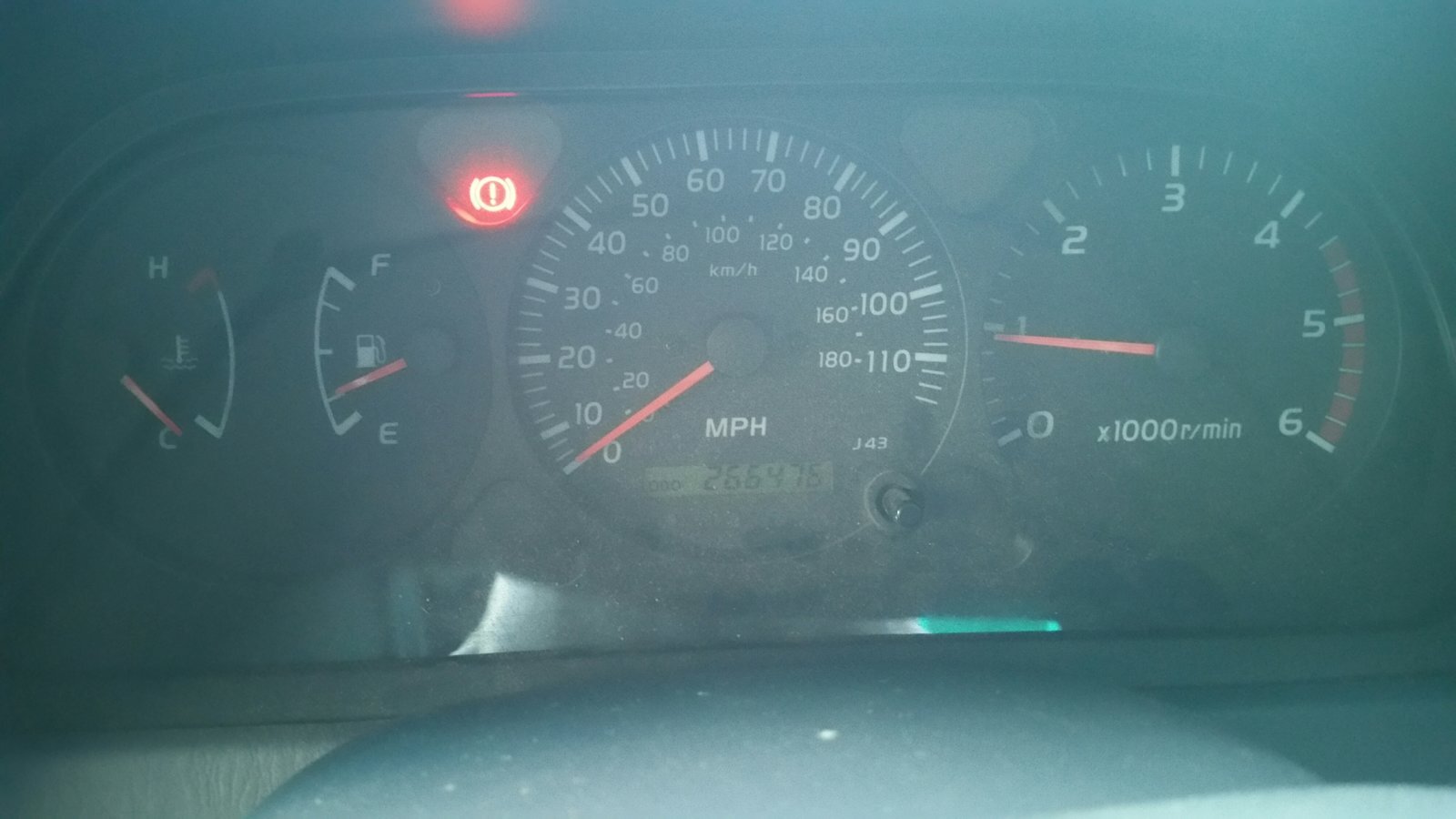

Hopefully someone far more knowledgeable than me can advise:
I have a 2001 KZJ95 Colorado (one of the very last of the 3.0TD engines), which has been in the family since 2002 (originally my wife's truck, now mine).
Sadly, my local Main Dealer isn't very friendly. This was originally a diplomat's truck in Islamabad, bought direct from Japan & to UK Colorado (not Prado) spec., hence they don't believe it exists... frustrating.
The horn began playing up & airbag light coming on. I've stripped the column & found the clock spring internals are knackered.
The problem is, I can't find a part number to cross reference for the Clock Spring unit - can anyone help or is there a recommended supplier that won't break the bank?

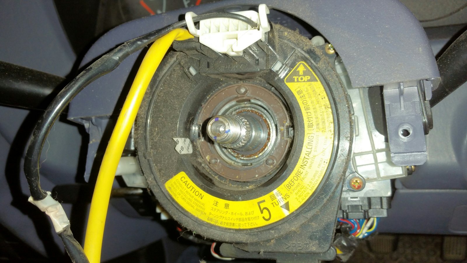

Having already dropped off the lower steering column shroud earlier in the day, I confirmed that I'd left the wheel in the straight ahead position & prised off the cover plates on either side of the steering whee. Then I unscrewed the (#30) torx screws (1 on either side which unscrew to a limiting clip - you can see them on the left and right of the wheel, poking through the black clips & ali tabs).
Some gentle(ish) pulling & a squeeze of the clips inside the covers saw the airbag clear the wheel. 2 connectors later & it was put to one side. No "Kaboom" here!:thumbup:
Having undone the centre nut on the wheel, I left it about 3 turns on & pulled the wheel sharply up. doing it this way meant that I didn't get a face full of steering wheel as it came free. Remembering to mark both the steering wheel and the shaft for ease of positioning on reassembly, off came the wheel.
In the top of the 'squib', the yellow connector & cable is Airbag related while the black cable/white connector is the horn wire. 4 screws retain the squib to the steering column (roughly set at 7,11,1 and 5 on a clock face); don't forget to unclip the lower cables (the airbag connector is held by a second retainer over the top of the std one, whilst the horn (now white with red tracer) wire has a standard connector.
The next bit is important to remember... there is an alignment triangle in the 5 o'clock position on inner and outer parts of the squib. keep this lined up as the ribbon cable inside the unit is at the 'neutral' position here (if you are tearing into the innards, follow the instructions on the yellow information tab to reset the centre position). there is also a brown ring on the steering column which locates the inner part of the squib for turning. Do not disturb it's position (the pic below shows the inner ring and the position of the 2 RH mounting screws).
Having tested for continuity across all relevant circuits, there was none & squib felt both very sloppy and 'graunchy' when turning the inner section, so I figured opening it up might tell me something...

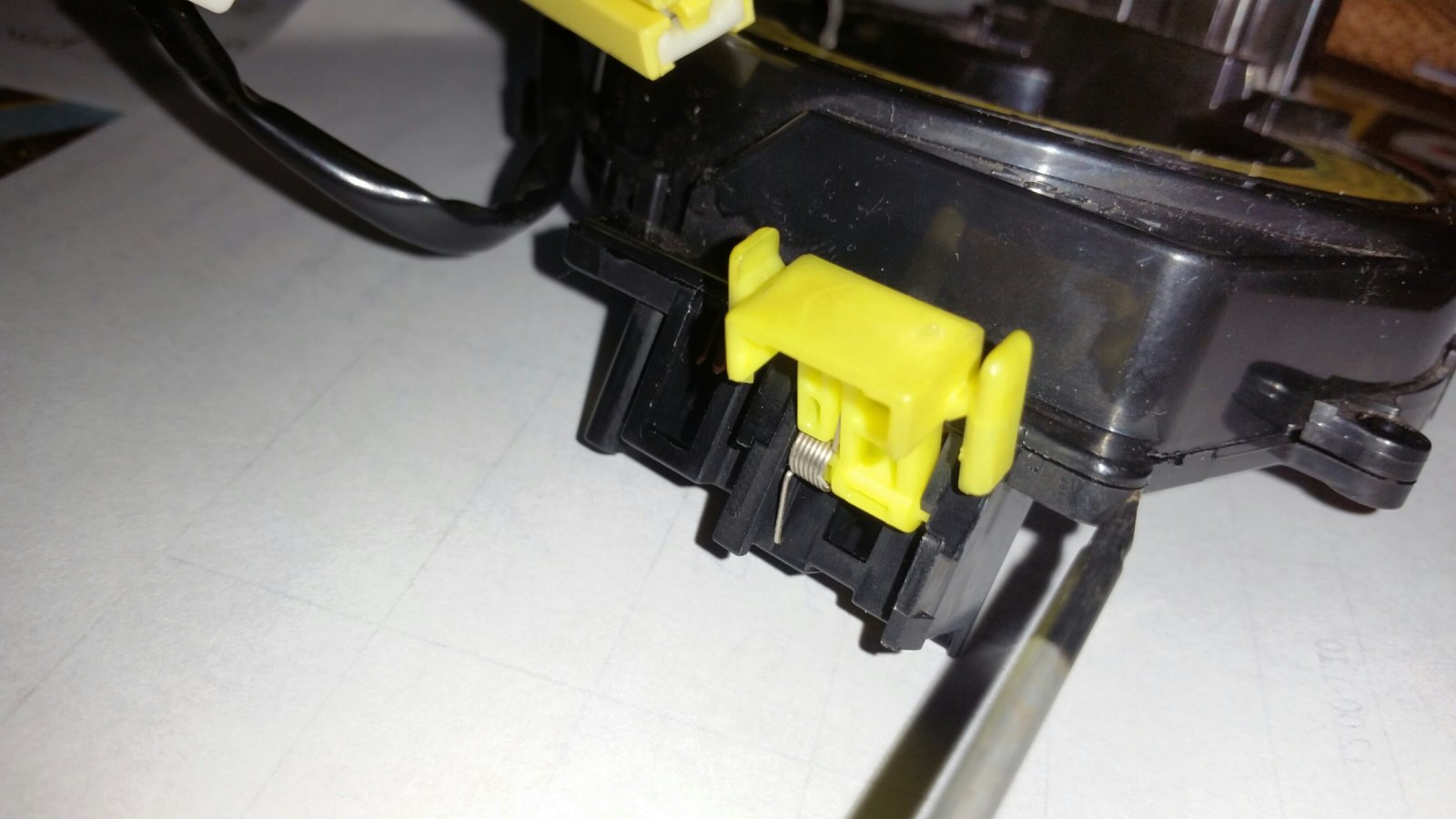

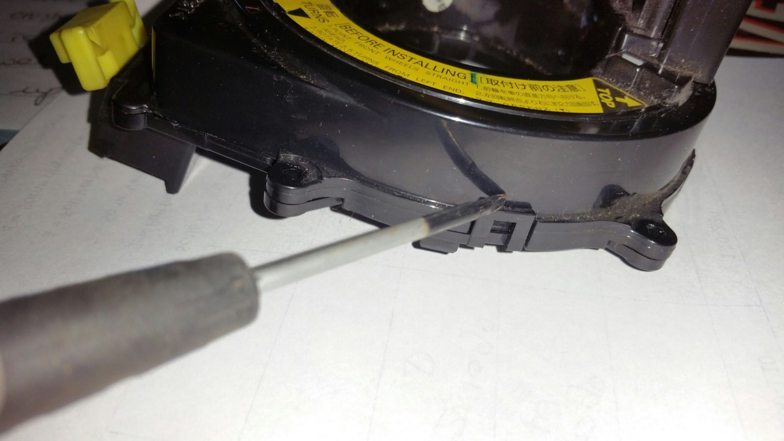

There are clips spaced around the lower edge of the unit which prise loose using a 3mm wide screwdriver tip.
The lower section (where the terminals are) has a moulding ending in 2 retaining pins which may or may not prise out cleanly. On mine, one came clear and the other broke off, while I stabbed myself in the thumb with the screwdriver. :sob:Ouch!
Breaking either of these pins isn't a major issue as the clips and the screw mountings around the outside of the unit are close enough to hold everything together on reassembly.
Opening the squib up revealed major scoring /gouging to the plastic bearing surface of the lower spacing plate.
Unfortunately, I couldn't get continuity between any of the relevant pins across the cable, so it would have to go back together temporarily until I can source a replacement.

My airbag light has started to come on permanently.
Having diagnosed the fault using the blink test to code 14= b0101 open in D squib circuit, I know that the fault is somewhere in the steering wheel.
I was glumly contemplating an expensive clock spring replacement... until I found this thread and ordered one for less than £10 from Euan's Ebay link! I don't know if it has worked yet but for less than a tenner I can take the chance.
