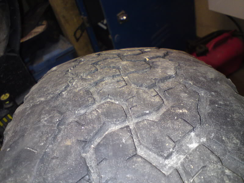

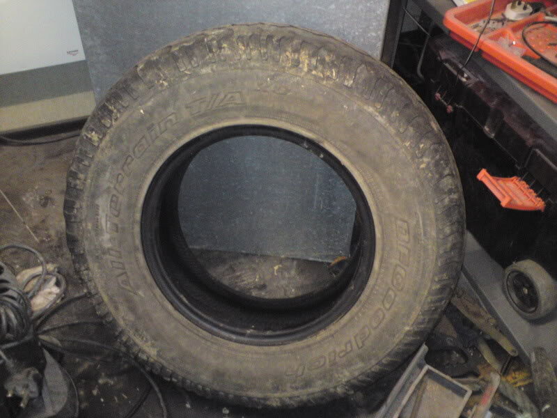

Graham
Mar 22, 2010
3,972
crap tyres & my bet balding??
I think so.
May be like these.
