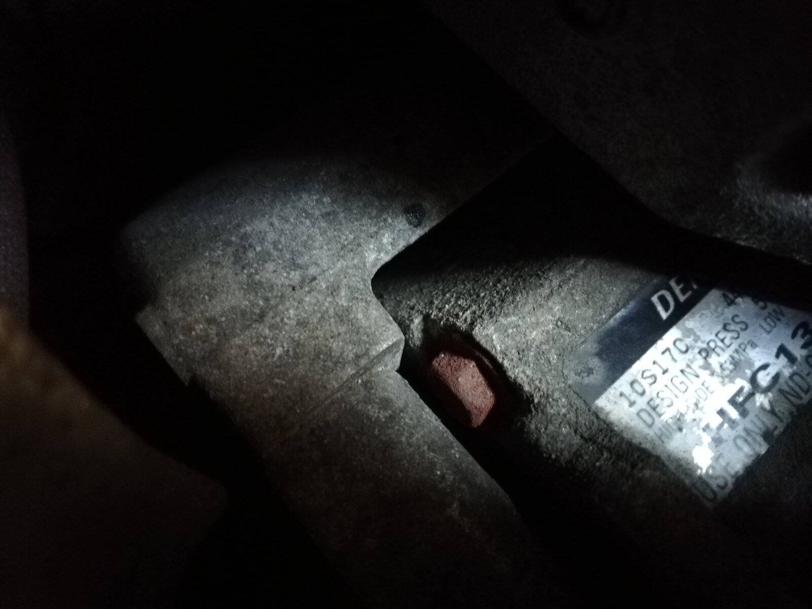

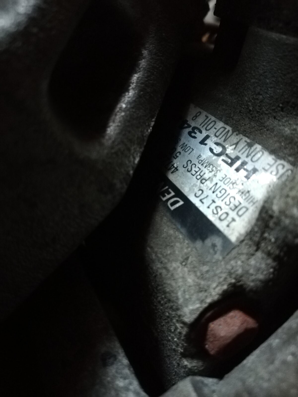

Did they do the vacuum automatic or did you have to ask for it and how much did they charge as last time I got a regas it cost me £60.
Well that's good to hear and it's hard to believe also. Some compressors with magnetic clutch can slip a ball bearing and needs to be disassembled you fell lucky. Good job.My compressor was seized on my 95. I had it regassed and the mechanic diagnosed a seized compressor. They used a full can off wd40 on it but it wouldn't work. Any way he told me to drive with the ac on as much as possible and keep squirting it with wd40.
Well low and behold 12 months later its now working a treat.
Yes this is a true story.
Been out in the car today and every time I switch on the AC I get a big smile on my face. Like winning the lottery.

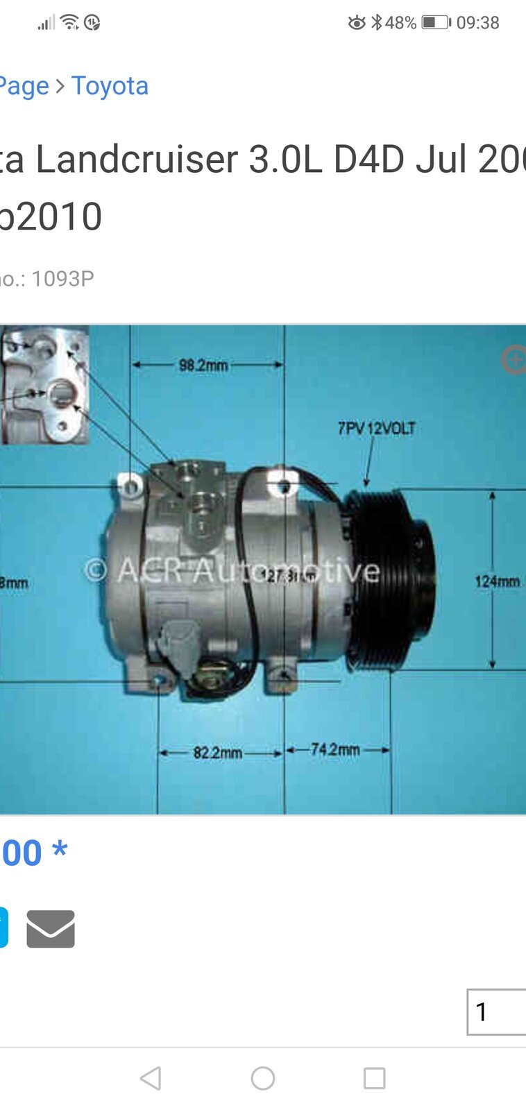

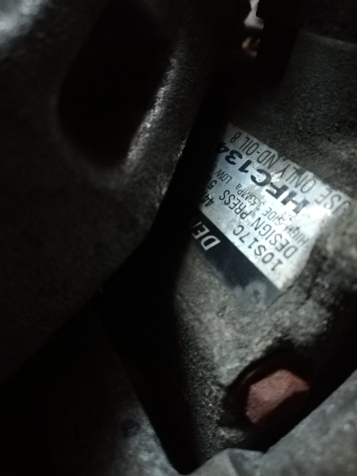

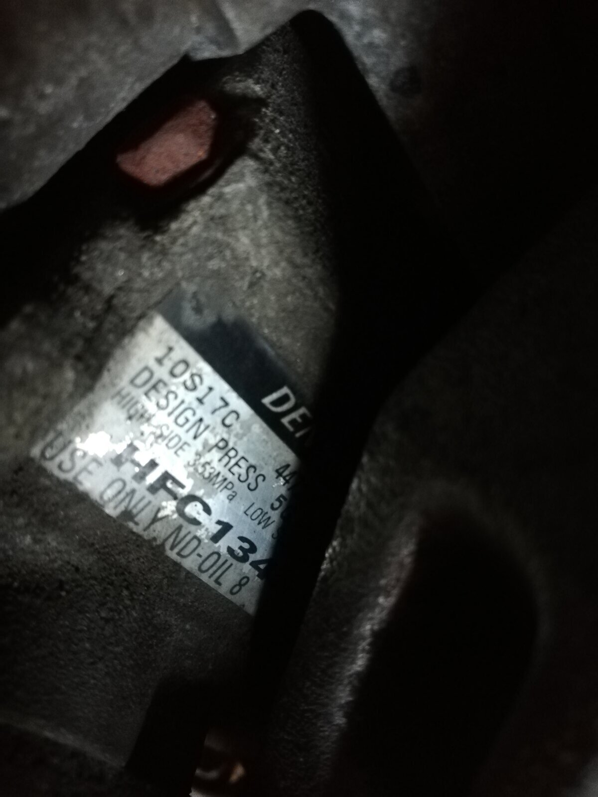

It was a pattern part I believe and was brand new in the box and yes was oiled up fully.did the new compressors contain pag oil?
