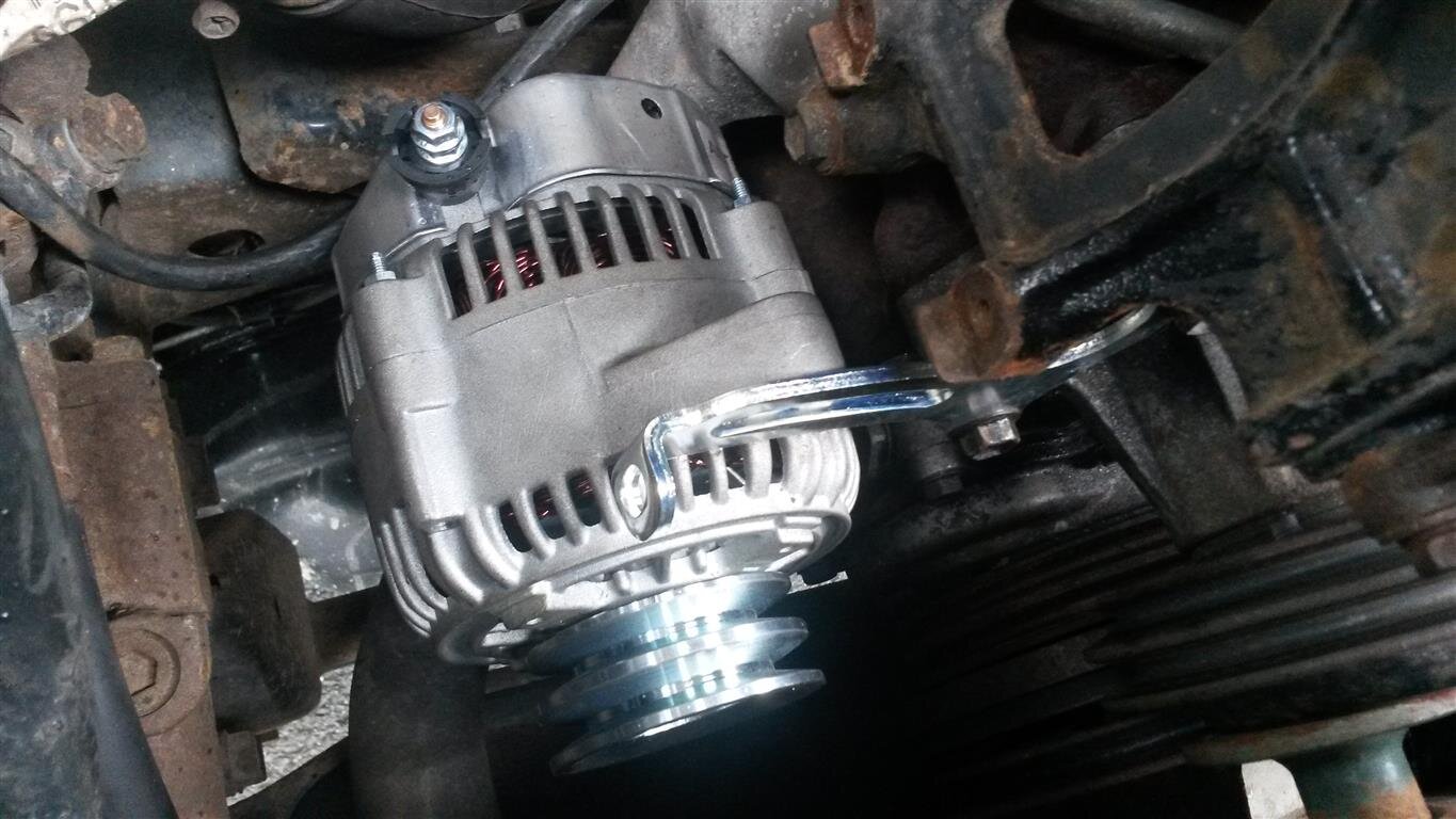

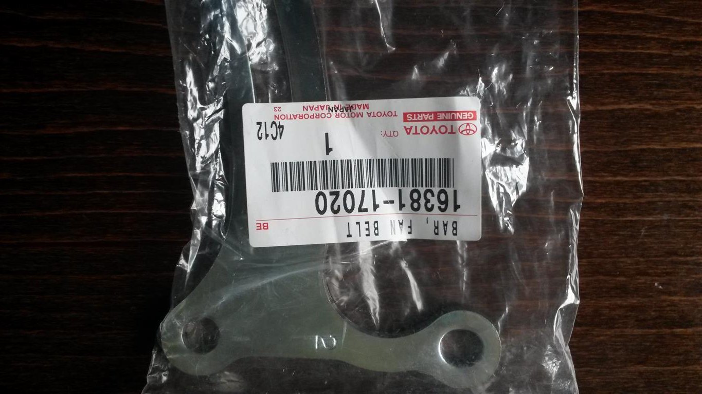

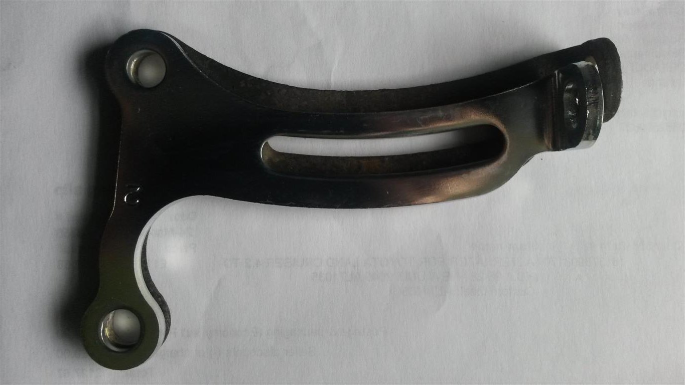

No problem fitting it. It is a bit fatter (being 120 amp rather than 80 amp) but went on without any modifications to the alternator. After reading on here about the adjuster bracket, I had a look on Toyodiy and saw that there are two brackets available for the 100 series depending on whether it's fitted with 80 or 120 amp alternator. Ordered the 120 amp bracket at 4pm yesterday and had it this morning. It was a perfect fit and in the end everything bolted straight up and not a grinder in sight!!
I also upgraded the cable from the alternator to the battery.
Pictures are...
1 - The adjuster bracket part number. Cost just over €9.00.
2 - New bracket sitting on top of old so difference very visible.
3 - Alternator and bracket fitted.
