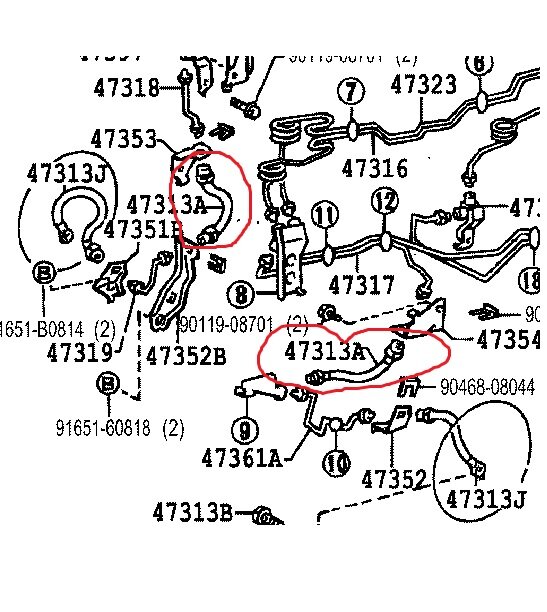

The ABS kit comes with seven hoses then noticed that in OZ they offer kits to suit 2" lift which got me thinking.
The pic in EPC for ABS show 2 front 'flex No1' hoses that seem to attach from hard lines down to the axle(there is also middle flex hose at rear).
I'm thinking the hoses to the calipers would be fine but did anybody extend these two hoses at the front and one at the rear?
Must admit I never even checked how stretched these hoses were after the lift as never knew they were there!
If it ever stops pissing down I will go and have a look. Dave.
I've done 2 x 2" lifts I didn't find it necessary to extend any hoses, but when I did the 2 x 4" lifts, I extended the front and back hoses. They were tight. And the breathers too, they kept pulling out. But for the 2" like I said it was fine.

Seen two pipes rip out on a supposed two inch lift, both on vehicles used in proper off road situations. Whilst I cannot confirm if the two inches was indeed that amount, it is odd that the problems occurred after doing a lot of driving involving putting the axle through some articulation.
It might be worth checking all the same, also seem to remember Toyota offering an 'extended brake line kit' that was also for two inch lifts.
regards
What do I know. I've only done two of these and off roaded them.
Yep, you need longer hoses.
Something you haven't mentioned that really is important even with a small lift, is to adjust your bump stops.
depends on the springs and shocks used to achieve the lift, 2" of lift doesn't always mean only 2" extra travel, but your standard off the shelf OME / Pedders etc 2" kit should be ok.

I have OME 850J springs (front) and OME 864 (rear) and I needed the extended brakelines. With heavy articulation the brake lines were really thight.

Right the problem is most people replace a three inch lift springs for example with three inch longer brake pipes, this is wrong. It is the shock absorber that limits the suspension travel and not the anti roll bar as many people think. although there is some tension. So if the shock absorbers was perhaps not matched to the springs for example a shock absorber set for a four inch lift, or perhaps perhaps different brands, then the brake pipe will often become strained. I would check overall suspension travel before ordering a new pair of pipes.
