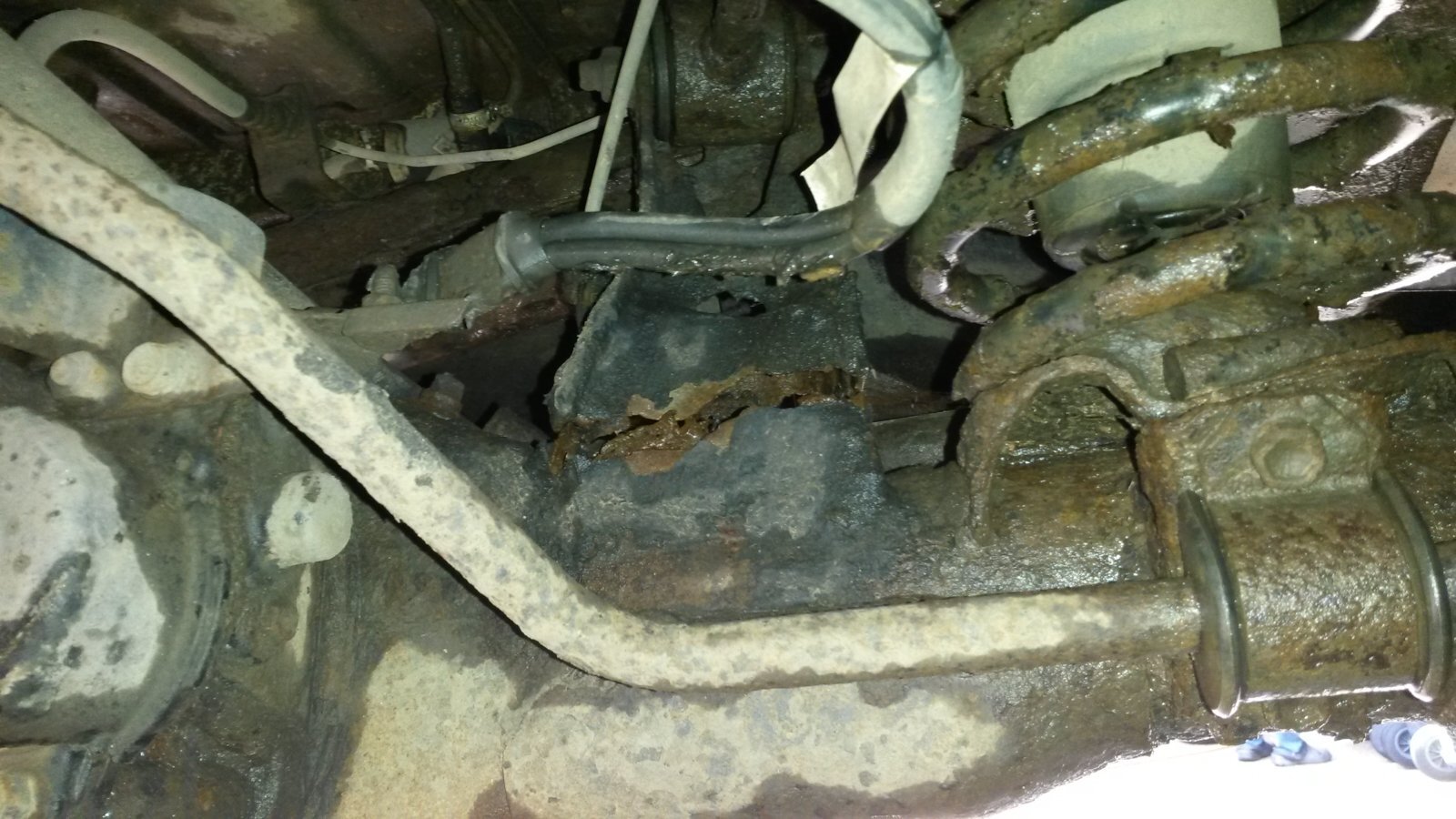

Having bought my second Collie a 1999 VX after a selling my last one in i 2008 i now find my rear diff/axle is in a bad state ie the hanger brackets have split in two has anyone repaired these brackets and if so i would really appreciate any advice or guidance. Shayne and others have advised me but i thought i would throw this out to the rest of you for any more advice or suggestions? thanks in advance ;-)
With both pics things don't look so bad , i think i would want to repair it with weld .
You should check the overall condition of the axle first. If you'll need to be doing more welding down the line then a new case might just be worth it... Once you can swap things over yourself and want to keep the truck long term that is...
However, I'm sure that can be welded up fine/reinforced a bit. Just need to find someone who knows what they're doing. Whilst you're at it, gets as much of that rust taken care of to prevent anything like that occurring again.

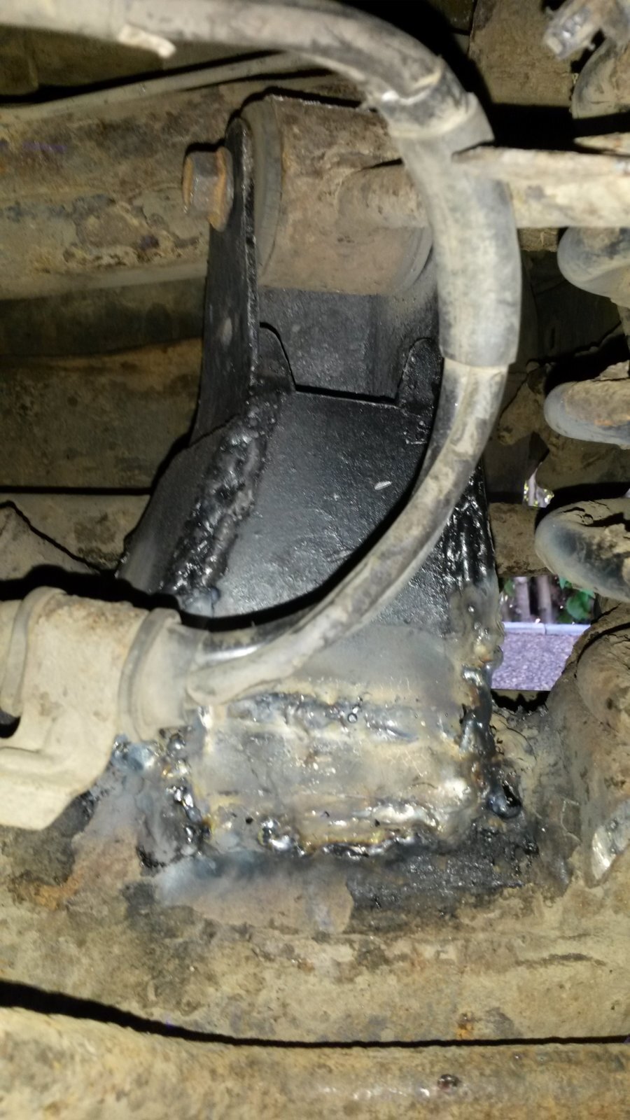

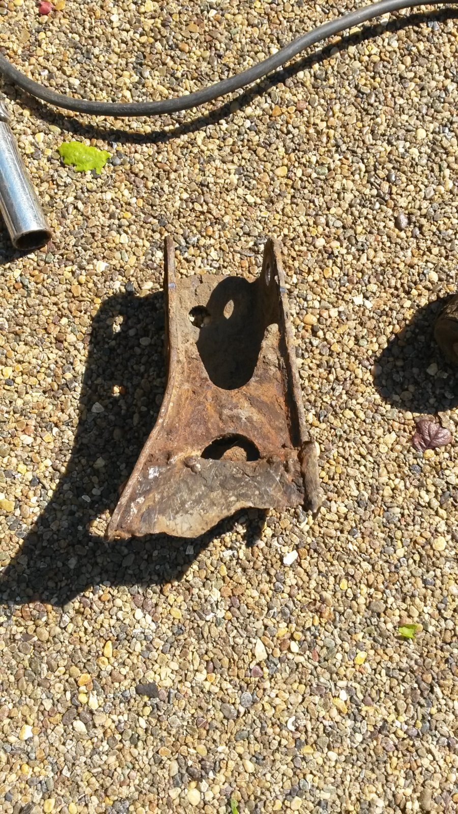

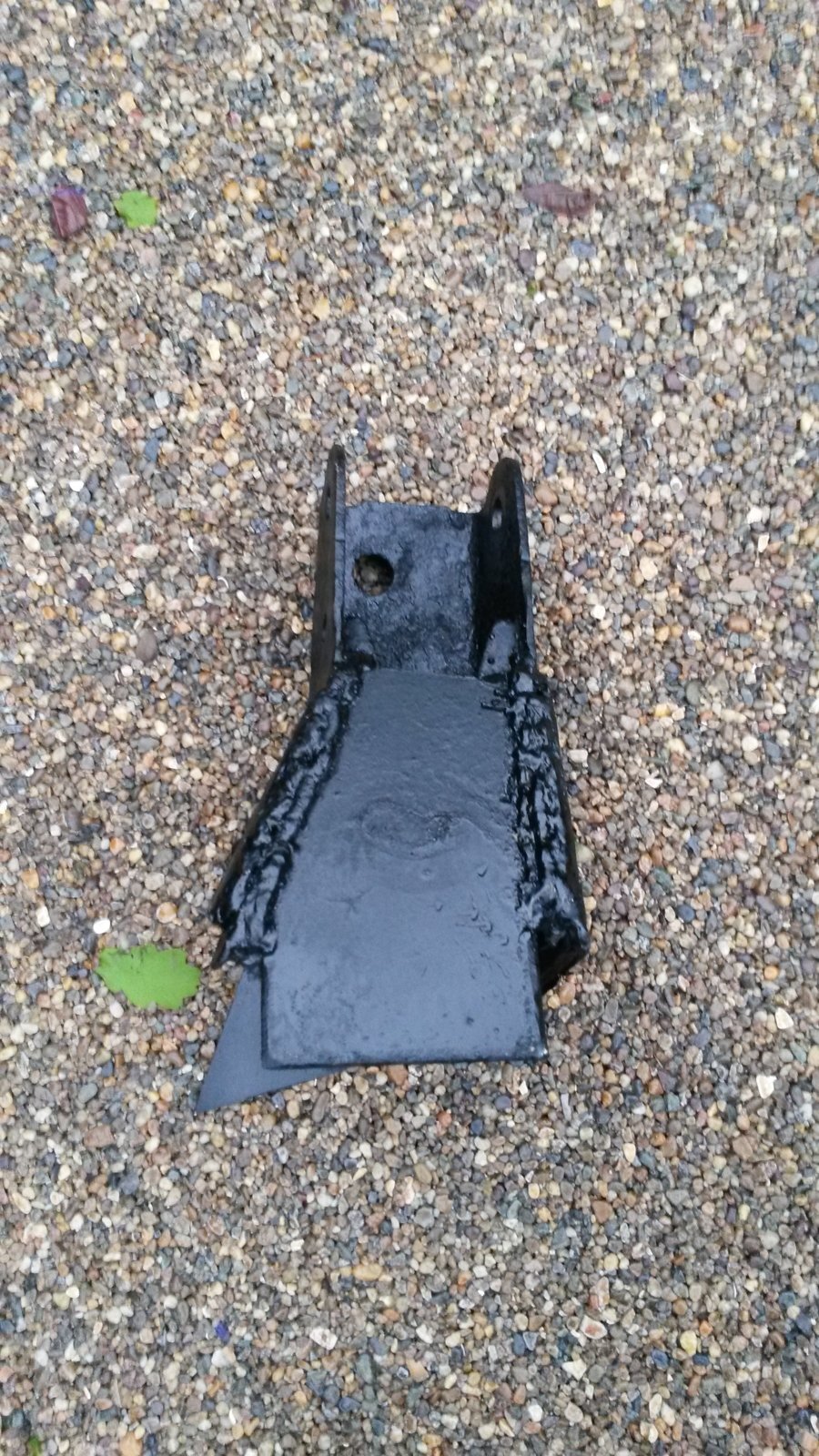

Well seems the mounting bracket was completely rotted off the axle and just floating in mid air :flushed: i removed and strengthened the bracket up with quarter galv steel from an Anchor i just had lying around scruffy i know but i can't see this breaking again :smirk:

As long as it's strong and welds onto the axle ok, it doesn't matter what it looks like.
good job :thumbup:
I would be more concerned about making it run straight and true than i would about strength . A horrible miserable comment but better thought about before than after :confusion-shrug:
Not really Shayne i welcome any comments or advice which i really appreciate :bow-yellow: the bracket looks a blooming mess as there are welds over welds i intend nipping up the tie bar and then positioning the bracket to the axle with as you say all straight and true then tack weld in place and the go from there :music-rockon:
Yep, that's the way, nobody likes to see or drive a crabbing vehicle.
Personally I would take as many measurements as you can, ideally center to centre of the mounting eyes, chassis to axle.
Are the eyes on the chassis secure or rotten to degree that they're moving?
If secure, as long as the new ones on the axle give you equal measurement each side, you should be OK.
It's all logical stuff, but very critical to a straight drive.

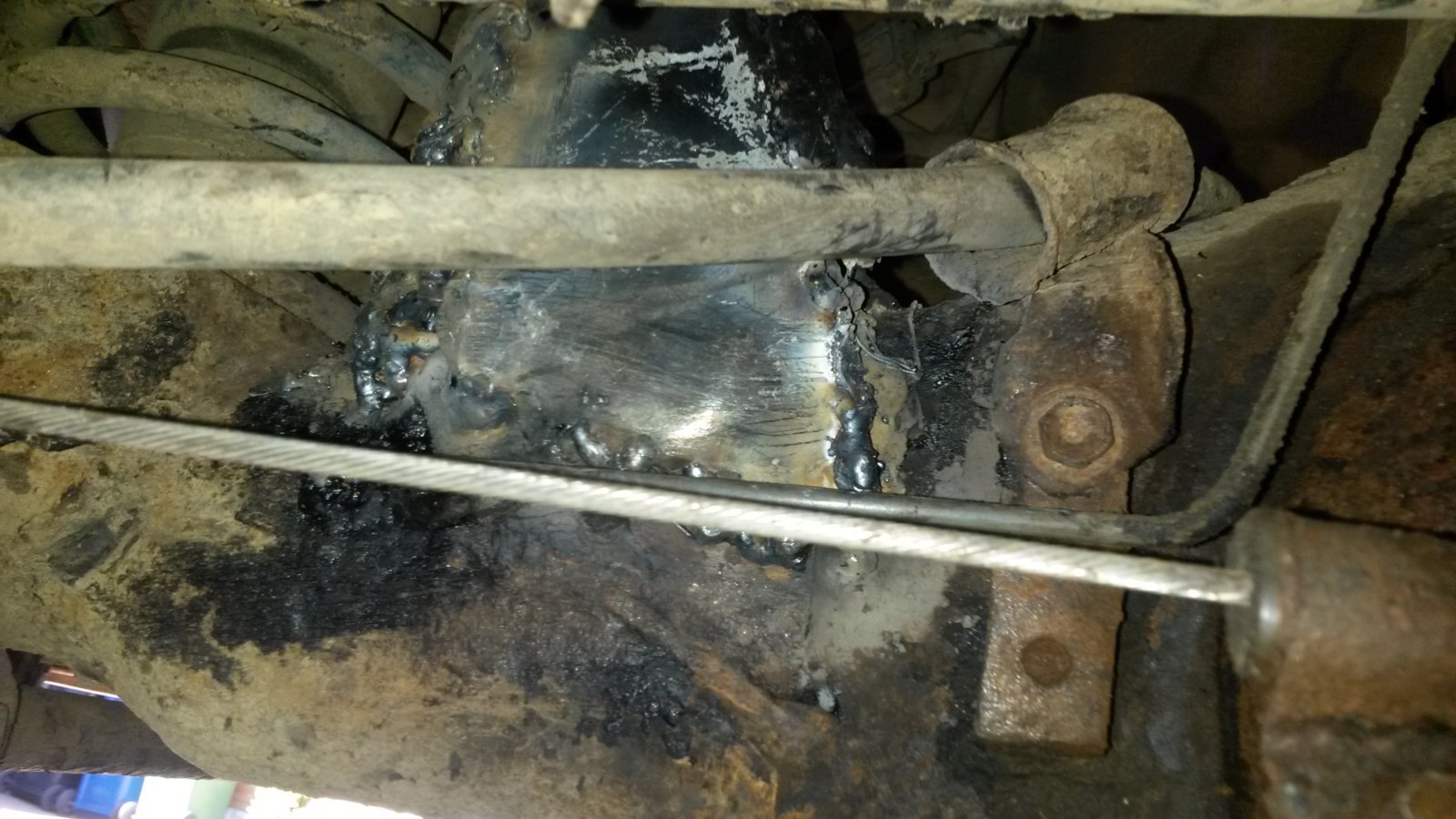

All done now a bit of a claggy mess but i think it should hold but i really do need a new/used axle pretty soon i think the eyes were all good thanks again all for you invaluable advice next job while i'm under there is to remove the rotten centre silencer and replace with a nice none restrictive through pipe :banana-wrench:

Good to see it back together.
I like the technical term "claggy" it means nothing, but there's no other word that fits quite so well. :lol:
My late best friend used to use the word Spurious to describe anything none factory he was a character :happy-jumpgreen:
