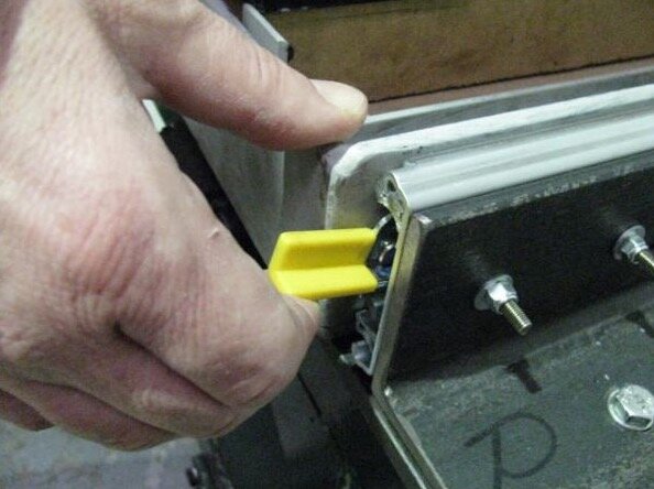

This would be the 10.1002.0800 I am guessing. But I can't see that in the lockable version. I can see one that holds the slide with a sort of spring clip at the far end of the slide but that's not what I want. That's not going to hold a fully laden fridge in place off road. It is specifically THIS that I am after.
If that's available then that might be the ticket. It's just not showing on the options tab. The sizes are VERY close on the 800 version for sure.
Once you have enough posts Jon you will be able to put links in. BTW I like the slide and tilt version. That could be very useful in a build like this.
Chris, that image is from a 76 x19mm profile slide, 227 kg load capacity. We don't have the 800mm version in our stocks as it's been superseded by the TR7619 LOC in our Thomas Regout range. The green lock is tested at 300kg to hold then fridge in and out and used on emergency vehicles, so it's equal to that in the image.
