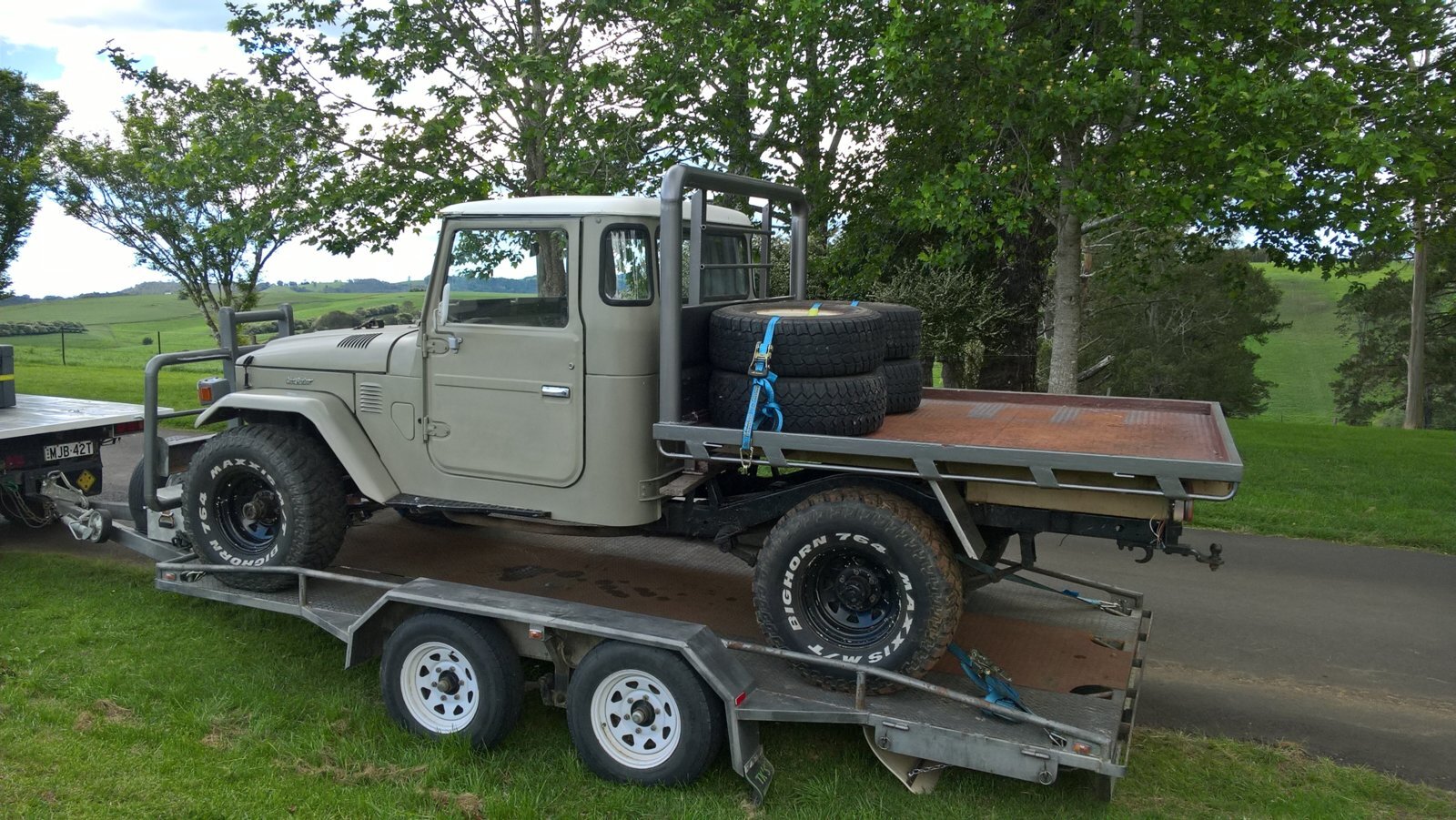

So after a bit of disorganised chaos, we got back to where the ute was.
Got it loaded up onto a mate's trailer:
We took some skinny tyres as I couldn't remember how wide it was.
Started to head back, but needed a comfort stop and a chance to check the straps:
Yes, it is a GQ Patrol towing it... the friend with the Toyotas wasn't around this weekend.
Got it home, up the driveway (much to the interest of the neighbours - leaving the utes idling in the road was a bit of an attention grabber):
