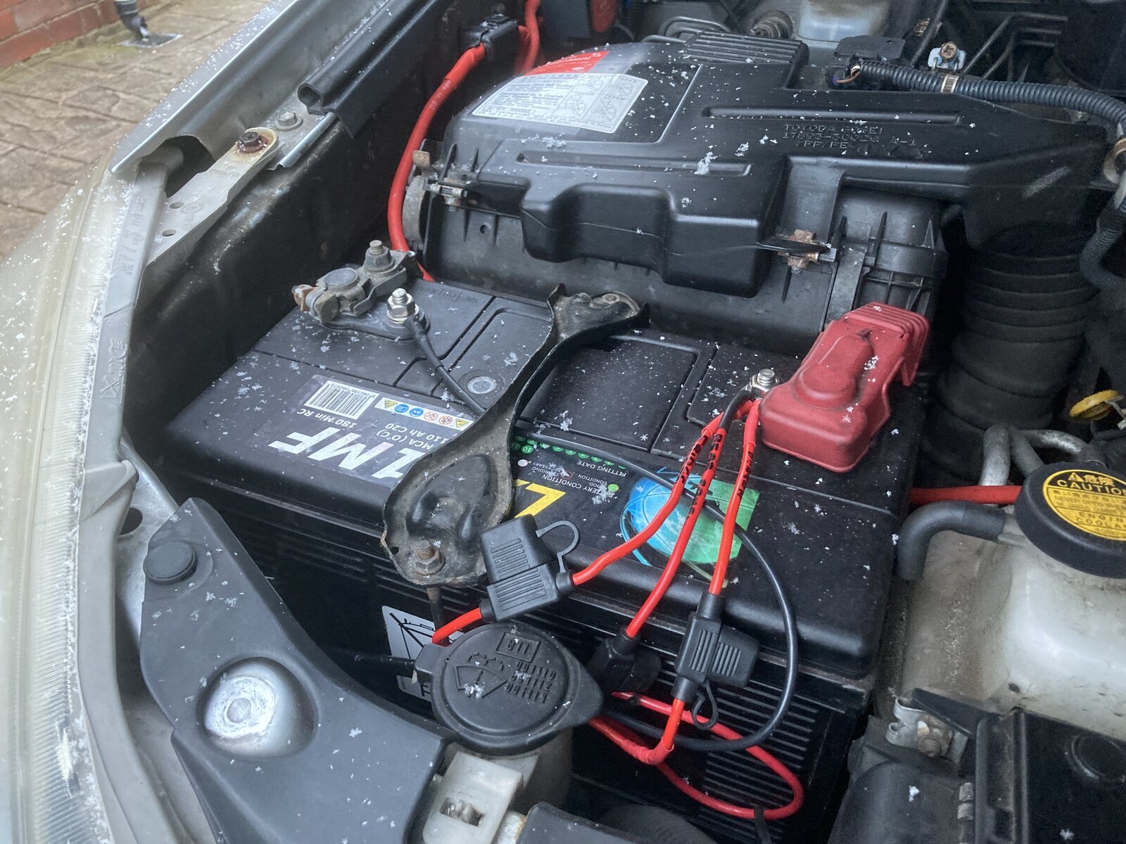

The other good thing about twin batts, is that whilst being careful to avoid shorting out (i use a thick glove on the loose pos lead) you can keep the vehicle live continually whilst swapping one battery out at a time, saves having to reset leccy windows etc.
Wildplaces, there is no radio code. I thought the same when I first got mine, and have disconnected both batteries several times since, with no problems, 2006 lc3. Electric windows a simple reset.

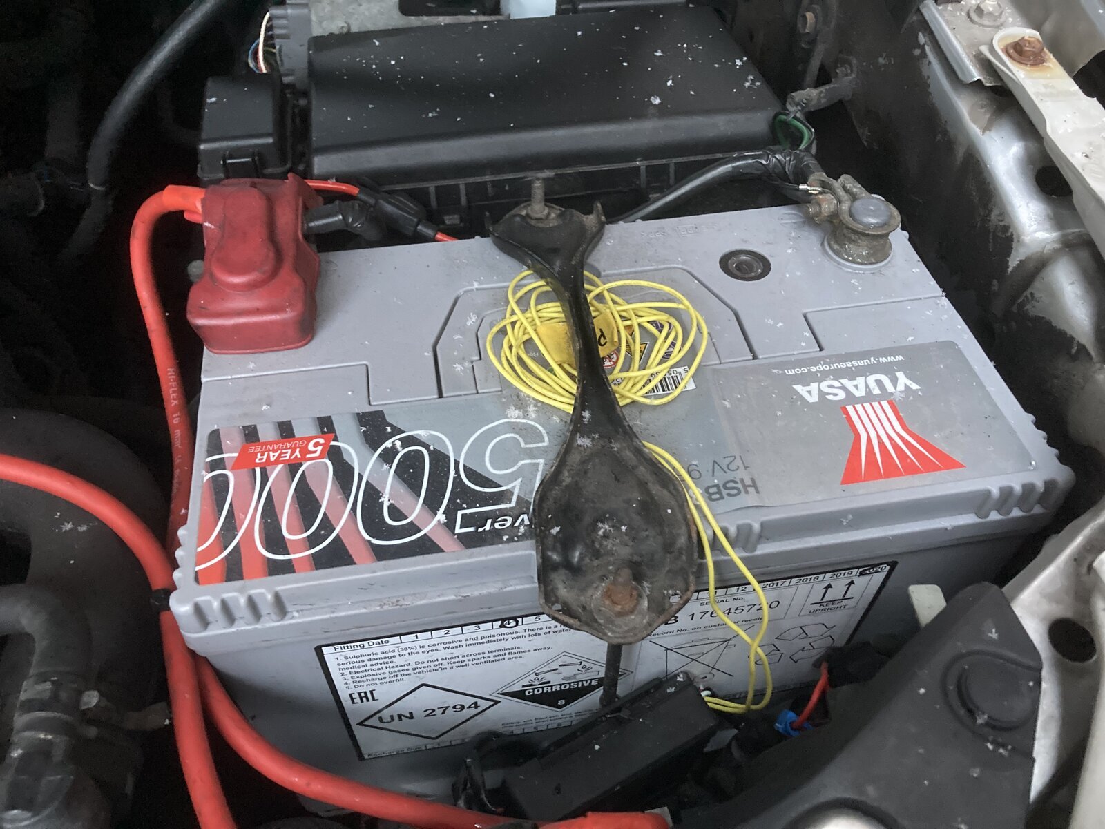

My first set of OE batteries lasted 10 years. The replacement from MrT are now 5+ years in and seem to be holding ok.
Replacement ( yuasa ) are 650cca each. I believe the original were 700cca.
£160 for the pair, 10 min to replace them in the parking lot myself. And the parts counter was happy to take my old set back for disposal.
This was a few years ago, but I couldn't at the time find anything at the same quality/price range. Battery megastore came close with some wierd unheard of (to me..) brand. MrTs yuasa definitely worked out for me.
