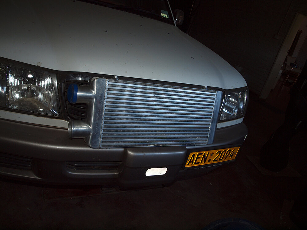

I'm just about to fit an intercooler from eBay to my 100 it's quite big. 70x30x7cm. The guy's here in Zim didn't think it was too big and should fit behind the grille with a bit of modification on the slam panel support.
It didn't have one as standard.
Guru that looks very industrial friggin yoooge having read somewhere some suppliers paint them black to be more efficient when ambient temp is hot has anybody noticed any difference between the painted or natural ally in performance thankyou for all your replies ta steve
I know it's massive... but it fits:):):). I'll update once it is fitted and the engine retuned.
Hahaha the guy's here in Zim were wrong... It's too big.
Physically it's too big it fouls on the top of the winch. And he also said I would probably end up with engine temp problems because it covered so much (almost all) of the radiator.

Already sold it to a local boy racer. His eyes nearly popped out of his head when he saw it in the work shop. Got my money back so I'm happy enough.
