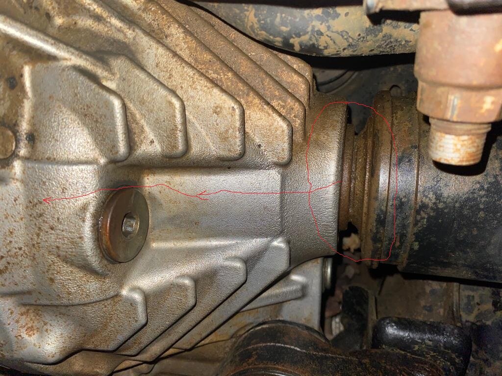

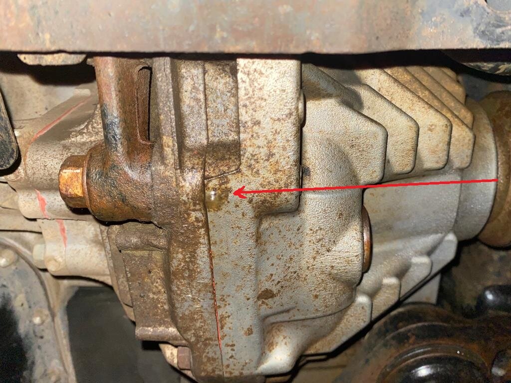

Oil coming in past the grease in the drive shaft?
KB, not sure if its from the grease. it appears to be coming out of the ring connecting to the left from diff box as marked in pic.

That looks like gear oil Raj, and if it is tracking back from that "ring" that'll be your diff output shaft seal blown.
If it's overfilled it might stop leaking when drained to the correct level.
If it is overfilled pressure probably pushed it past a good seal so i'd just refill to the correct level adding transmission leak stop .

haha unknowingly, whenever I went under and found grease or oil, I smeared it at all places. :) It's just a slight drip only when I drive the car so hopefully, it's a minor and self-healing one with the correct level of oil.

Today went to that garage and told the story. They blamed on the mechanic working on that day and loosened the drain and fill plugs. They have ramps so lifted the car high and hung on it so it came out loose. one good news there, my job is done without talking much. I will change the oil myself now with the correct washers and oil types/levels.

Changed front diff oil, new fill and drain plug and washer and drove back home and checked for leak. Its leaking, its the seal thats leaking.

You're probably looking for something like 'front drive shaft removal and refitting' for the procedure. With the drive shaft out, you can change the seal. I don't know if 200 series FSM are freely available like the older models?

Check the front diff breather isn't blocked. When breathers become blocked, it will often force oil past those seals as heat expands everything.
