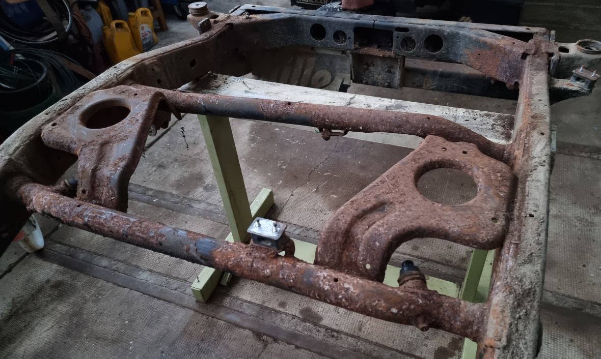

In the attachement you will find a picture from a rusty, very bad chassis, where it is the only way of disassembling the body and all other parts!
In Austria or Germany you have to estimate EUR 4-5k for a professional treatment without disassembling... The basic cleaning will be done with dry ice cleaning/ice jetting.
