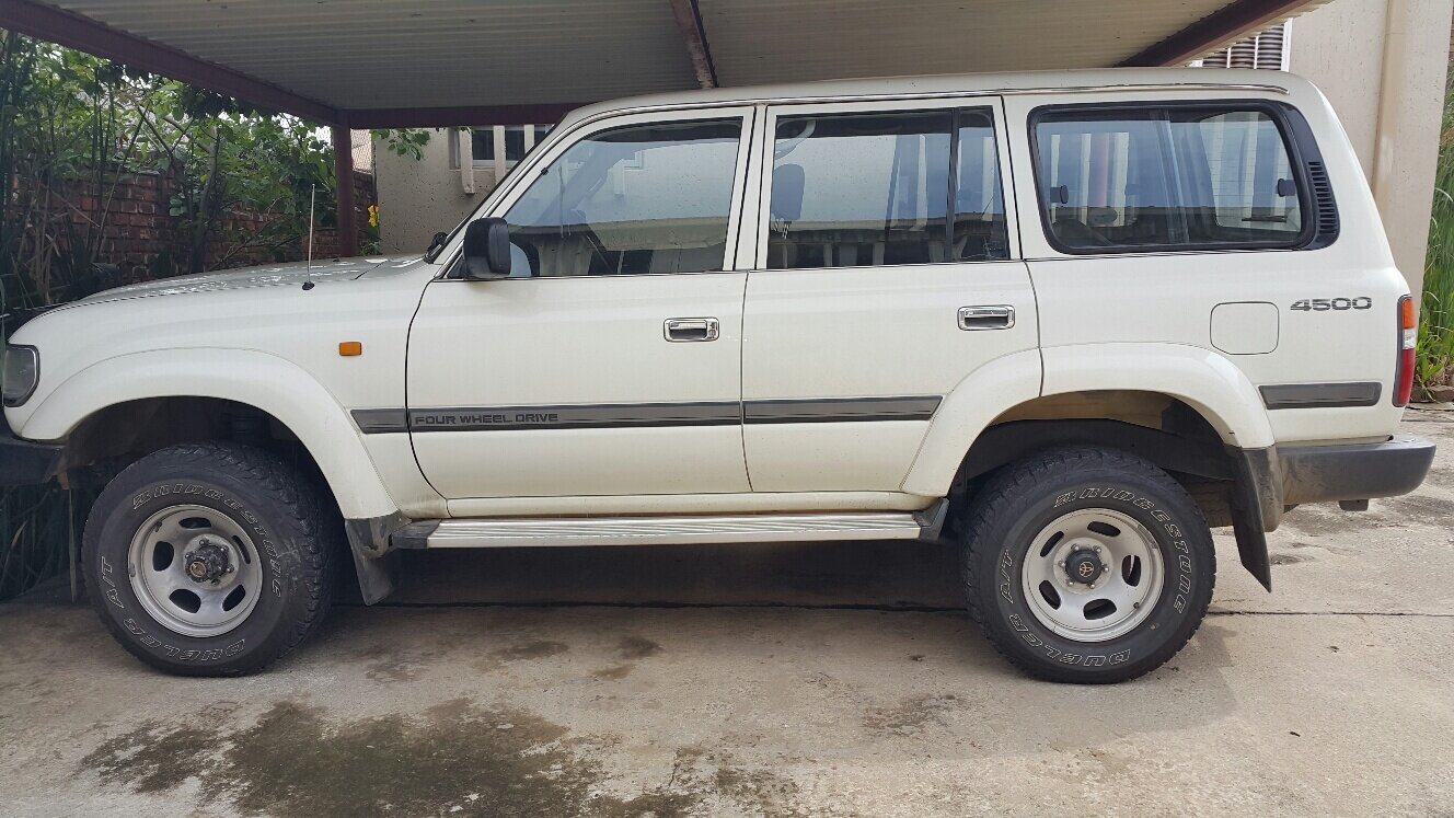

Does this look ( pic) like just a 50mm lift ? ( pic to follow)
What to do ?
What to do ?
