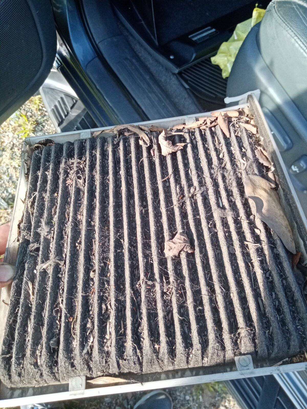

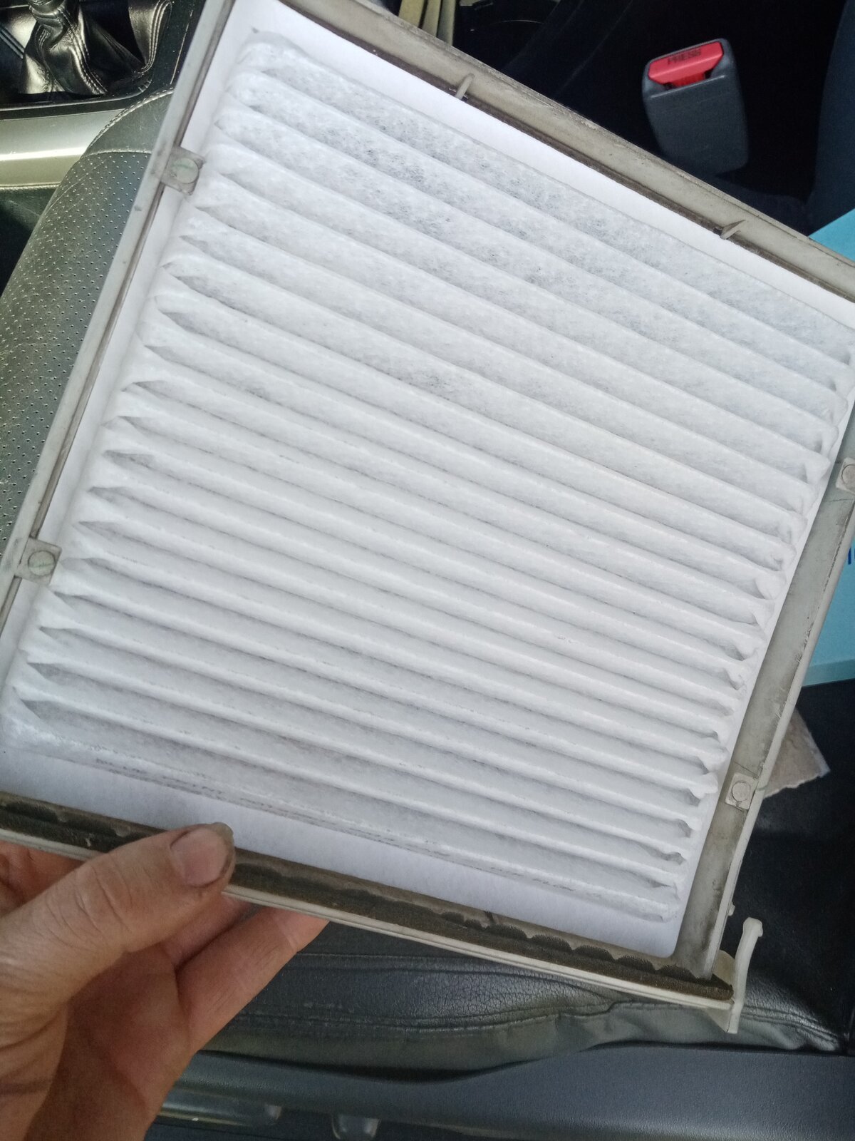

Changed that cabin filter was a easy job for me. Not sure why the last man never done it was bogged up.

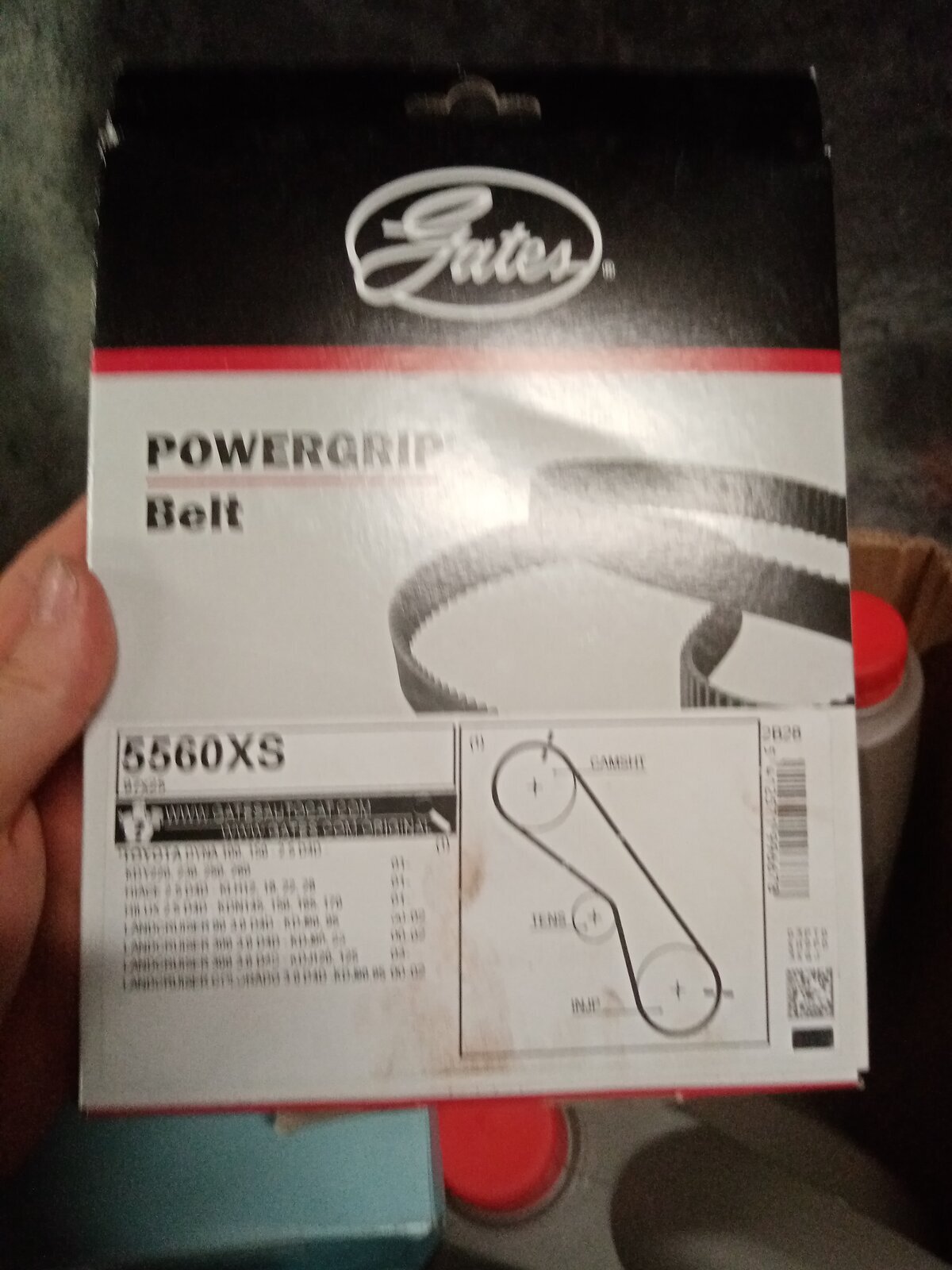

Hi mate, Did you use a genuine timing belt/tensioner/idler ?
I haven't fitted one yet got one here but it's just a generic one, can get the one from toyota dealer I was just going to check the idler and tensioner might be worth swapping now?

All good makes I think. Personally I'd definitely change the tensioner with the timing belt. (Roughtrax do a genuine kit, not sure how much compared to your existing belt)

Although I prefer genuine Toyota belts, filters etc, I have in the past used Gates belts and Blueprint parts.
As Karl says Roughtrax do a boxed kit - timing belt, idler and tensioner.

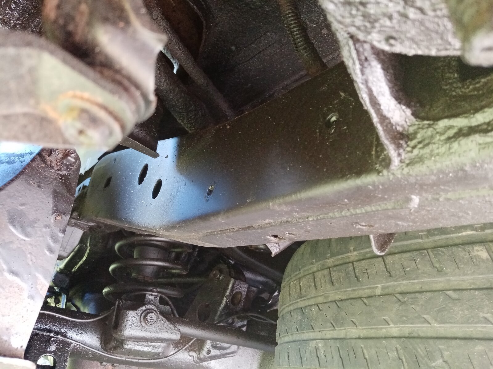

On the chassis we cleaned it sprayed a black wasoyl product on the exposed chassis and done the engine bay inside doors and a few other places with the lanoguard.

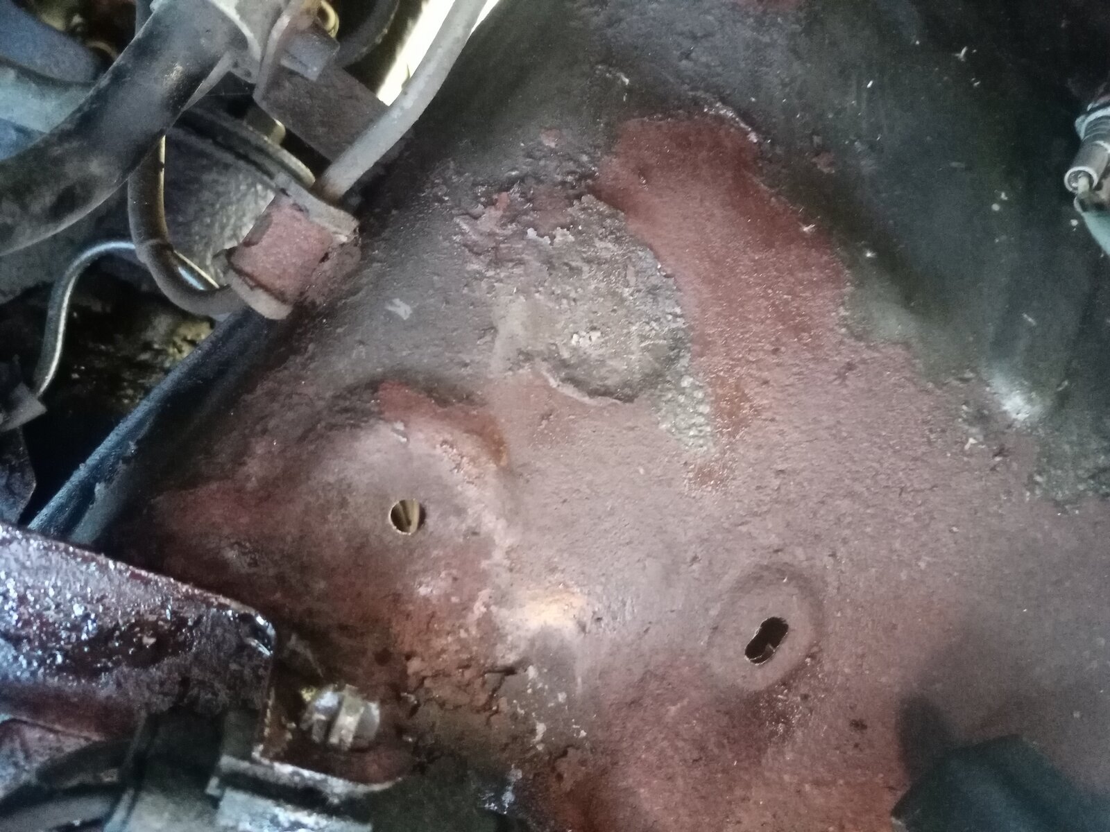

I seen these holes from above the front wheel arch In the engine bay there's a bigger one on the other side. I might be missing a bit or will I just cover the holes up with a bung? They look down right over the tyre.
I have them on my cruisers, I think they are for screwing/bolting other parts, depending on what model of the series it is.
They are different sizes, just make sure the big one you have, is not a small one rusted out.
I have put bungs in where I can, to stop water/s**t entering engine room and rusting.

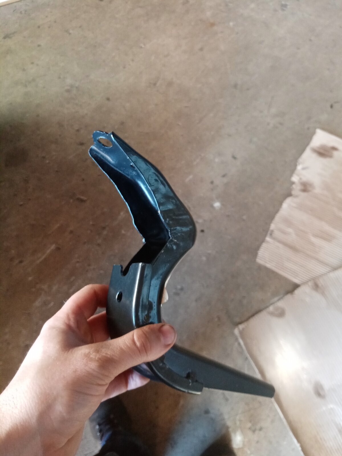

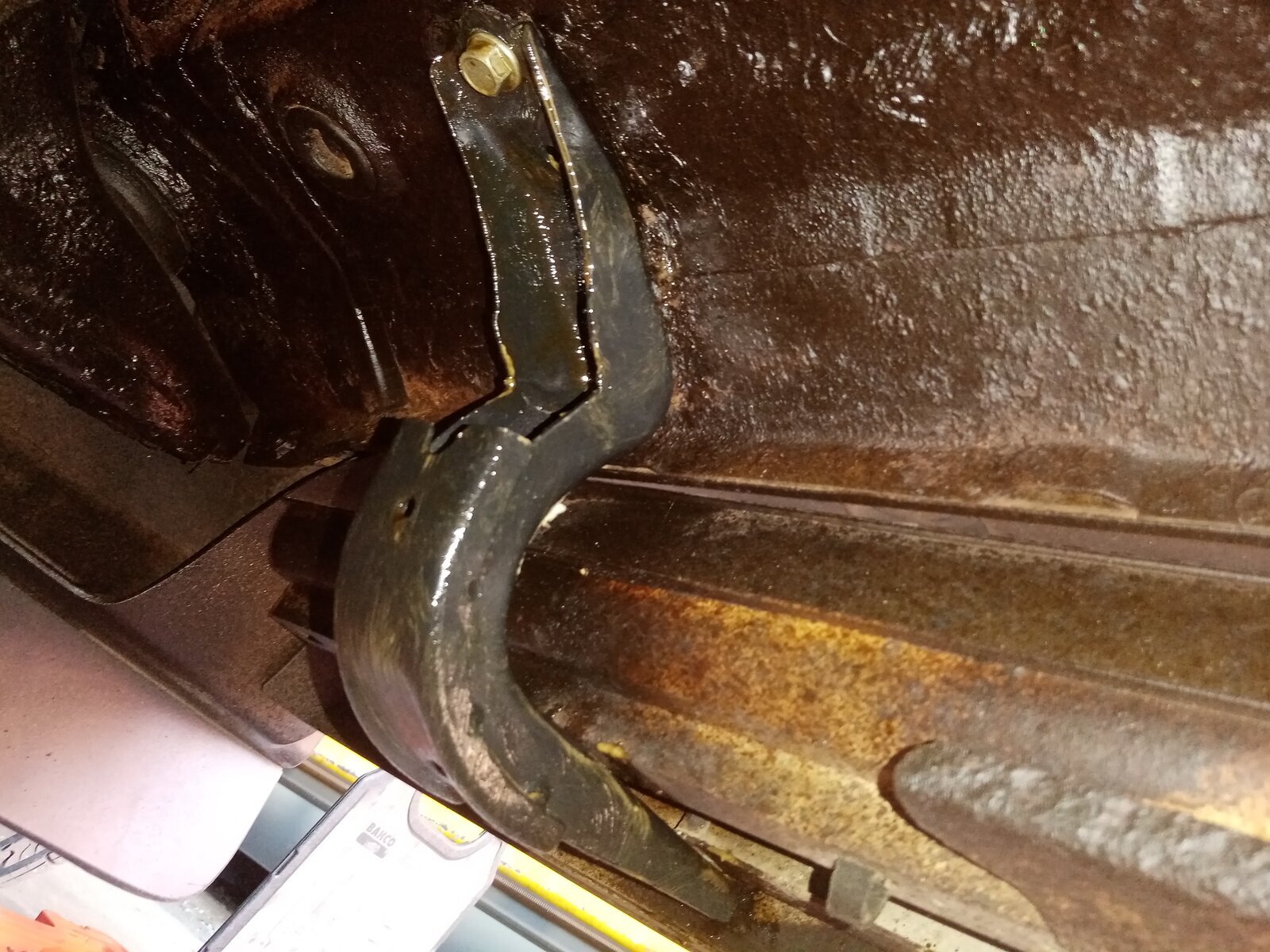

Another bit done the right side step bracket on and some of the lano grease painted on the bolt heads and the bracket.
I put in new bolts and cut them down short hopefully that will help the next man on down the road.
So the side steps now nice and stiff again.
