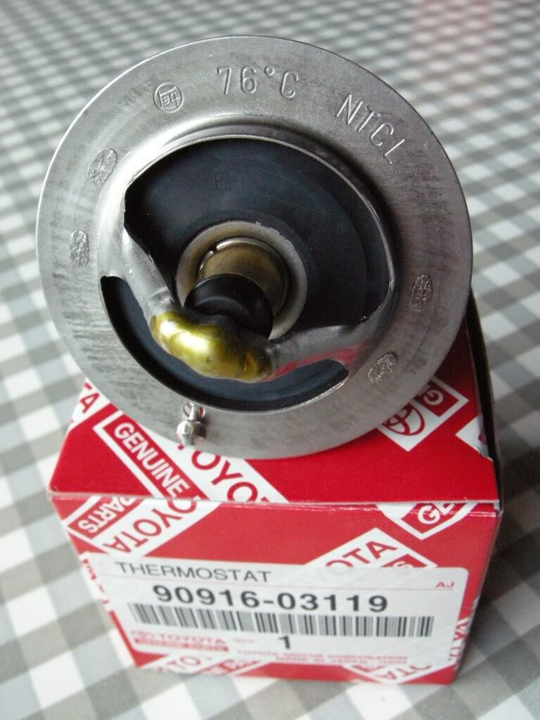

A 76 degree 'stat may solve your problem when towing:
I have a 76 degree stat, extra cooling rad for the gear box, (and a new rad) and fitted an aftermarket digital temp reader to show just how hot the water running round is - the genuine temp guage is a waste of space. I am somewhat scared of boiling her up!

I don't know how much the 'stat that Bob has posted above costs from Toyota. However, if it's really pricey or hard to get, this is the 76-degree thermostat I fitted http://www.yoyopart.com/oem/138783/herthbussjakoparts-j1532020.html
Google the name/part number and there are lots of buying options. I think I got mine via Amazon for around £24.
