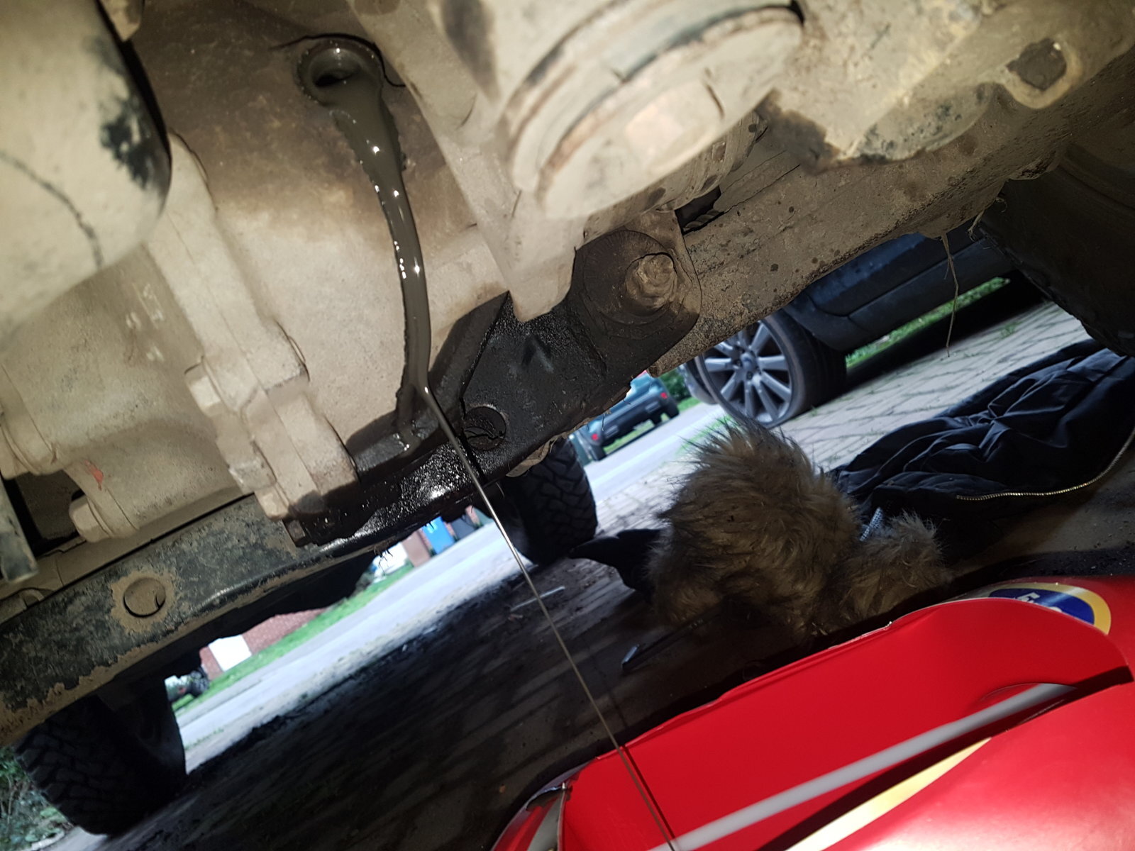

Im going to try drain the fromt diff oil and see what comes out

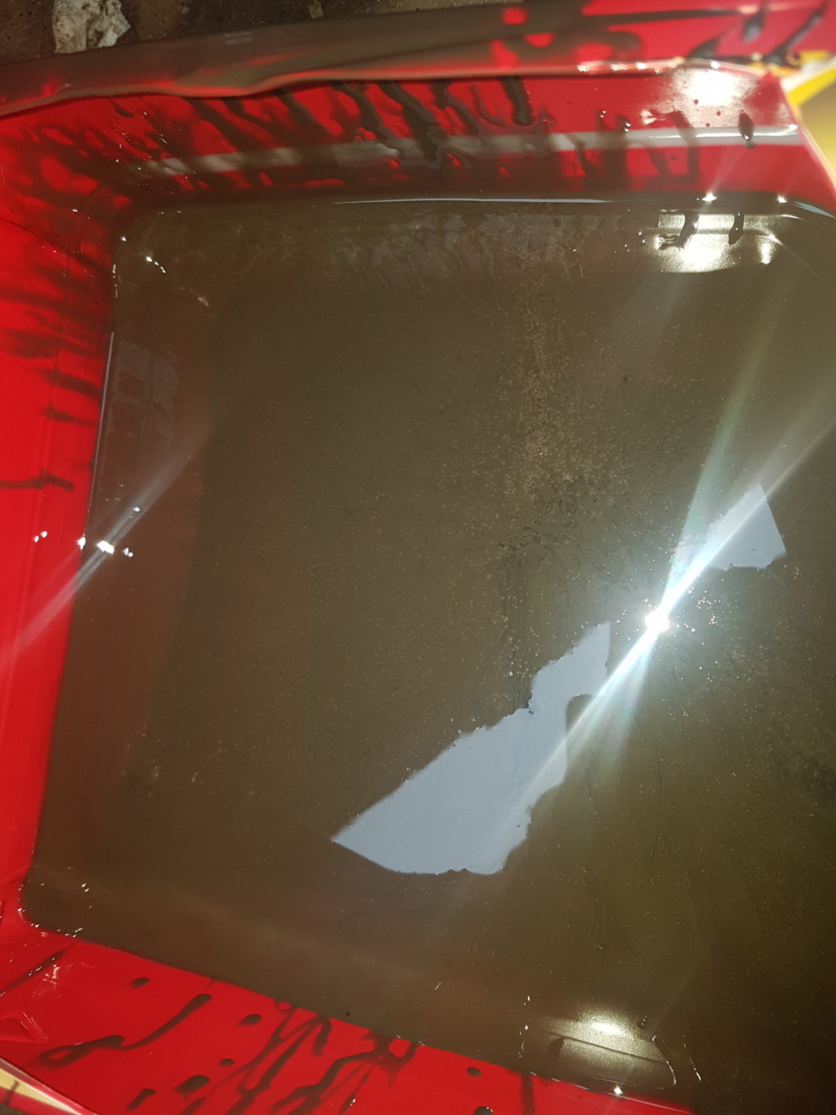

Front passenger side diff seals been leaking and a brown creamy colour fluid came out, doesnt look clean at all and it overflowed out the fill hold so does that seem like water has gone in an killed my diff
Ouch , crunching suggested gears to me but not enough info to set you worrying about that . Sieve the old oil see if there's any metal in there you might have got away with it .
Just drop a magnet probe in it and see what comes out.
Now the front diff oil in a Collie has a really easy life and really needs changing very rarely. That looks terrible. Like Shayne says, you might have got away with it. It's hard to tell. But I'd flush that through and drop it again. It's not much oil. On the brighter side, your truck looks pretty nice underneath. Are you sure it's not a wheel bearing going?
Cheers for the replies lads, ill check the old oil and let you know! The drain bolt suprisingly only had tiny bits of filings on it and nothing id imagine out of the ordinary for the age of the truck?
