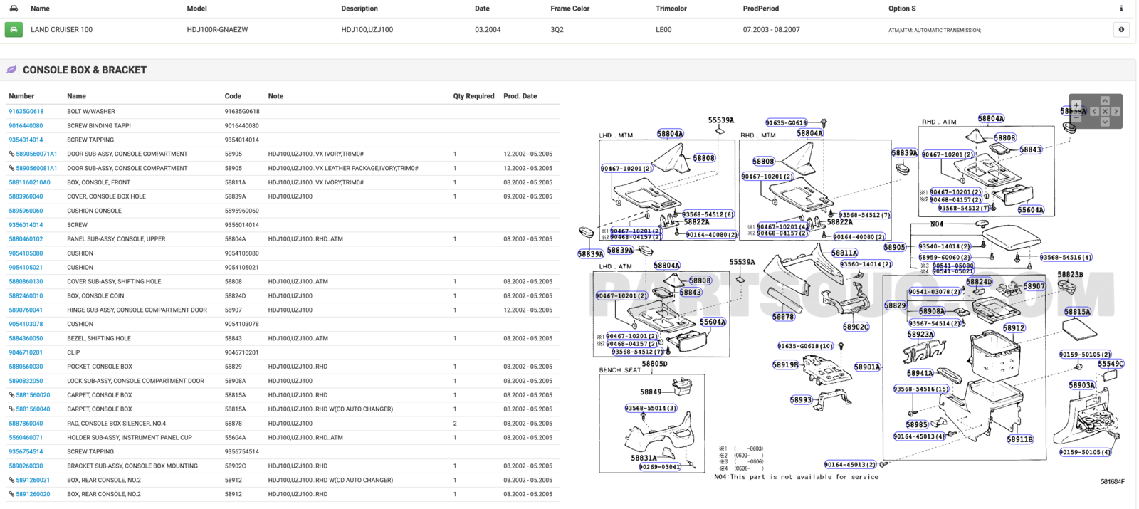

In that case the PN for the lid with the upper catch, that you can't buy separately is 5890560081A1 and very expensive.
The PN for the botton part of the latch is 5890832050 and is cheap.
