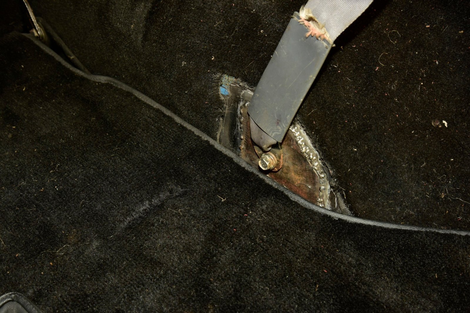

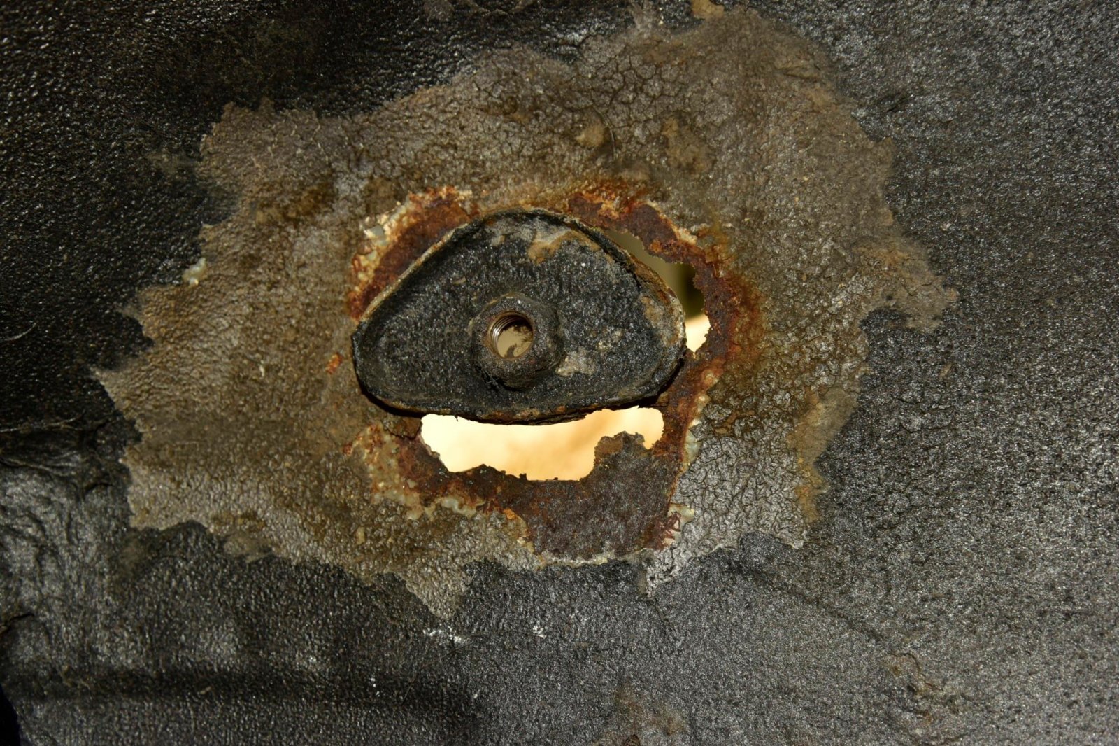

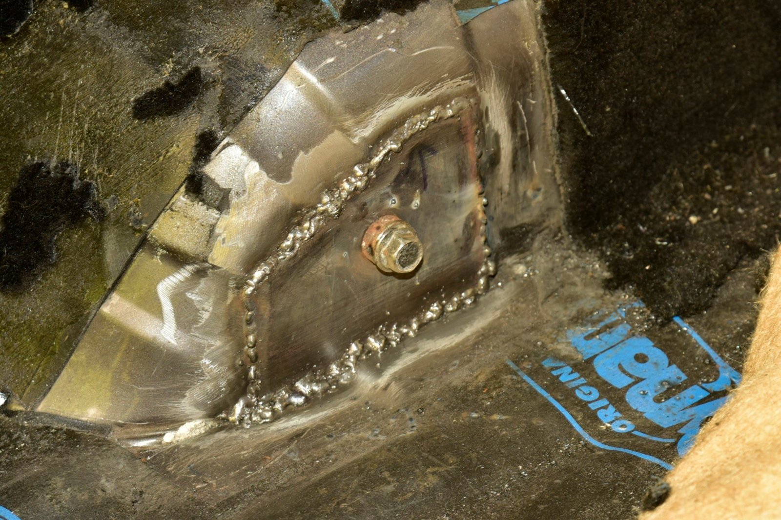

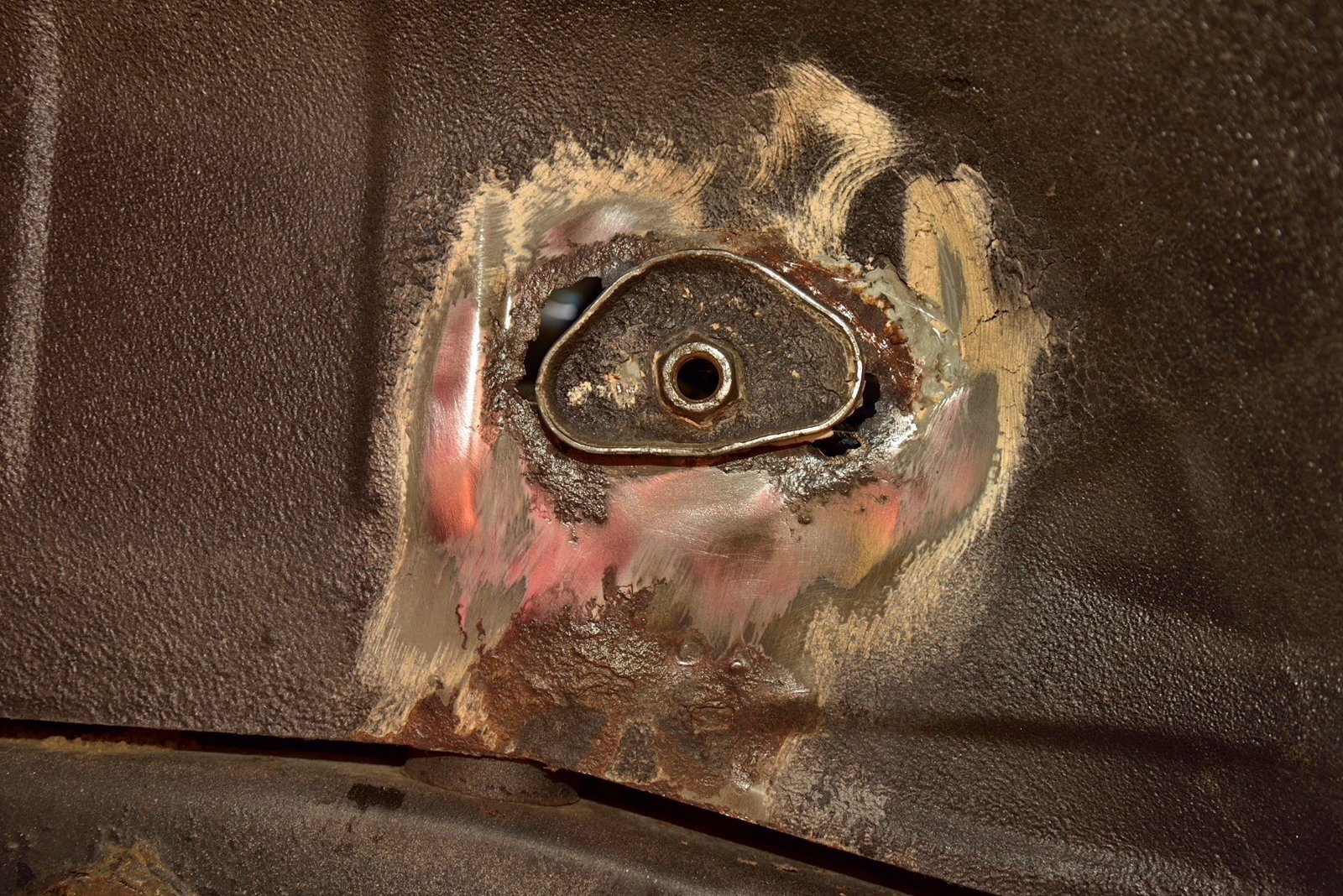

Hi all! MOT this morning, amazingly all it needed was some welding on the rear seatbelt mounts, and that was it. I immediately raced to weld it in a two hour window today and got that sorted.
Aftermarket carpet was completely glued to boot, so had to do some butchering, but it's plain black carpet so will find some more when the dust settles.
I ground back the rust, cut some chunky 3mm mild steel plate, and fired up my little mig welder - welds are not pretty, but really short on time today. The rear seat belt mounting points are rock solid now anyway.

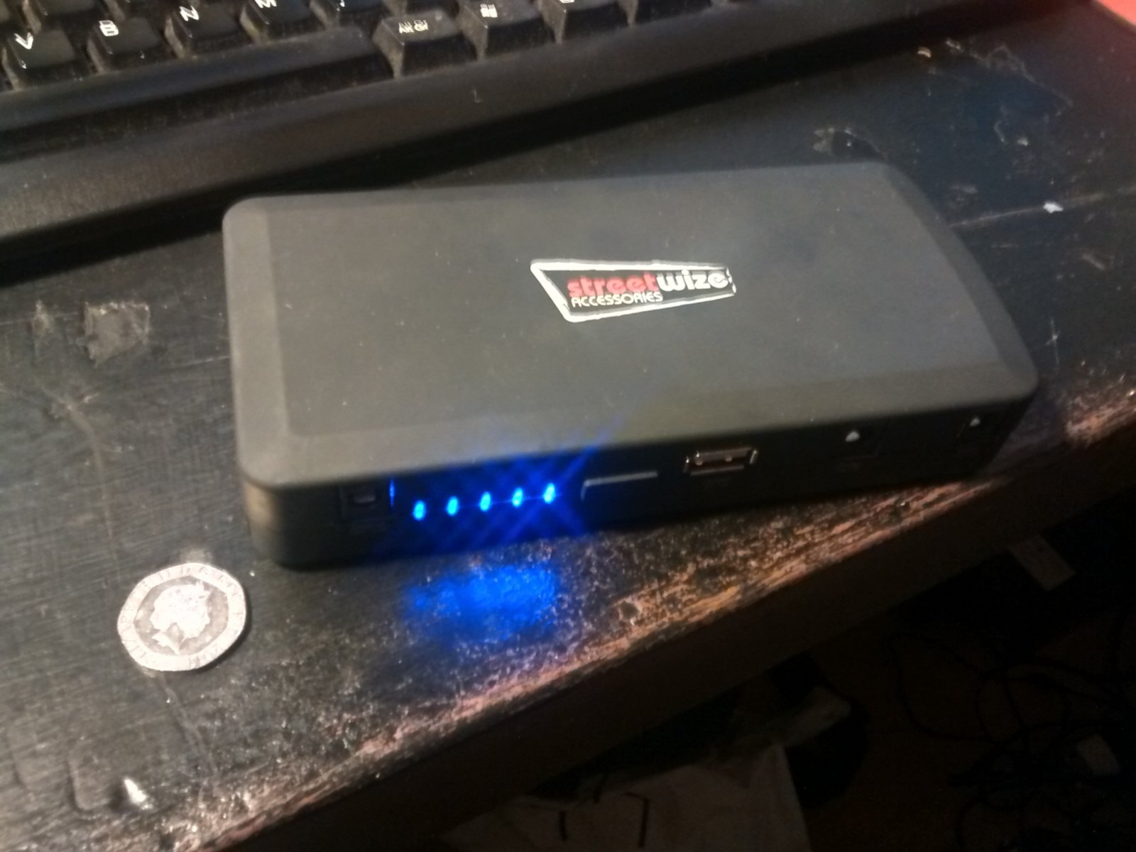

One thing I bought for emergency starting was one of those lithium cell battery jump boxes, they are tiny and you would swear it would never have enough power to jump start an engine, but they work incredibly well, even on the 4.0l V8 which had sat for some time. It charges phones and even my laptop as well. (cheap phone pic below).
