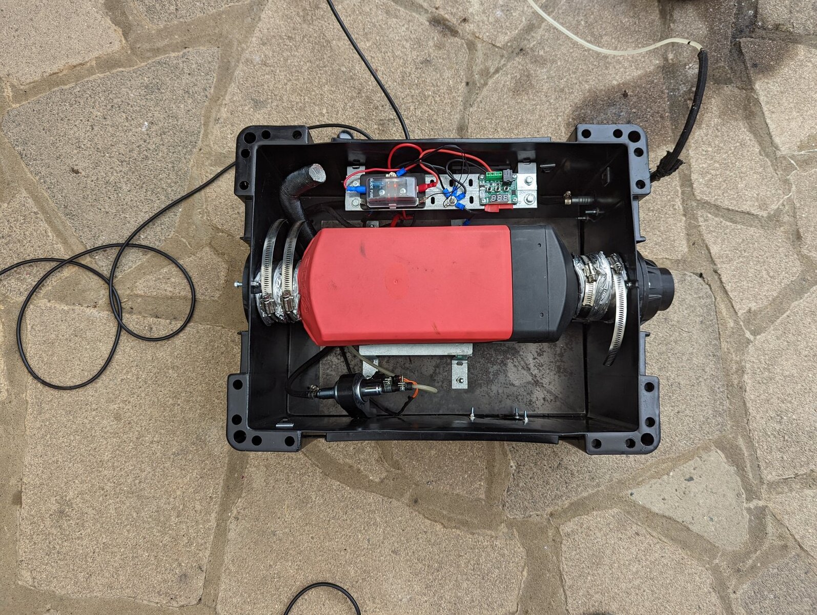

Been building comfort into the truck so the family will be happier and I can venture out in poorer conditions. First stop was a diesel heater, thanks @Jacob100. Just waiting on the final exhaust section to be delivered so I can fit it and wrap it to finish it off.

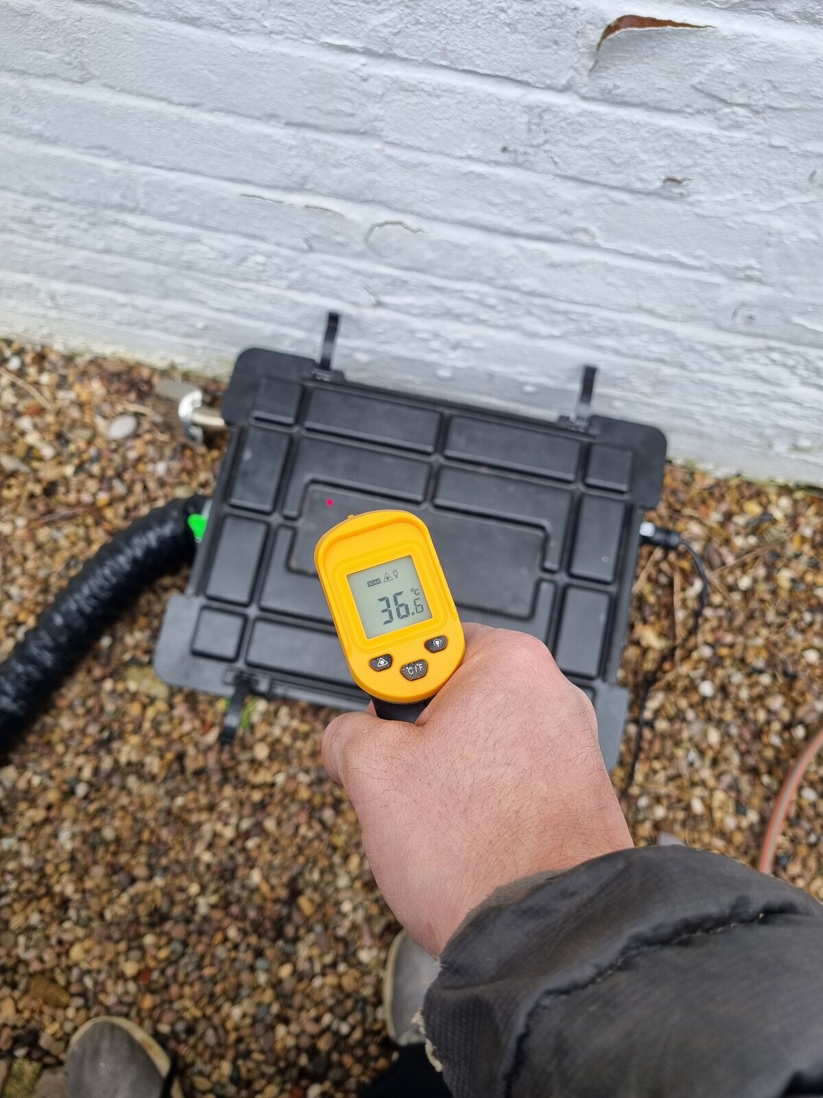

I may add an exhaust fan, when I see how much heat is cast off and a USB socket.

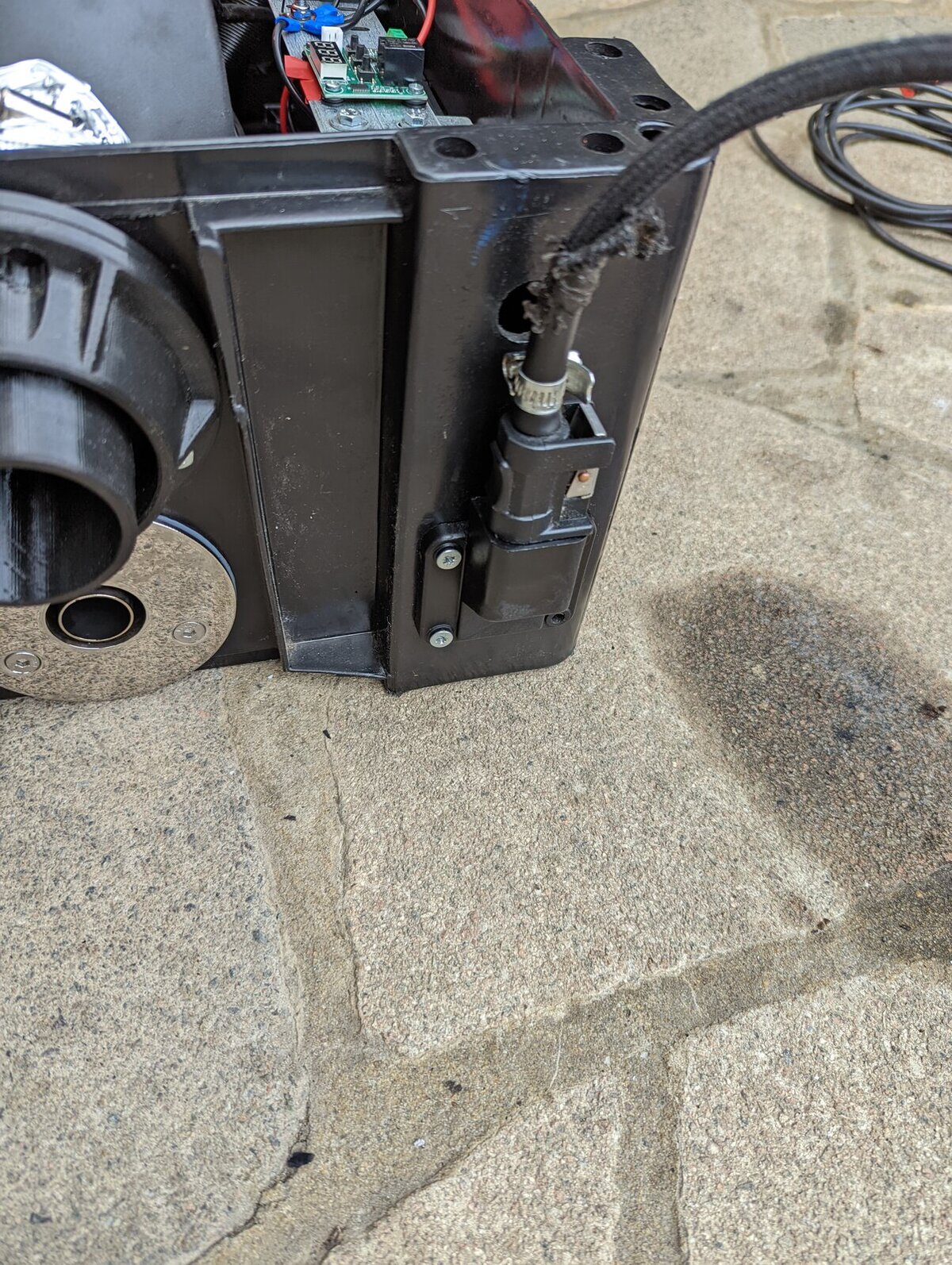

Fresh air is drawn in near the air filter.
I wanted everything contained in one box. So the fuel tank is made from a 2L fuel bottle with a vent pipe. It rotates upwards to allow easy filling.
Came out alright for a first effort.
