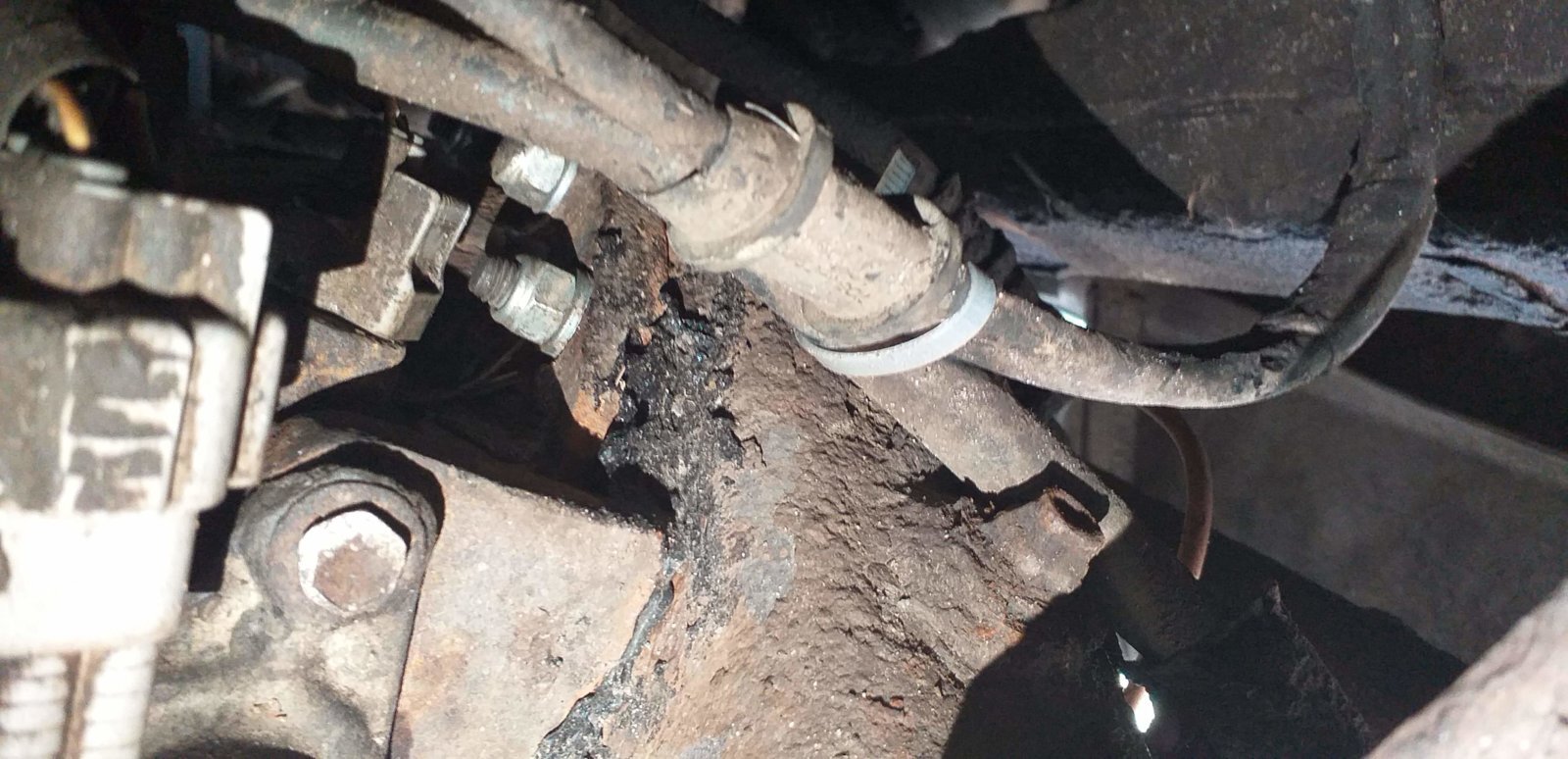

There are 2 breathers on the axle one on the top and one for the diff lock actuator. The one on the top just screws in

This is the axle breather https://www.roughtrax4x4.com/genuine-toyota-axle-breather.html
If the nut is rounded i would assume you could use a chisel/screwdriver and a hammer to make it turn .

This is the thing i thought was the diff breather? Where abouts is the other one?

Sorry for the poor photo, the thing i thought was the breather is the "bolt" below the 2 cables to the right of the pic
