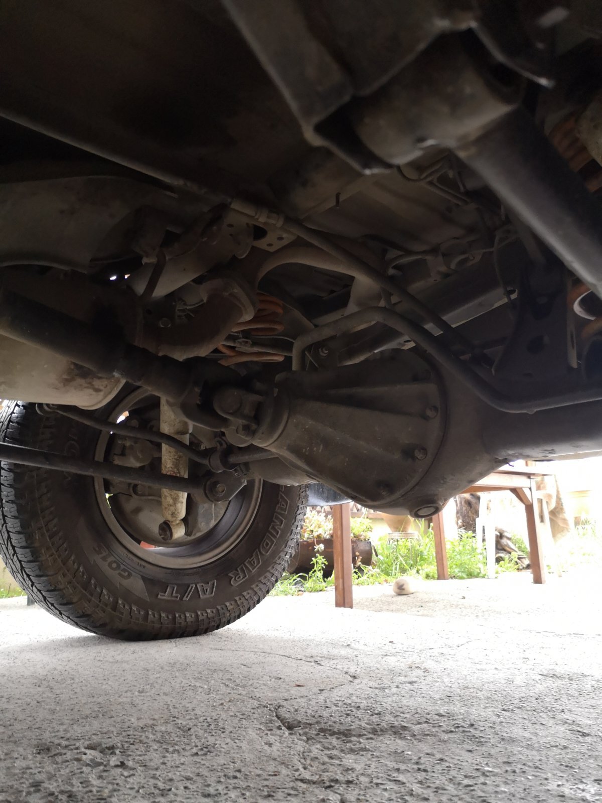

Thanks for the reply guys. I typed wrong in my question. There is no switch on the dashboard and my rear axle does not have the casing for the differential lock now that I have seen the picture Shayne posted. Here is a picture of my rear axle. So not having such an axle, what is the procedure to make my 90series have a rear differential lock?

It will be a fairly involved procedure, needing at least:
-Rear axle case and diff for difflock model, making sure that it matches the ratio of the existing front axle (probably easiest to get complete front and rear diffs from a donor vehicle). Rear axle cases are rust spots, so careful choice needed - many are in a poor state;
-Difflock assembly - most 2nd hand ones are dead or dying, as they corrode eventually. New is c.£400
-Difflock ECU and lots of wiring harnesses to connect the ECU to the transfer box, to the diff, and to the dashboard. You may be lucky and some of the harness may already be in place, but not guaranteed on a Prado.
The cost and time involved will add up to the point where it might make more economic sense just to trade for a UK market model, although the chances are the difflock assembly will be FUBARed and need replacing.
Your model looks pretty solid underneath, so perhaps live with the LSD? I don't know how well they work as they age - in my Isuzu Trooper days it was common wisdom that they stop working after a while, but I was never sure if that was true.

Having had an Irish spec model for a decade, with no rear diff lock, but an LSD and centre diff lock instead, I have to say the truck is plenty capable in that spec. Yes you might want the rear locker in more tricky situations, but it depends on what you paln on doing. I've never had mine stuck including being up to the tow hitch in a peat bog
