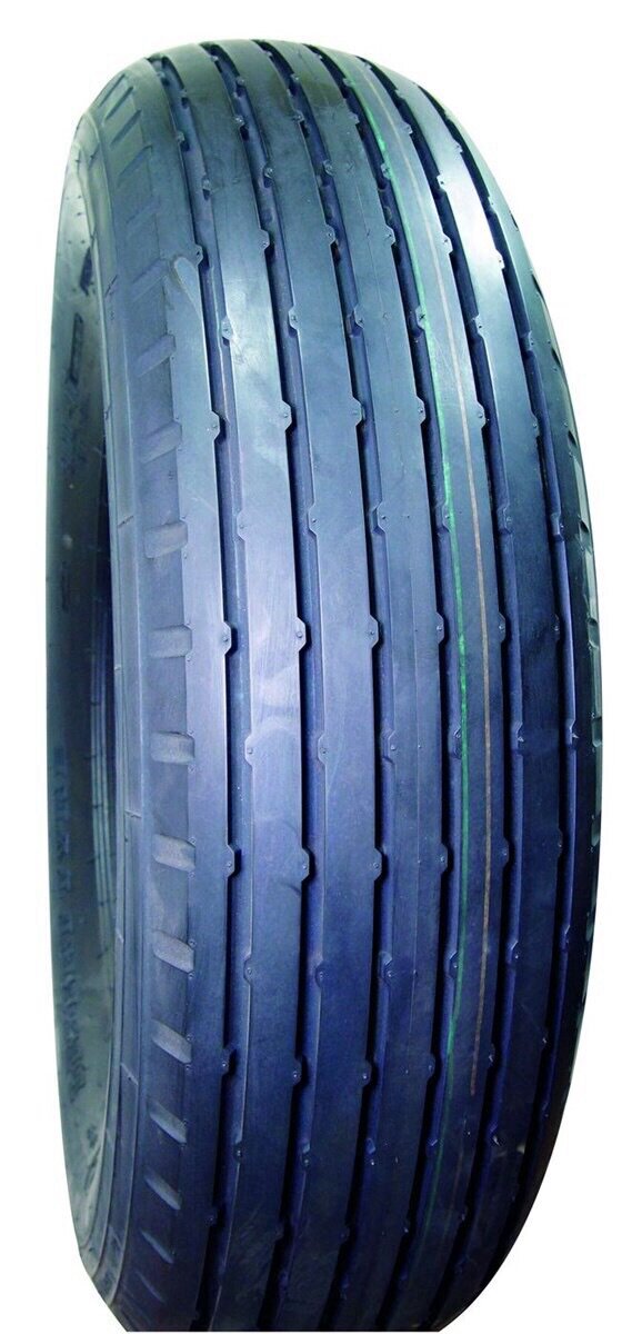

There's a nice discussion article on this seemingly endless debate. The outcome is generally that a narrower tyre is better than a wider one on sand, the greater benefits coming from a bigger rolling diameter. Sand tyres these days are almost smooth, with a longitudinal hoop tread pattern, like old fashioned cross ply tyres used to be.
But there are still die hards that say a mud type trad pattern is better. Whatever wins the debate, none of them are good on asphalt, so there will always be a compromise if combining the two circumstances.

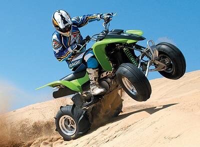

What I saw in the Middle East was various combinations, the quads for example used to combine the tyres for obvious reasons...
whereas cruisers and jeeps used to tour the dunes with these front and rear
Those on the trucks that go cateering round the slip faces of the dunes?? Not for me, that - I'm too 'bang broek' (scaredy cat) for that stuff lol

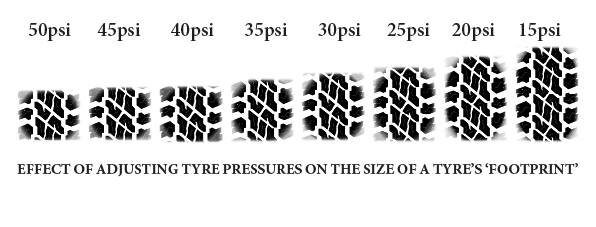

What airing down does. Width doesn't change much, if at all, but length of contact does.

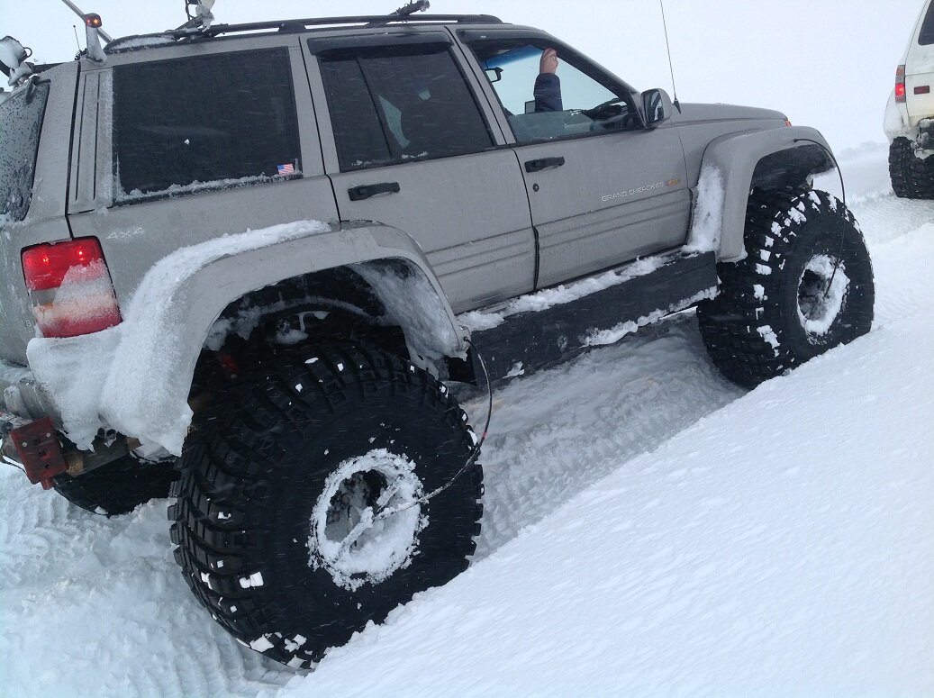

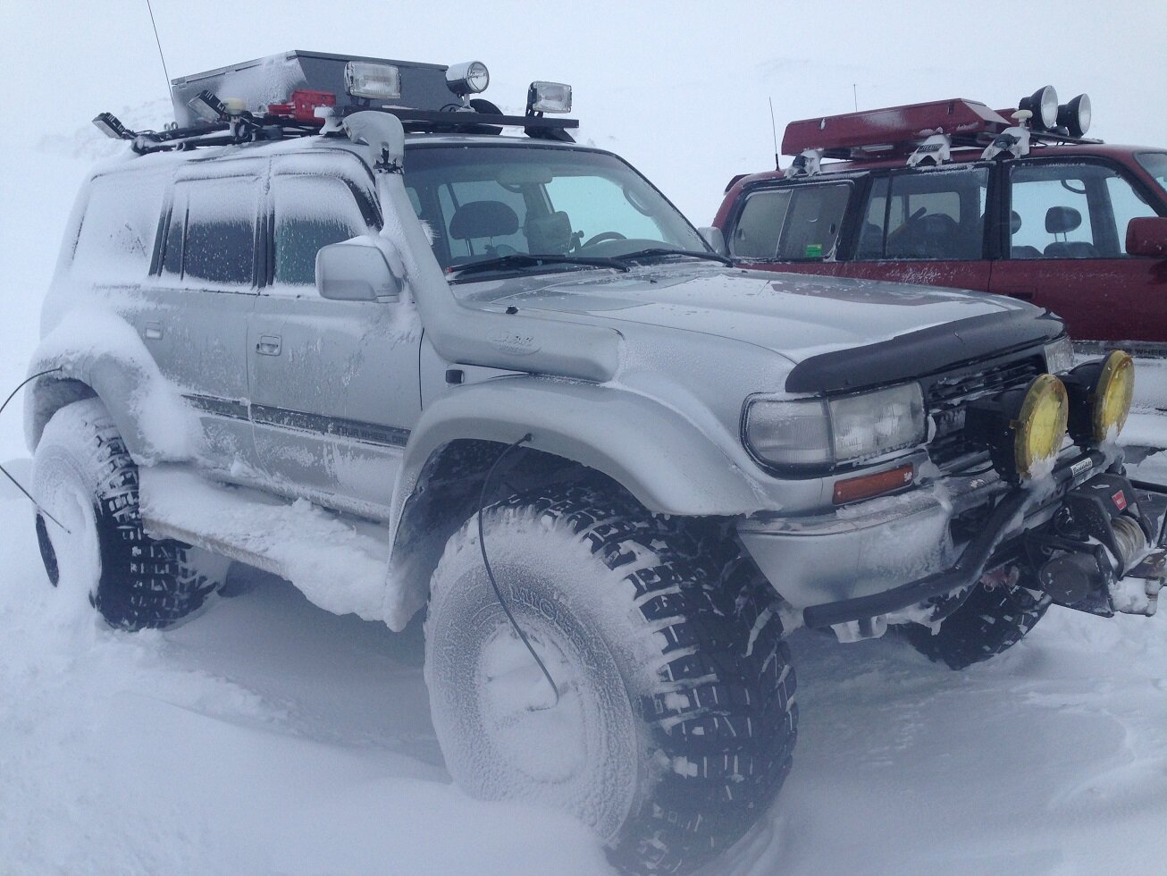

You could do what they do on the cruisers in Iceland: (sorry. Not a cruiser...)
here:
here:
Yeah, but I would rather not have those wires hanging outside the car.... Maybe a rasonable solution is a good air compressor combined with a device that can inflate and deflate all 4 tires at the same time. Im searching on google. Also, anything slightly complicated can become a nightmare in Mauritania...
