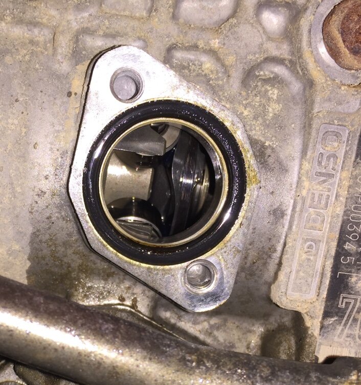

5, took the ACSD off as there is some talk of bits breaking off and lodging in the pump. I'm not sure which bit breaks (anyone know?) but here's a photo up the bore of the pump. ImageUploadedByTapatalk1434522075.762552.jpgThe actual lever on the ACSD was fine (as far as I could tell looking at photos of other people's on here) but I don't know whether the bits that can break are part of the pump itself?
Looking at the photo, I'm not entirely sure what the ACSD acts upon. Is it the grey wedge shaped lever at top left? If so it looks vaguely like the lever on the ACSD MIGHT be scoring on the face of it rather than acting to move it left, if you see what I mean, though there isn't any evidence on the edges of jumping or being forced around the end. Anyone got any experience here to know how this operates and what should be where, acting on what?

It defo won't be the ACSD. The pin that breaks off is that little one on the part you have taken off.
P.S. Yes it acts on the wedge at the top. When hot the pin will not touch the wedge and the pump injection will be running at it's timed position as in the Workshop Manual. If the ACSD is removed and a plate put over the engine will NOT need to be retimed. I think I mistakenly posted the opposite some time ago.
