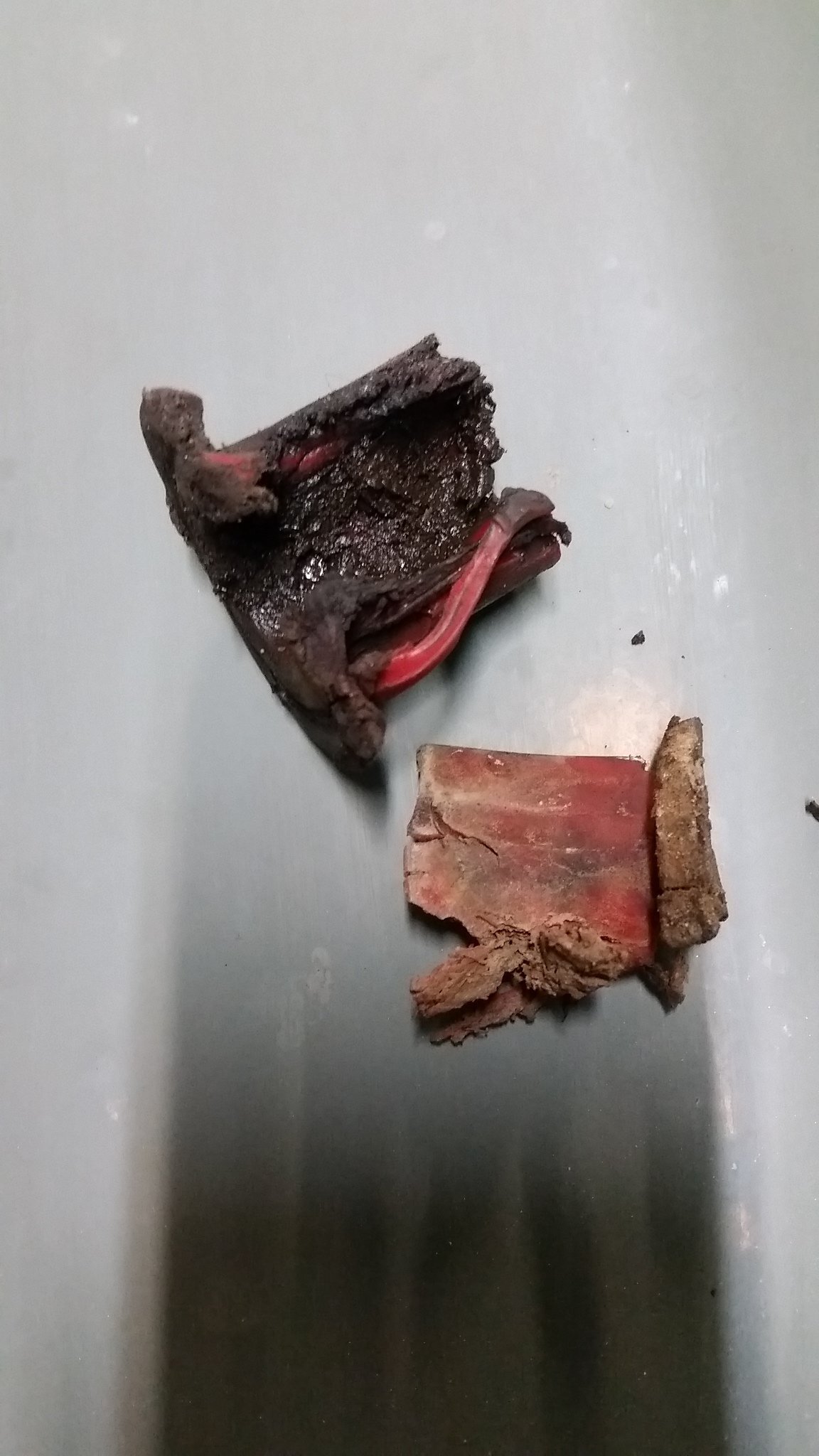

I replaced one of the centre spring bushes last night after work, it was a bastard to get the spring to line up but I managed it with a couple of jacks to bend it up and across at the same time... I'm glad I replaced it as it was totally destroyed. I've got the other one to do this afternoon.

All of the other bushes were greased, but this one was dry. I think they must have forgotten it or the grease nipple was blocked?
