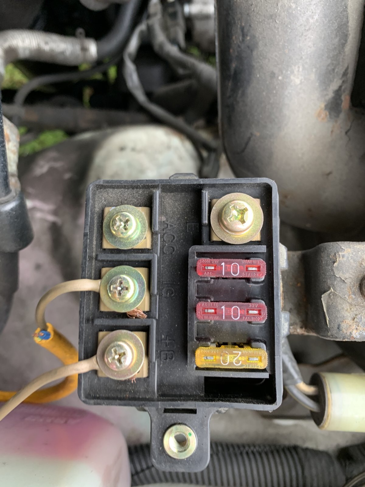

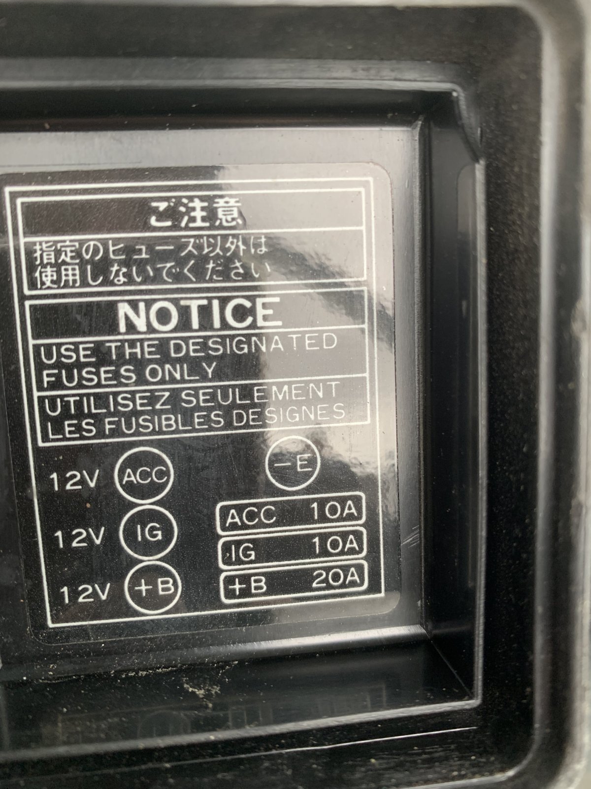

Hello today I had a chance to look at a few things, my dash lights don’t work and truck won’t start no clicking noise nothing, but when I open the hood and open the small black plastic box it has a positive post along with a acc and ignition post if I jump a cable across the positive post to the ignition all my lights in the dash come on and I here a click from the glow plug relay and when I turn the key the truck starts and runs until I roll the window down then it cuts off and blows the fuse by the ignition post... I don’t think it’s my starter or solnoid or my alternator or battery could it be a bad starter relay? As I am not getting and power to the back of the ignition where the key is, but have power for the dome light and hazards inside the truck I know I have said a lot but what do you think it is thanks MikeHi Mikey, have you checked your batteries? Test their voltage across the terminal posts. Should be over 12 volts. Have you tried jump starting it? It sounds to me like the alternator stopped charging the batteries and they ran low until the truck stopped. There’s other possibilities such as fuses and fusible links but you’re going to need to give us a bit more to go on. If it is the alternator you’ll see a voltage lower than 14.4 tested just after starting. If so, with the meter connected and in view try wiggling the plug on the back of the alternator and see if you get any change in the reading on the meter.
Hello the switch for the windows is in the door, I am going to have a look tomorrow and see if I can trace why I am not getting power to both the acc / and ignition... it’s weird cause the truck runs fine but the min I turn on something the draws current seems to shut the power off completely... thanks again will let you know if I find something, I hope soAre any of those or other fuses blown? Any fusible links (short skinny wires into a connector to the loom wiring) connected to the battery terminal? Where is the switch for the electric window located? Dash or door?
