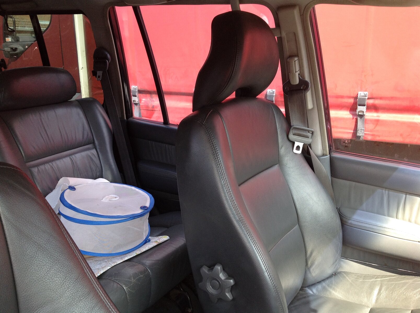

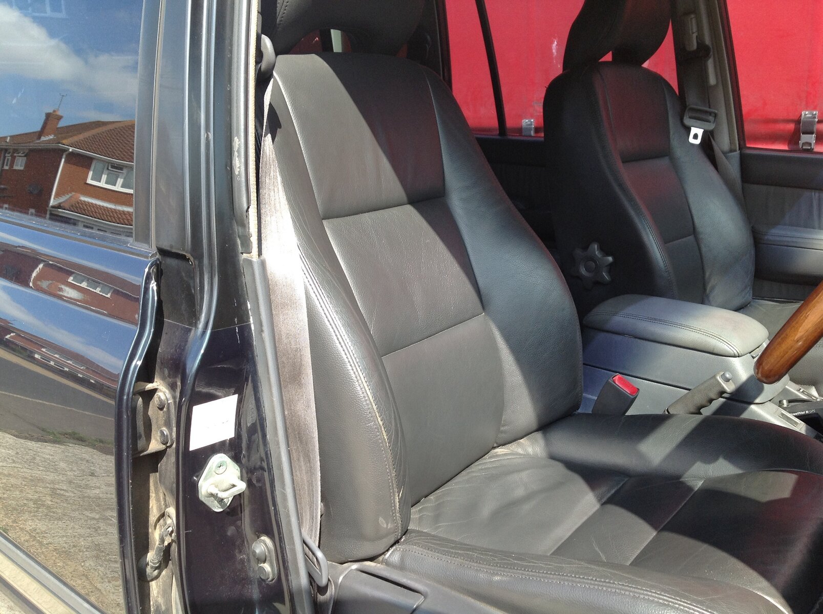

My original front seats are past their best, I've had posh canvass seat covers, very expensive but they ain't really cut the mustard although they looked very nice when new. A good pal of mine was scrapping his Volvo V70 and asked if I needed anything from it. So I inherited the fron leather seats. I have been a fan of Volvos ever since we had a 245 GLE back in the 80 s, the only car interior the kids couldn't wreck. Great experience with the car, so in the chairs went, they had to be raised 20mm and I asked for 30mm further back, I'm very happy with the result. TBH I would prefer a refurbished original set set up and back a bit, but at this price these will run a close second. Whaddayathink? image.jpgimage.jpg

Slow reply, sorry, neither here nor there about the headrests, they are ok for me and the wife, like the raised bit and back a bit tho' more legroom in the front, we have no rear seats most of the time, makes for a roomy feel, not really informative eh? But pleased with the result, but as mentioned would prefer original seats moved to as they are now. We have some Toyota MR2 seats in a discovery, they are nice! If you can find em, Best regards , Bill Westley

These seats look great! How did the install go? What exactly did you have to do? Drill new holes in the seat rail? Weld?? Please advise.

~Rookie
