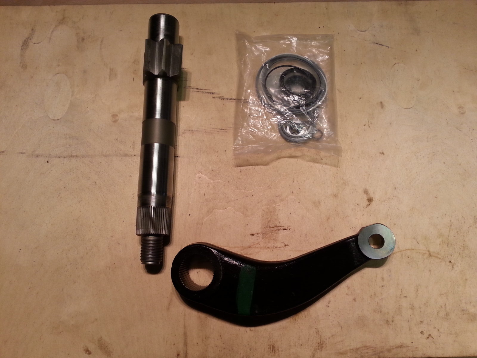

They are a upgrade for any 80. They fit in the standard 80 steering box. I need to check up on this again, but afaik, If you were to order a new 80 steering box they would come with this shaft and arm.When you say uprated CG, is that uprated for any 80 or is it an upgrade for earlier models to later ones. I have no experience at all of messing with the arm and shaft.
SO this is the shaft fitted to the Late HZJ/HDJ/FZJ105 ?They are a upgrade for any 80. They fit in the standard 80 steering box. I need to check up on this again, but afaik, If you were to order a new 80 steering box they would come with this shaft and arm.
under certain conditions the standard shaft can twist or even break.
Most people will never have a problem, but if you run larger tyres and like to push it off road its a worthy upgrade.
