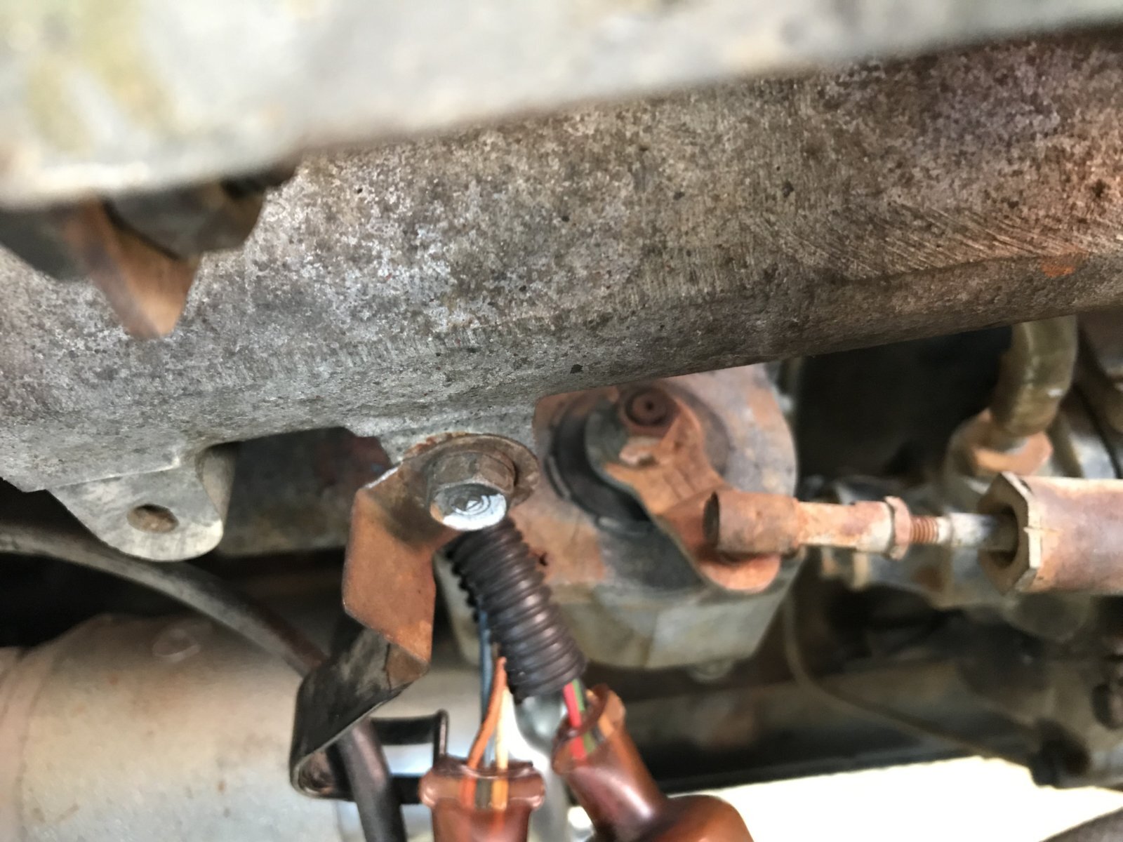

Apologies for delay vehicle is at my Brothers place on other side of Sydney - I just got here to have a look. The relay is clicking, but when I put ignition to start position nothing no sound aside from a mechanism that looks like a wiper motor. (See photo)

Do you have a test light? Or a volt meter?
See if there is power going to the terminals on top of the glow plugs when you turn the key to the glow position and you hear the relay click in.
