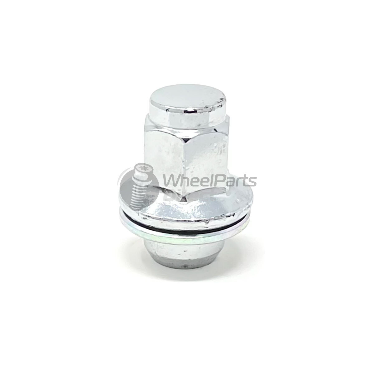

I'm expecting the standard 100 series nuts to fit- specifically these ones 14x1.5mm Flat 47mm Thread 22mm Hex Chrome Wheel Nut for Toyota Land Cruiser [J100] 98-07 - [Leaving Land Cruiser Club]
Thanks I’ll fheck the link. Looks like Range Rover uses same size so I have one of them on the way to try. My wheels are steelies so wrong nuts. Shame they’re not M13 I have a complete set .

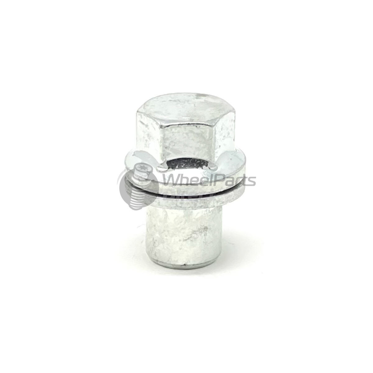

Just picking up on this- i'm not sure the range rover are the same- they are the same thread and pitch, but have a different shape on the wheel facing end of the nut.
I'm not saying they wouldn't work, but i wouldn't be sure they would either!
Just checked- they are definintely different- although they are both the same length- the placement of the nut "flat" is different, hopefully he two photos here help- the landcruiser is first, has the longer nut above the flat.

Thanks. I’m not sure that the cap matters since it isn’t going into a Toyota wheel. I trial fitted the wheel today and the one nut. the flange etc are fine but the shank is too long by about 2mm…maybe less!

if they nuts are 2mm long doesn't that mean you can't use them? They will impact the hub before tightening against the wheel properly? These are hub centric wheels so it's even more important that they are tight against a clean hub......

Yes the nuts are too long to allow the wheel to tighten (though did tighten against the drum on the back), but it was worth a look as LR/RR nuts are cheap and easy to get hold of.
