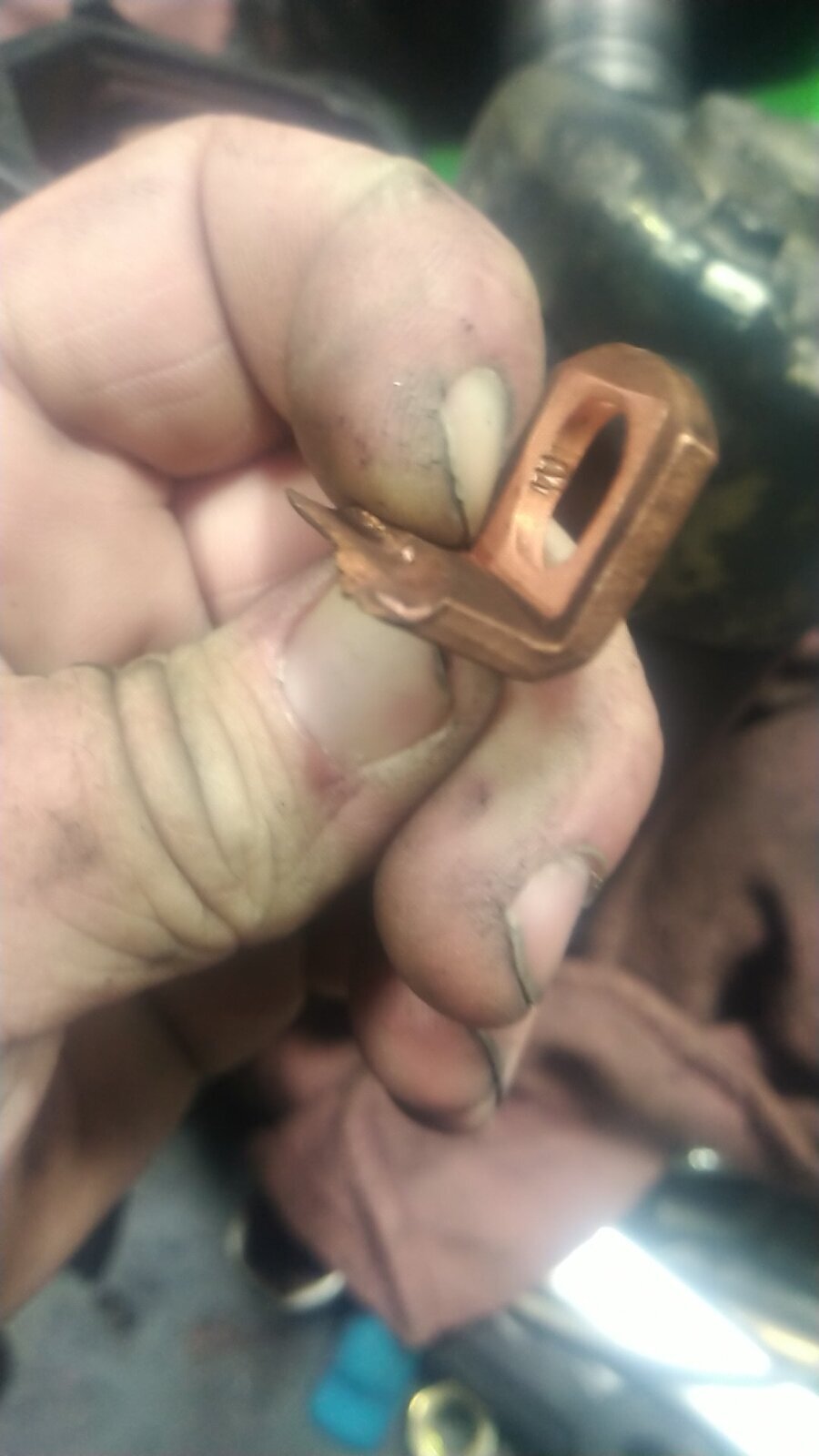

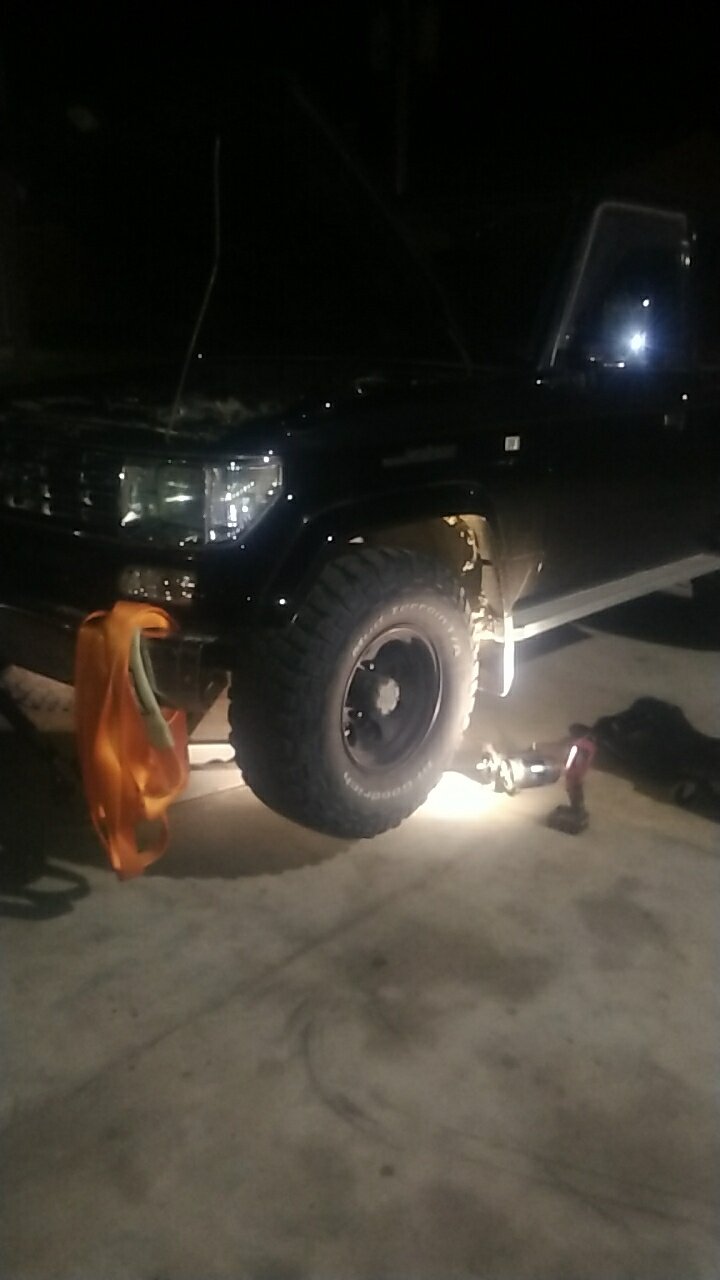

I have been having an intermittent starting problem, clicks no crank. I had successfully ignored it since it always eventually started. Yesterday it stopped being an intermittent problem...in the middle of my mail route. Thanks to some links and GOOD advice posted on this forum I got it apart, borrowed some tractor parts and reassembled it in time for the route this morning!

Yep! They do munch through the contacts. When you order replacements, order the extended ones that go part way round. And don’t forget to studlock (low strength) the three screws on the cover when you put them back. I had a small fire when I didn't studlock mine. !:scared-eek:
