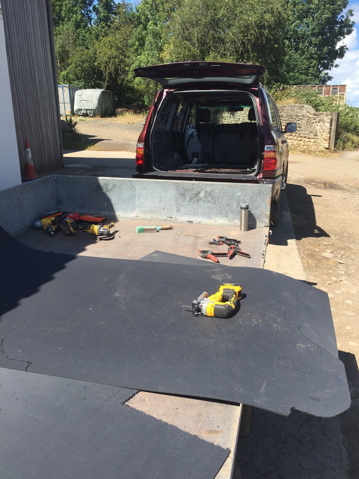

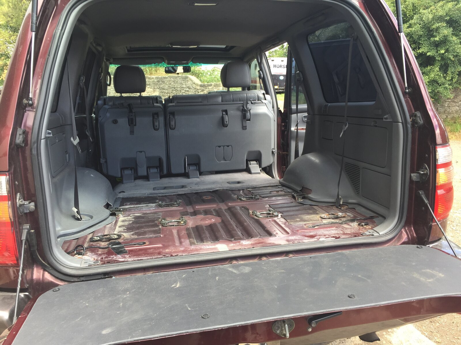

Hi All,
Thought I'd show my first minor modification to my 100 Series from a few months ago. Working in Agriculture, I always have tool boxes in the back of the Land Cruiser, and often greasy machine parts, too. This wasn't very compatible with the luxurious deep pile carpet that the car came with!
My solution was 6mm Stokboard, a product we often use livestock scenarios. It's made from recycled plastic, and is very easy to work with. I simply removed the carpet from the boot and tailgate, and used it as a template for the Stockboard.
Unfortunately, the trim around the rearmost seat mounts didn't fit well. I've since replaced it with copies I've CNC routed out of Stokboard.
