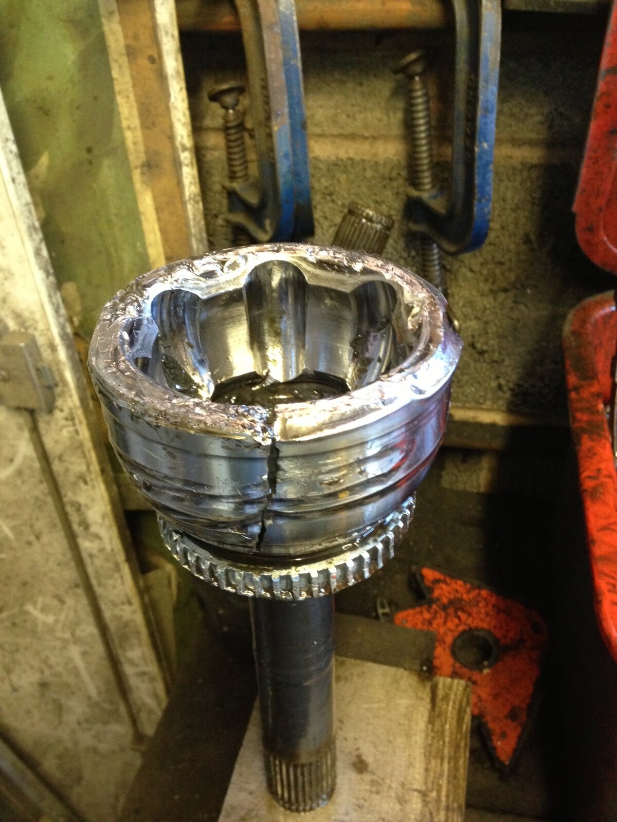

Roy there just doesn't seem to be a decent mid priced option for CVs here in the UK. I bit the bullet on this build and bought genuine Toyota ones. I had HDK failure and it cost me dearly. There did used to be some better ones about I forget - Lezura, lorenza, lacruiser, lebamba? which were seemingly OK but they simply stopped being available. There is a gap in the market here for either rebuilding or re conditioning OEM ones. I have wondered about taking HDK innards and shoving them into an OEM CV. I just don't know the answer really. If Blueprint ones are any better than HDK I couldn't say but if they were the same price, I'd buy them if I needed any. I also wondered about buying the typical HDK type but having them specialist heat treated. I found the outer bell was a soft as chocolate and just ripped open. Something an OEM part wouldn't do. If that would work, we could buy a batch and have them done. The ball bearings in mine didn't seem to wear and neither did the birdcage particularly but there was a great deal of evidence of wear in the cup after very few miles.

There's a fair few folk running HDK who say they've had no issues and I accept that completely. Thing is neither did I until this happened and it took my diff with it. Yes, I used mine off road. So rumbling round Tesco car park may well be completely fine for many miles. I can't say. But these had very few miles on them and only went off road once from memory in the snow. They let go on the way home. They seemed exceptionally soft to me and you could cut them with a hacksaw. I tried to cut an old OEM one and the saw just skidded off. Hence me suggesting that heat treating them might be the answer.
Since you first posted it, I've had this photo in my LC folder Chris, as a reminder!
It even looks soft, if that makes any sense.
My no-names were hard too, couldn't scratch them with a saw-blade.
These things are always a compromise, very hard normally equals very brittle, soft equals lots of wear, using the correct materials and getting the hardening right is the answer, perhaps this is why Mr T' offerings are so expensive, they have done the R & D and want some money back for their pain? Bearing (no pun intended) in mind that my other OE CV is approaching 240,000 miles, and I am not renowned for being a delicate flower when off roading.
