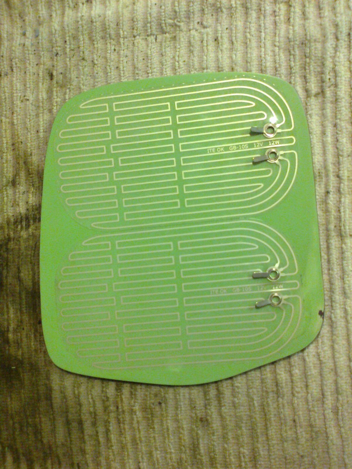

they are wired into the back of the rear defrost relay so come on when you press the switch.
the pads are 1 amp each, I used 5 amp wire.

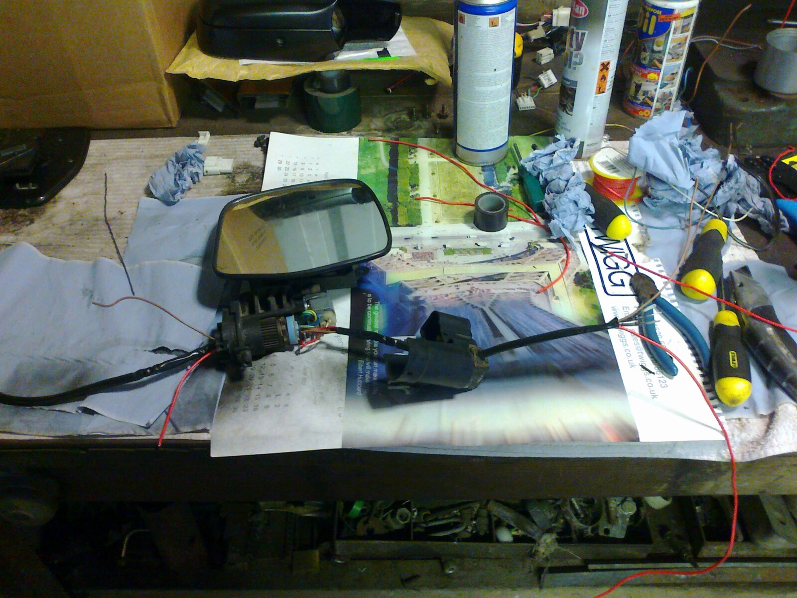

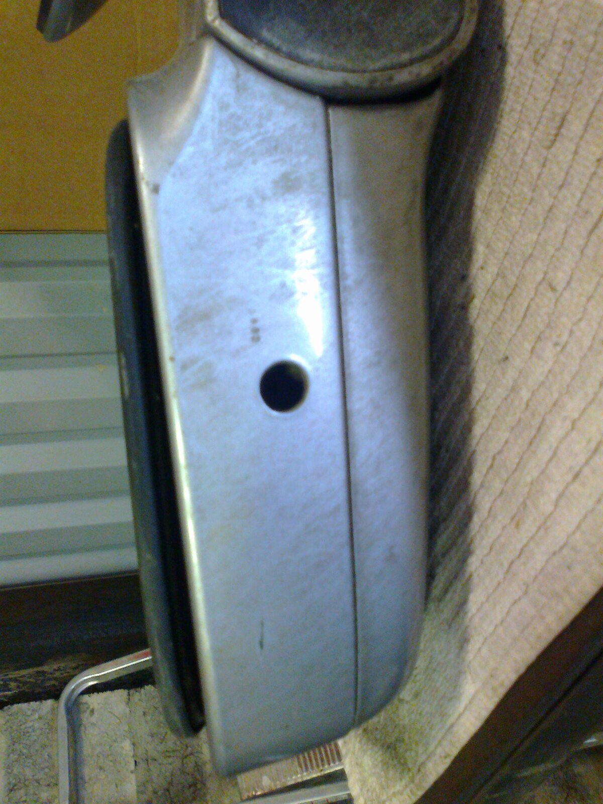

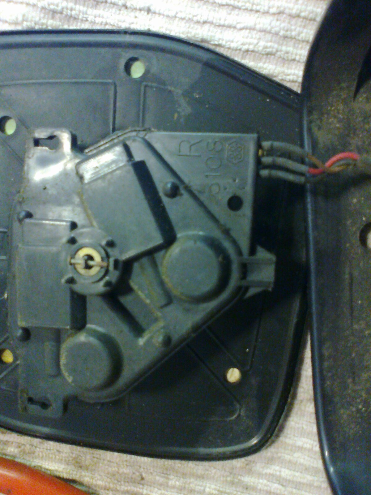

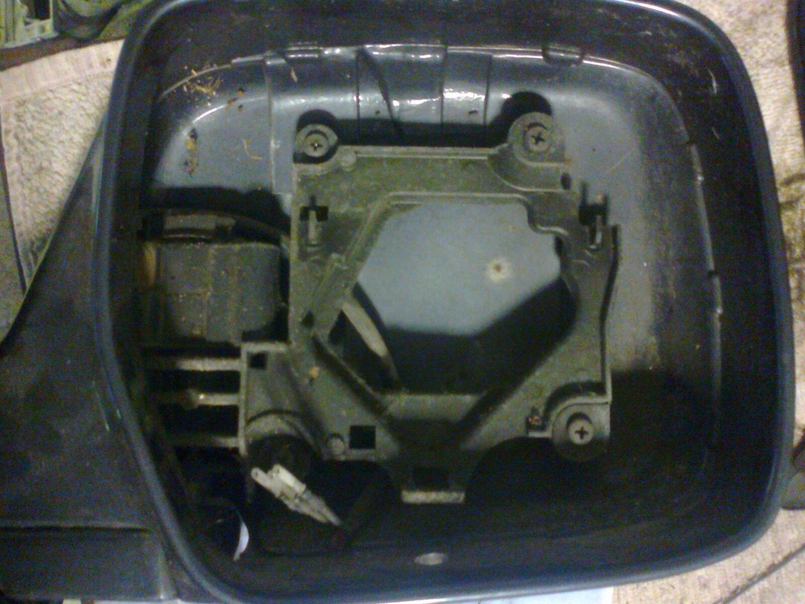

undo the screw under the mirror and remove the glass and plastic backing.
pull out the three connectors. remove the small pin, this is spring loaded so releasing some of the pressure will help.

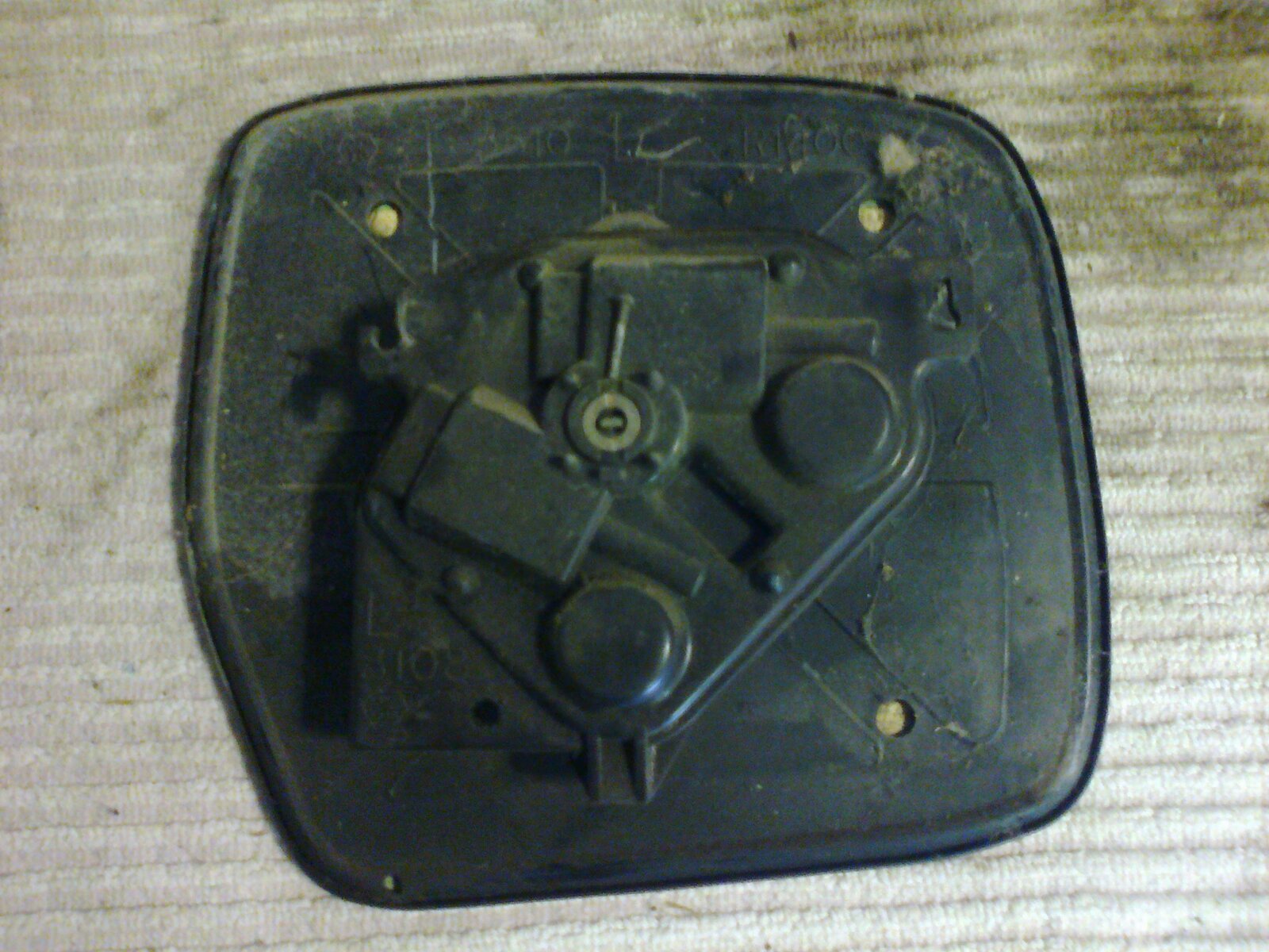

the motor assemble will now pop of the plastic backing.

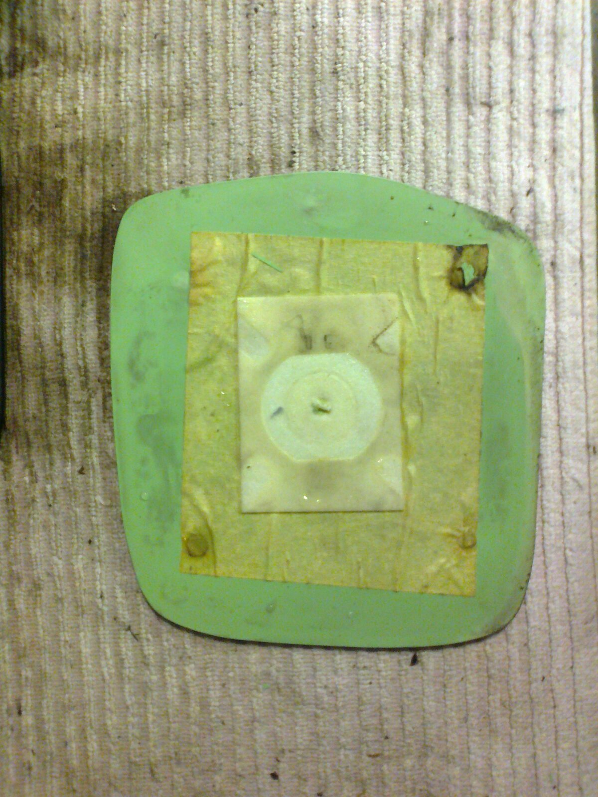

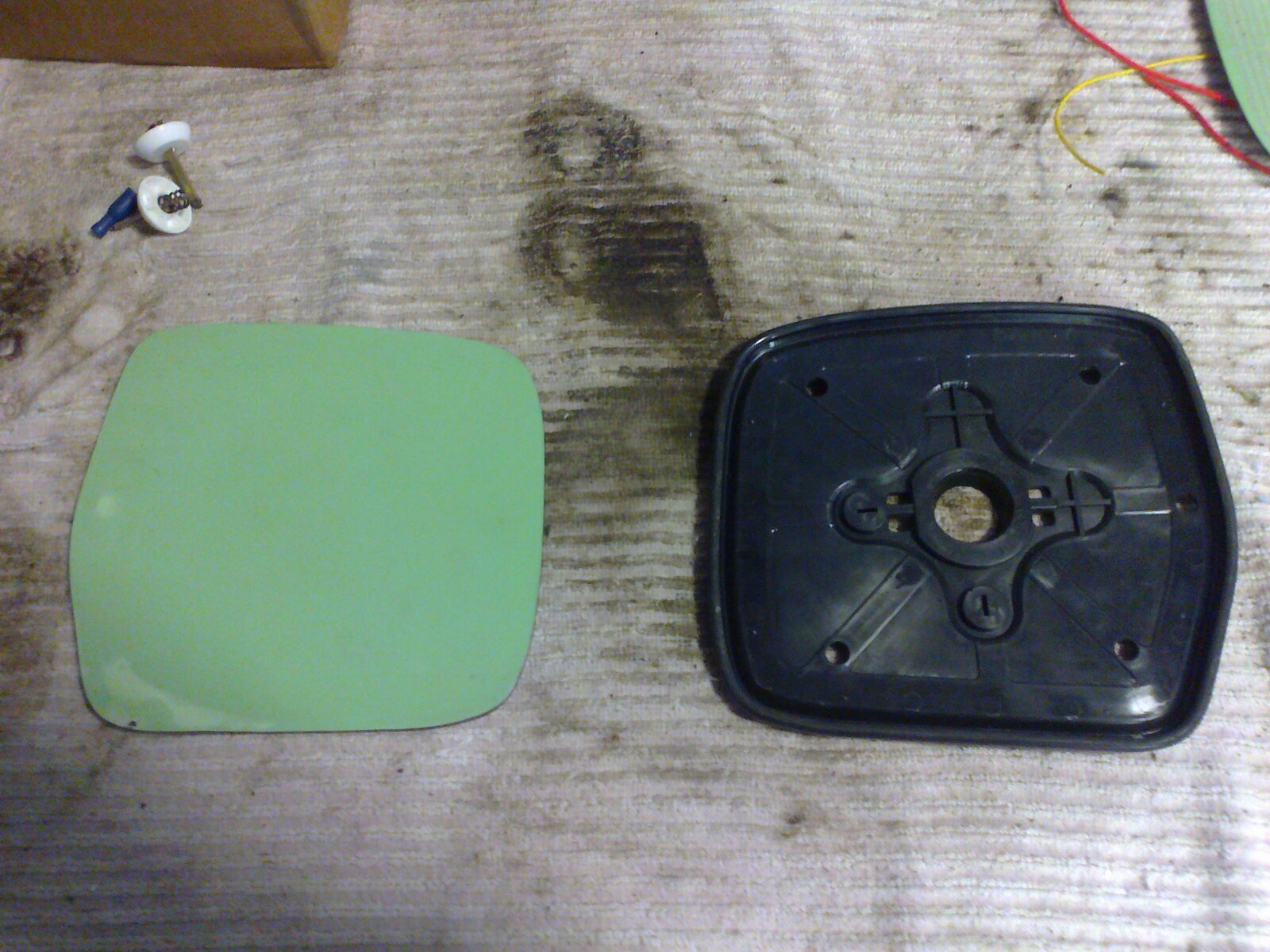

I soaked the glass and plastic backing in hot soapy water to soften the plastic and help release the adhesive pad. carefully remove the glass from the backing.
clean off the old adhesive.

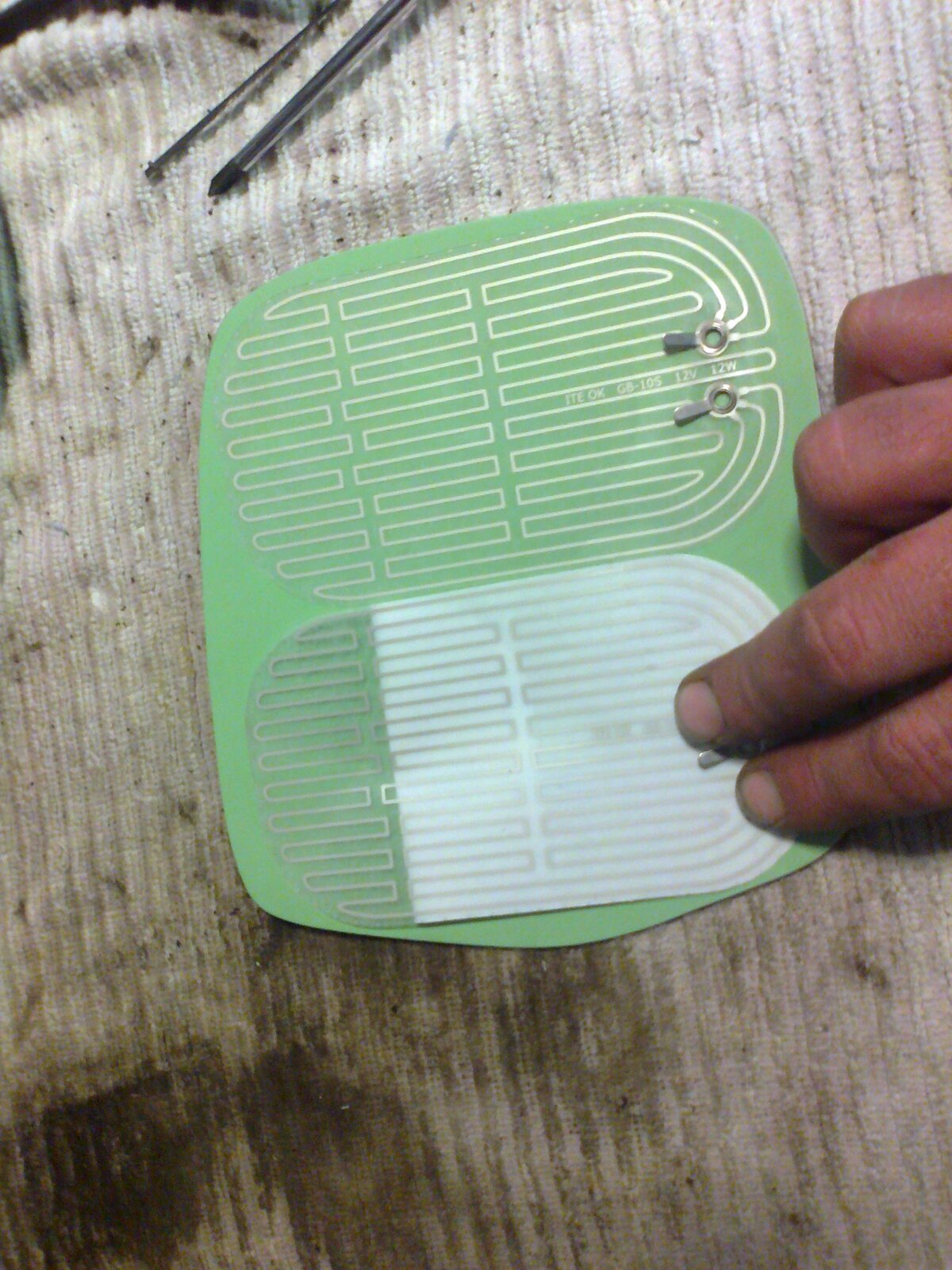

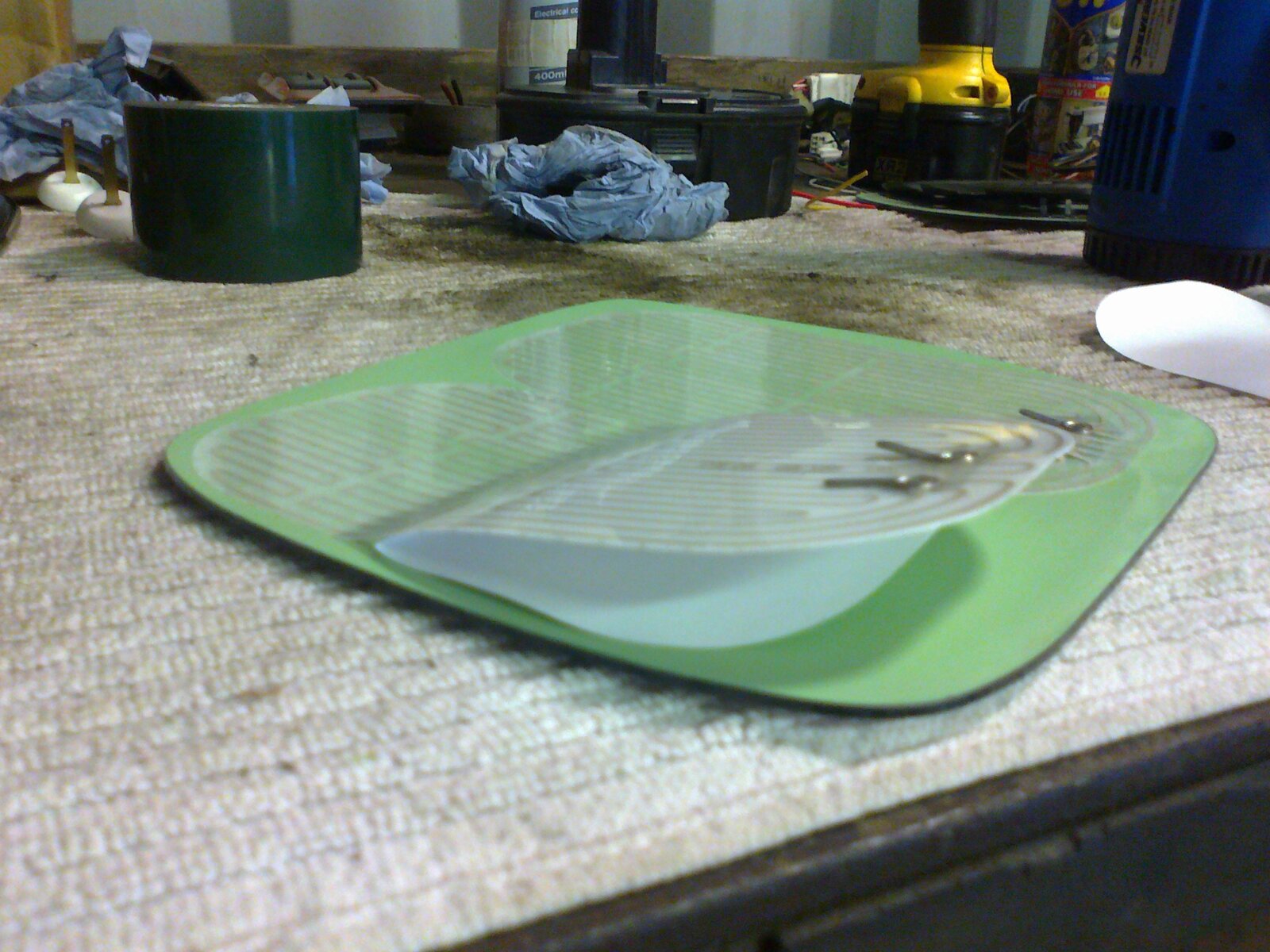

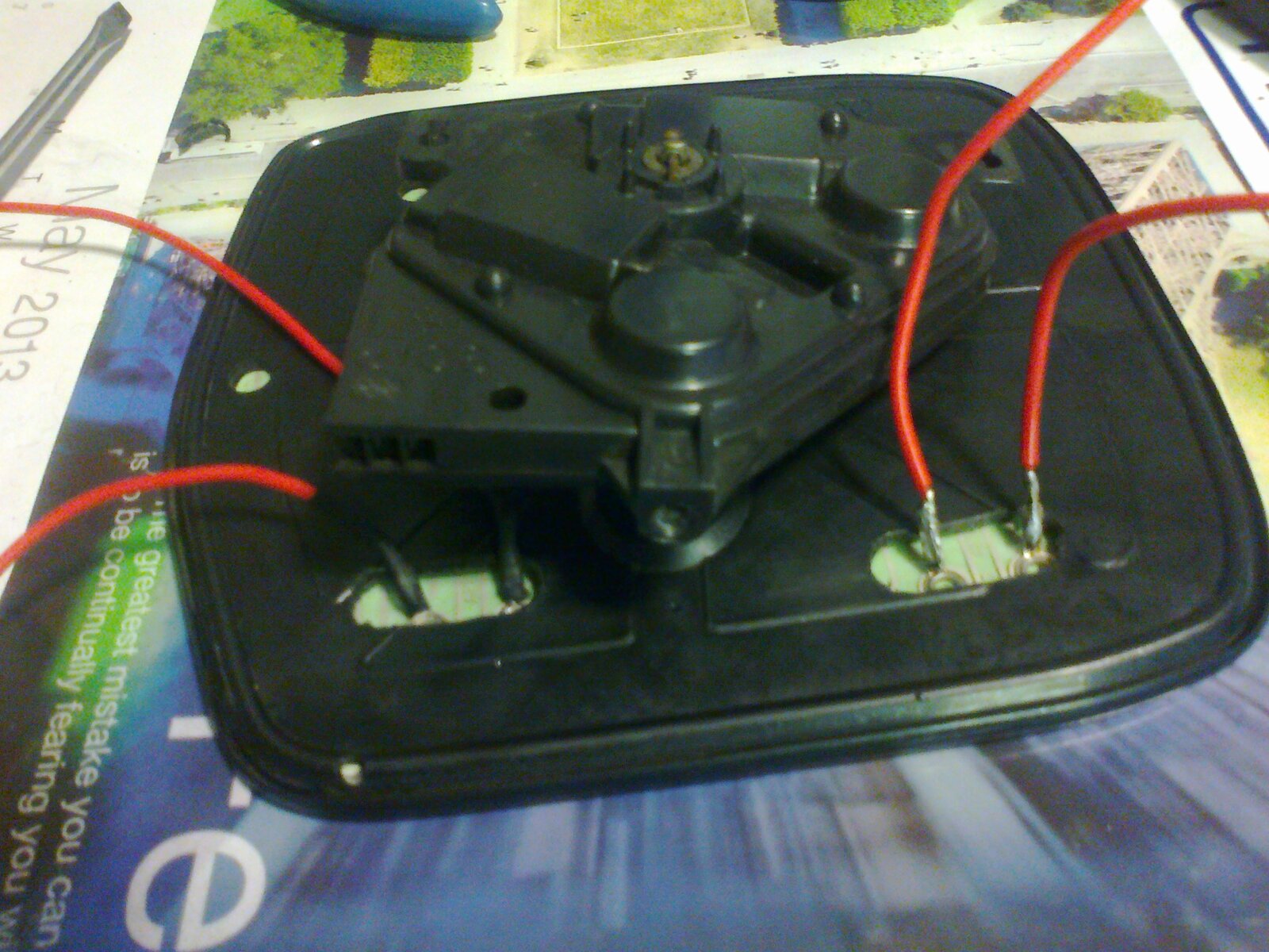

carefully apply the heated pads, theres not much room so do a dry run first.

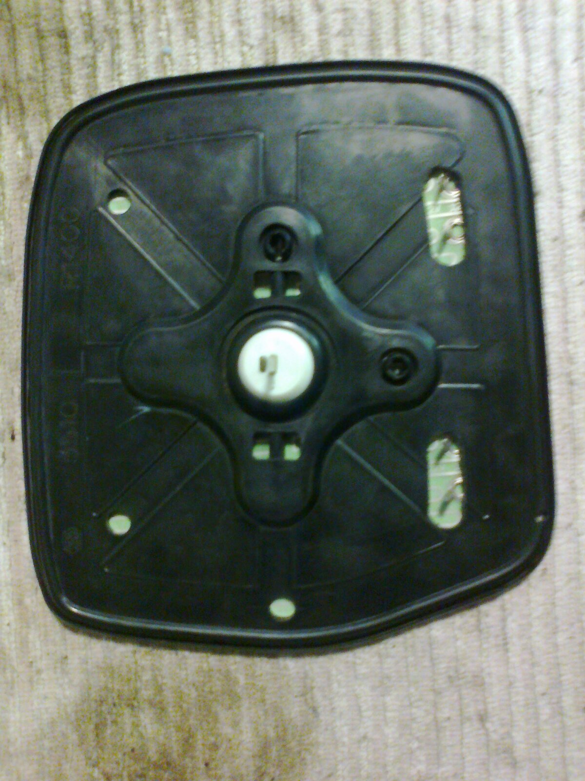

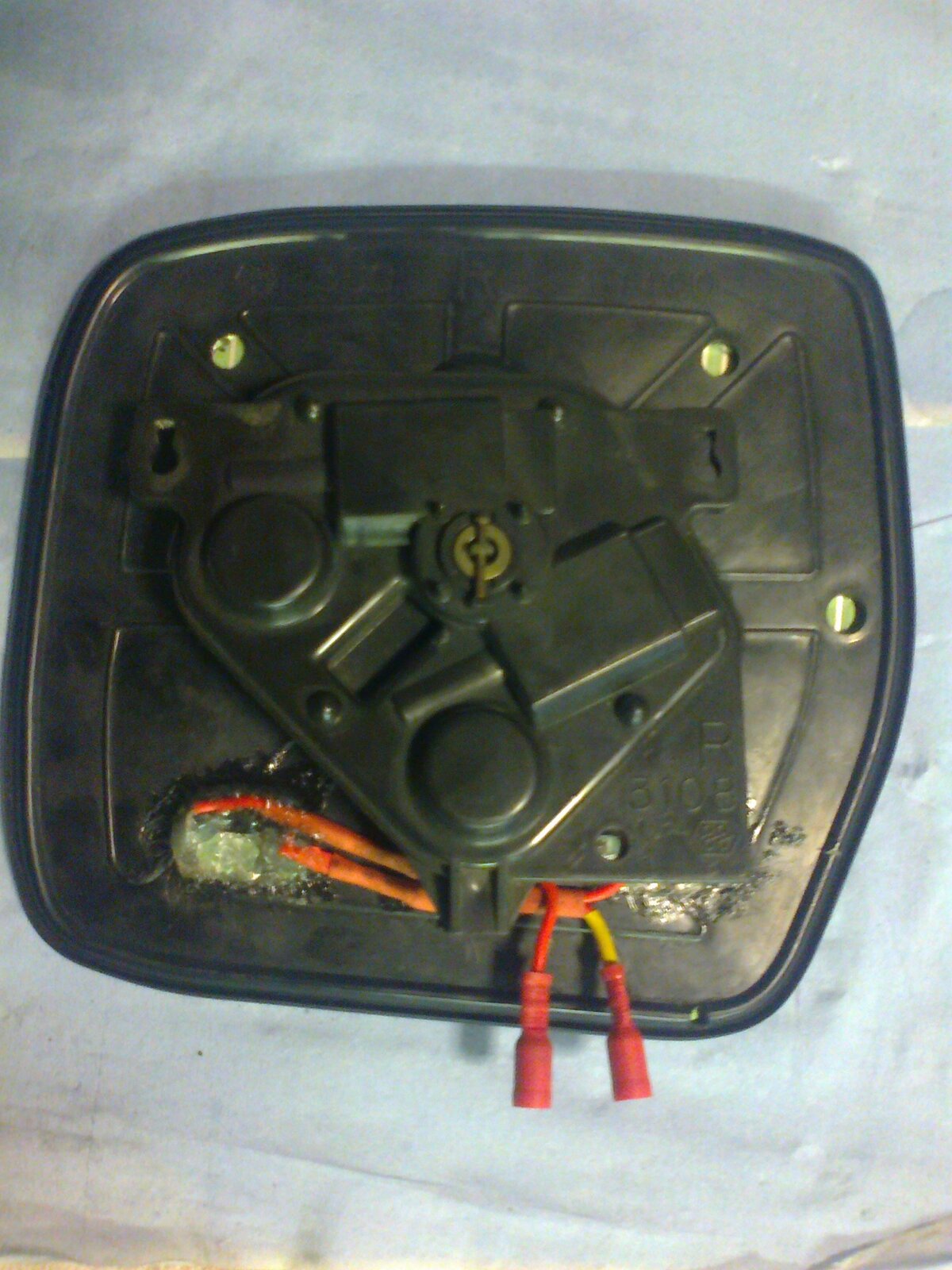

cut holes in the plastic backing for the connectors.
phone pics 088.jpgphone pics 089.jpg the mirror is mechanically fixed as well as the small adhesive pad in the centre, so I only used four small blobs of adhesive. soften the plastic backing with a heat gun before carefully refitting the glass.

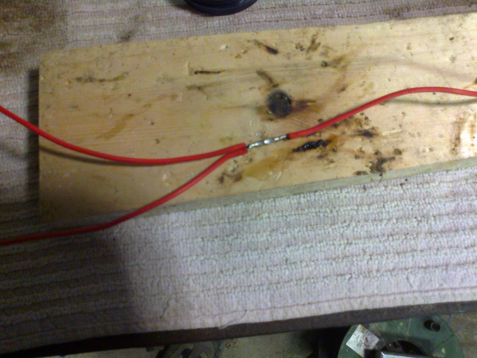

I chose to solder the wires to the spades. after I added connectors I sealed the spades with adhesive.

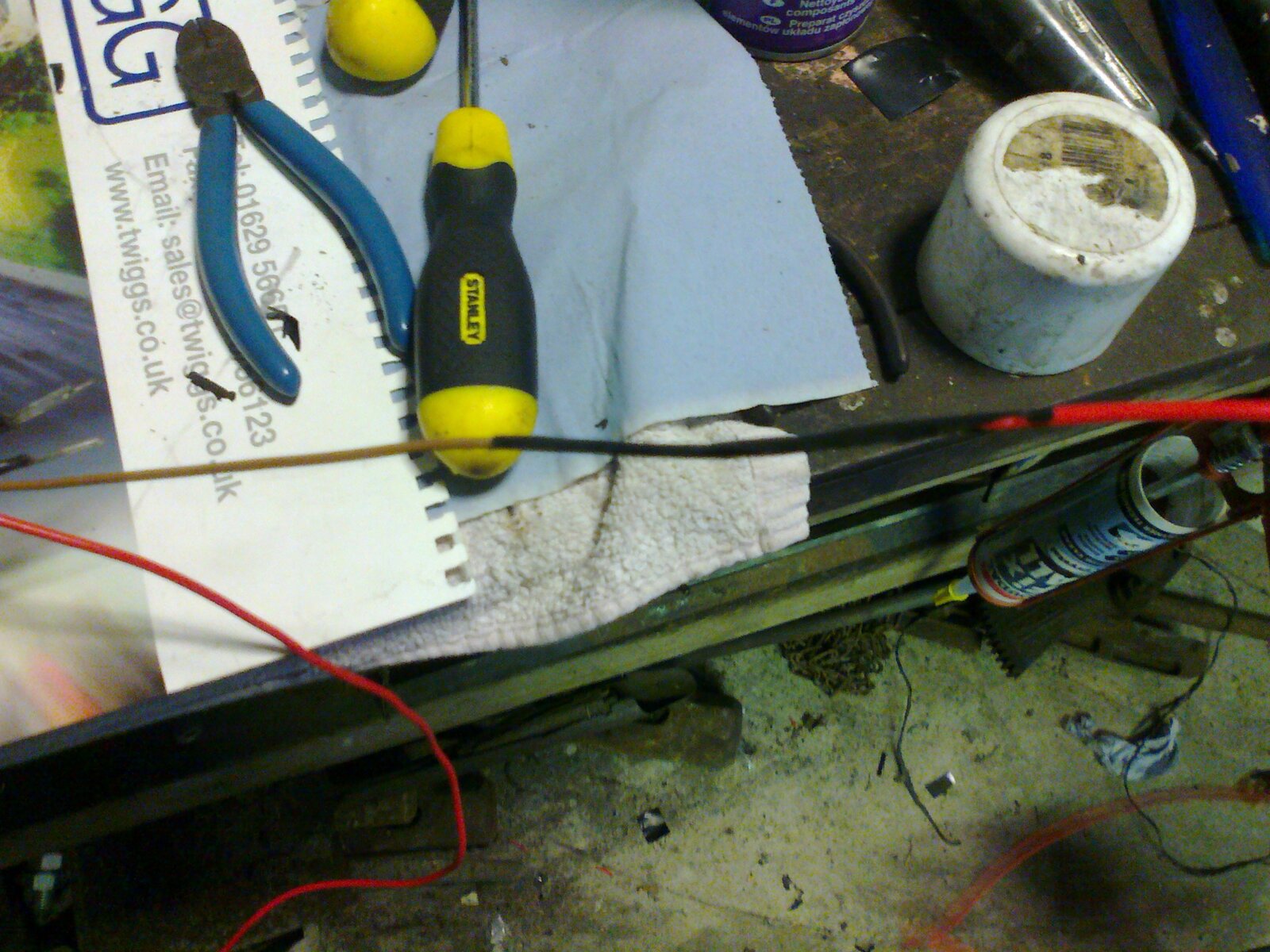

I pulled the wires through the mirror internals with my favourite wiring fishing tool, solder.

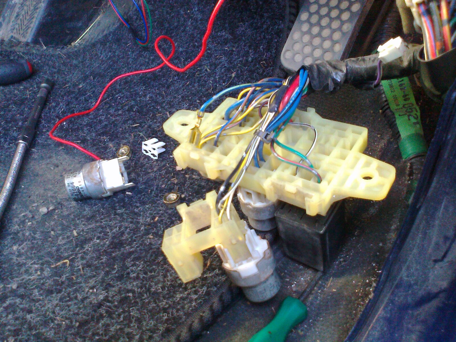

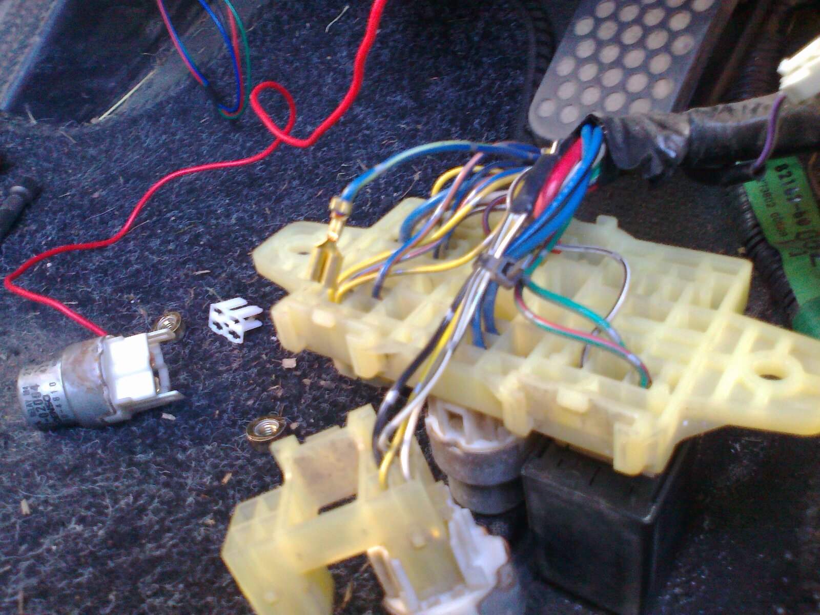

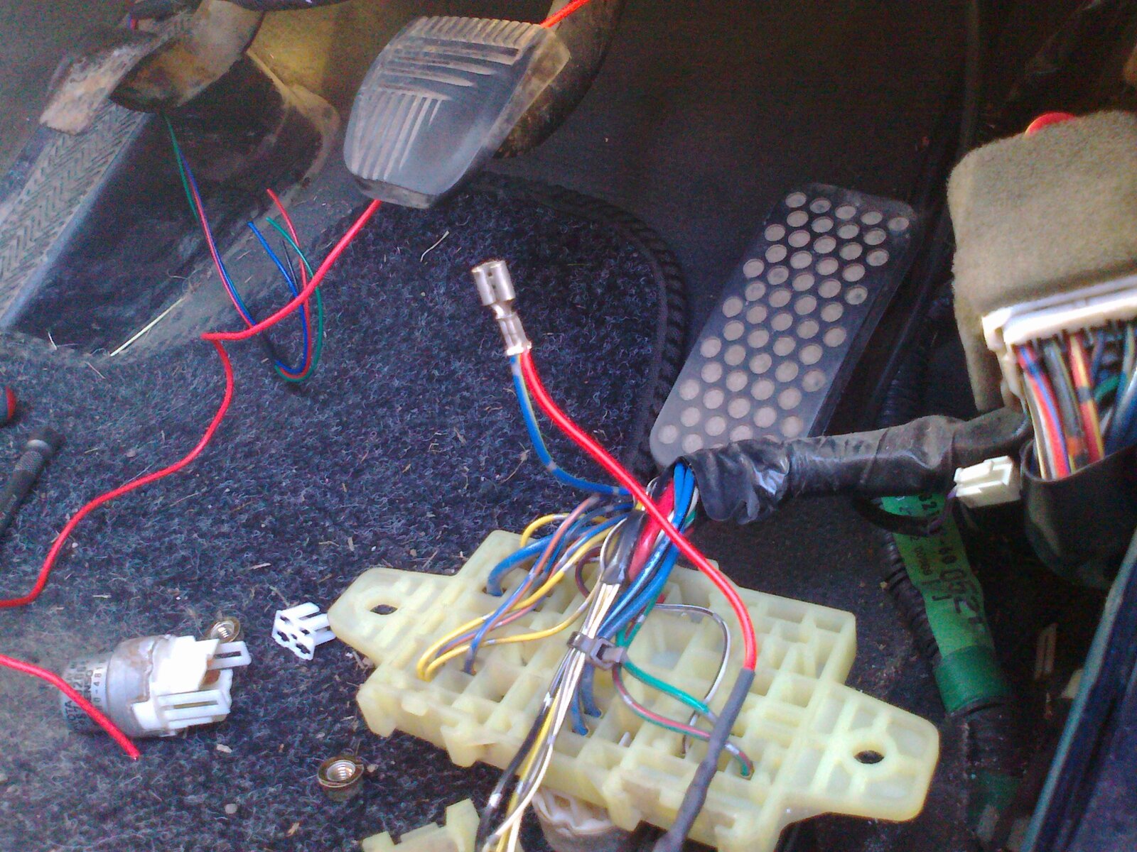

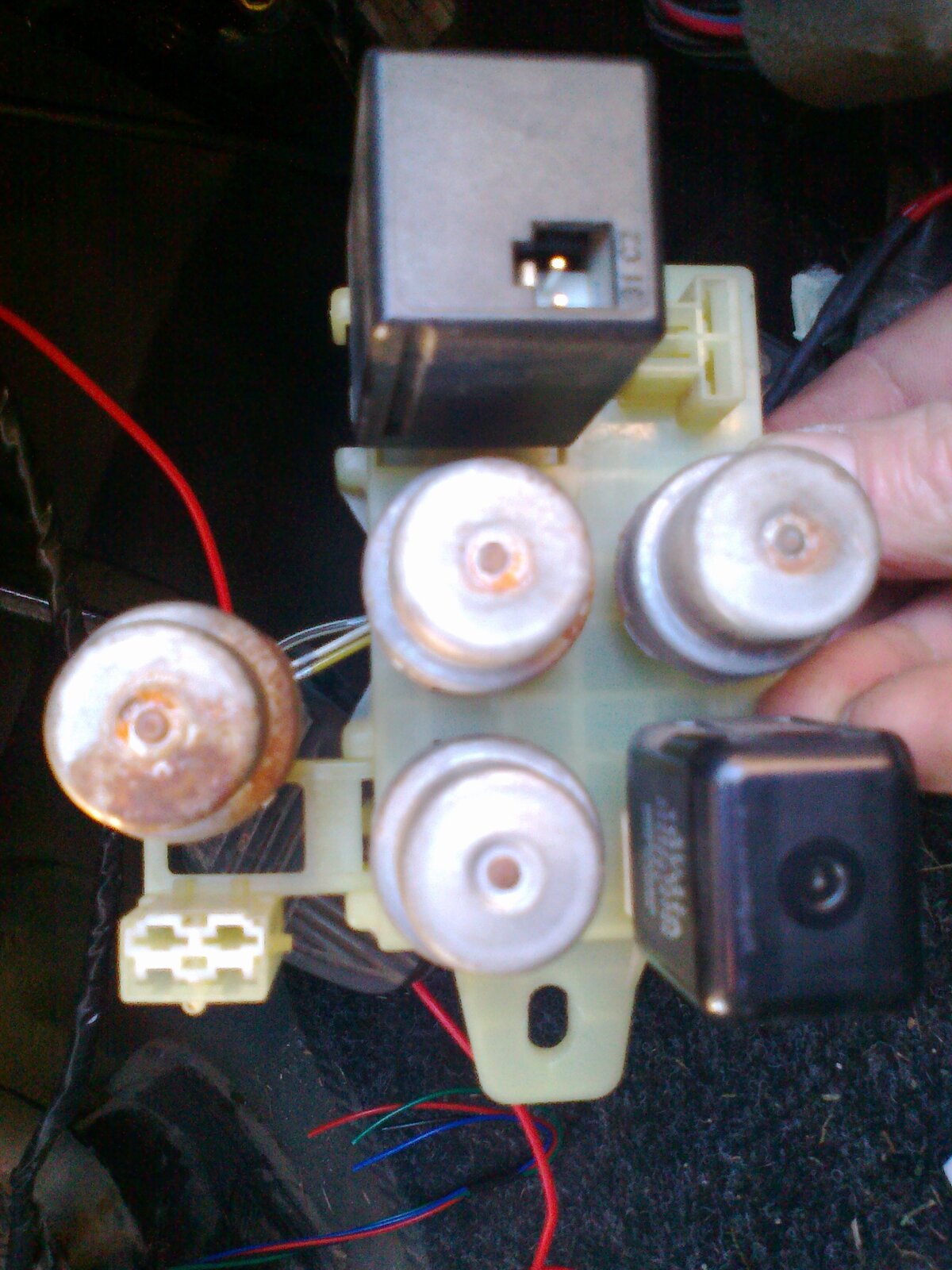

I took the spade connector out of the back of the rear defrost relay, and soldered my positive to the back of the connector, this feeds both mirrors.

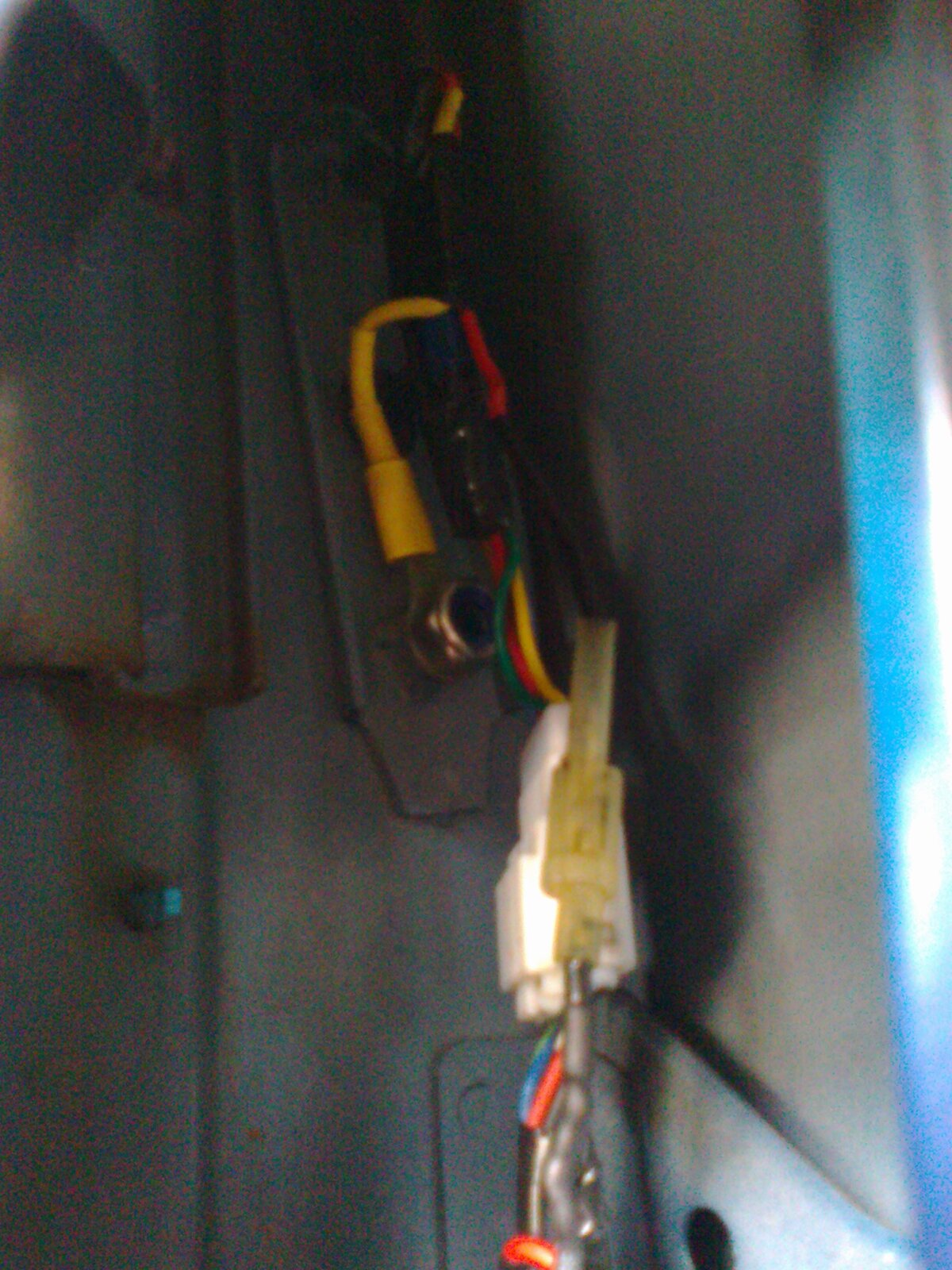

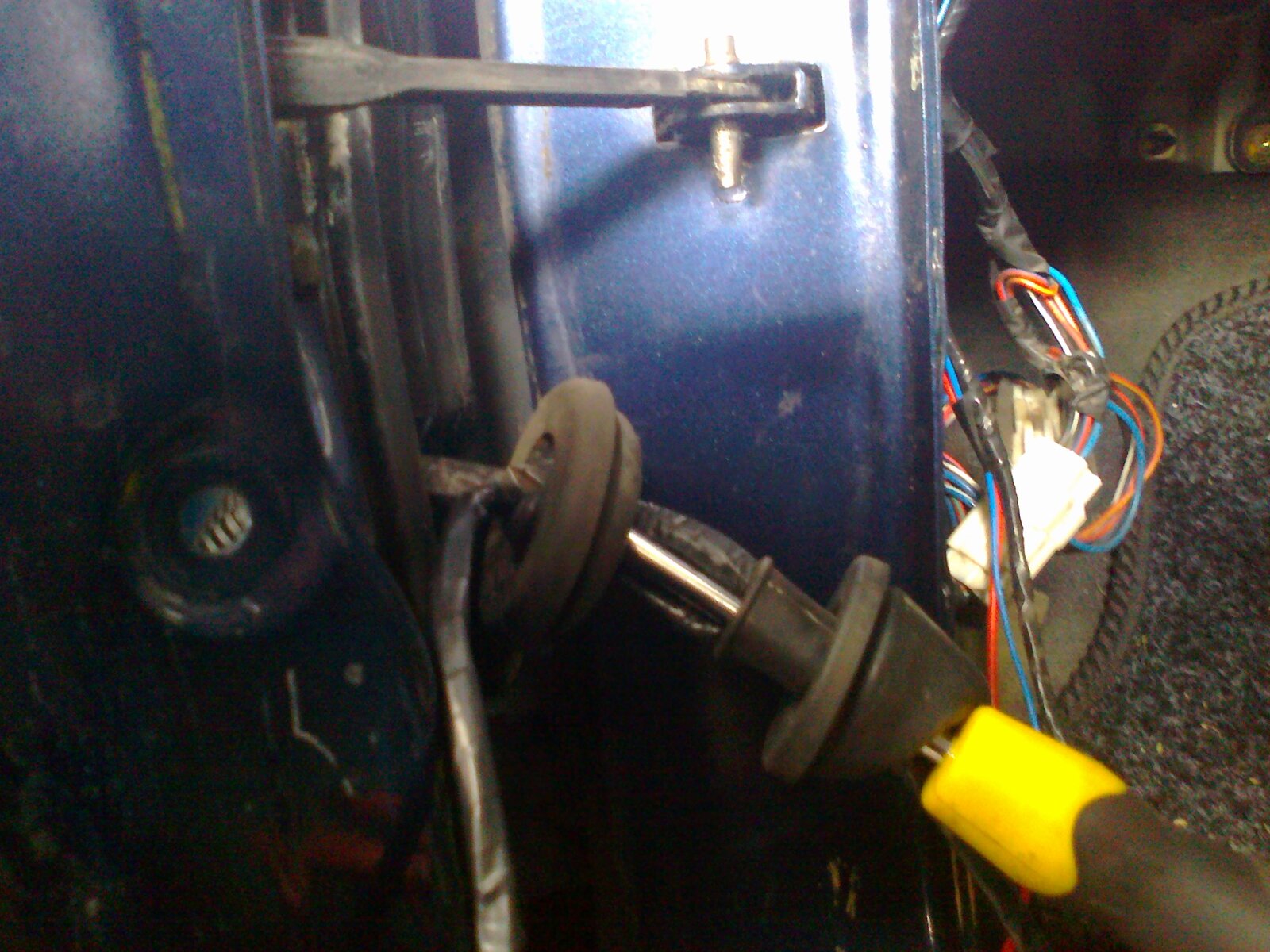

I ran the earths to the factory earth points behind the kick panel. the tempting bolt off the hinge inside the door is not a good earth point!
this was a bit fiddly, but got there in the end.

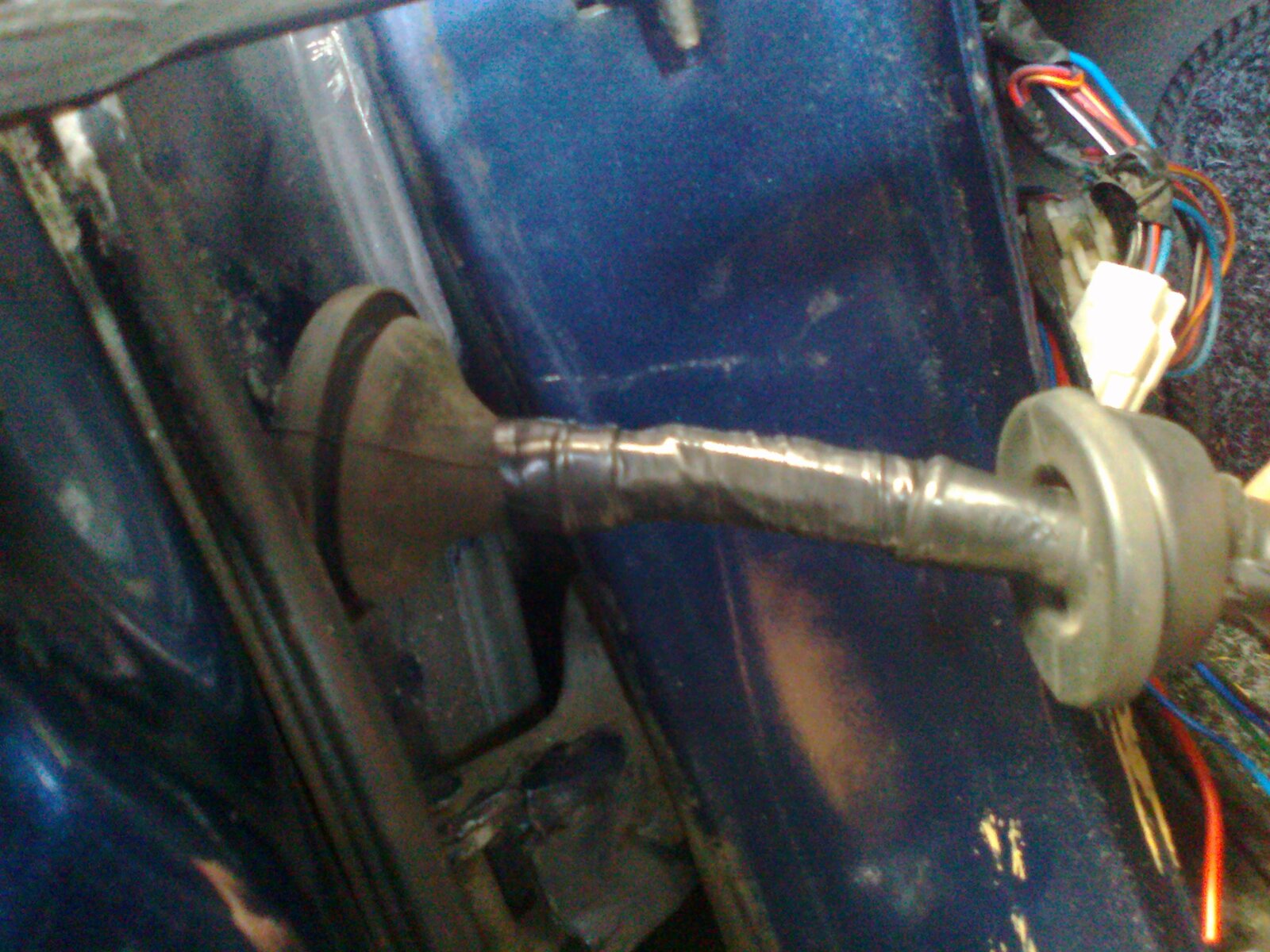

taped back up after the wires were fished through.

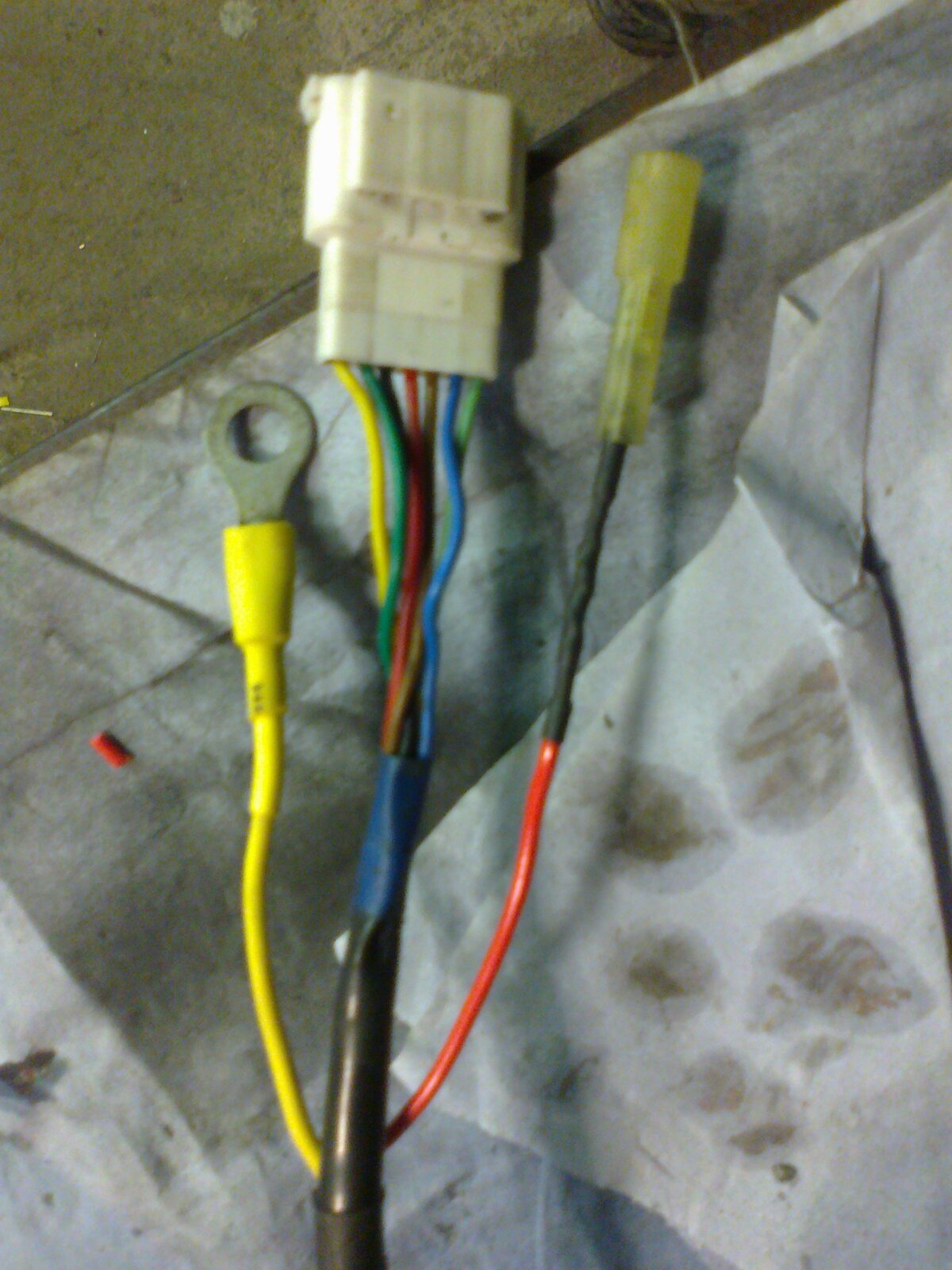

I used a couple of old rear defrost connectors to make my new ones.
that's about it I think, coming off the defrost relay means that the heated pads are also on the defrost timer
