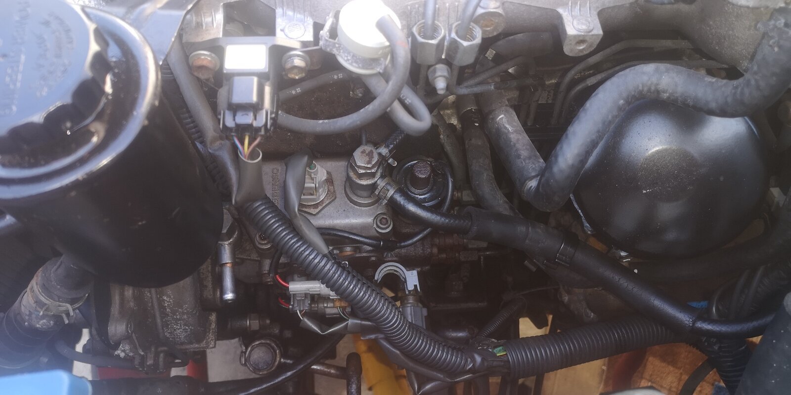

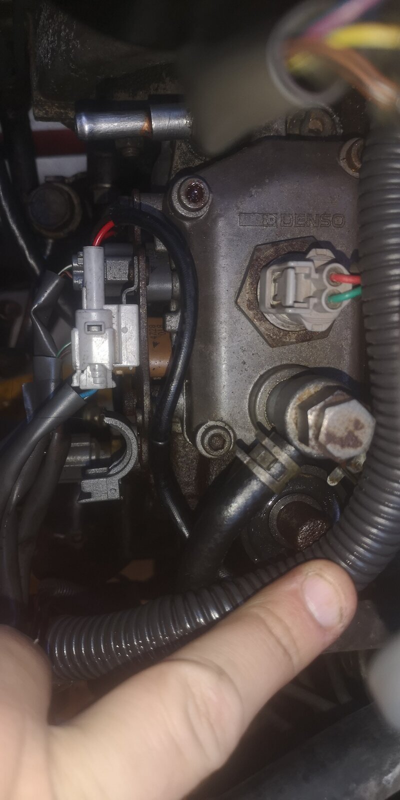

If he would have diesel at the injectors it would keep running ;) Diesels need only 2 things; compression and fuel. First thing it to bypass the ecd relay and see if it keeps running. They're prone to fail with time. And now most important thing, does it still have efi pump? Photo from under the bonnet from around pump would help.

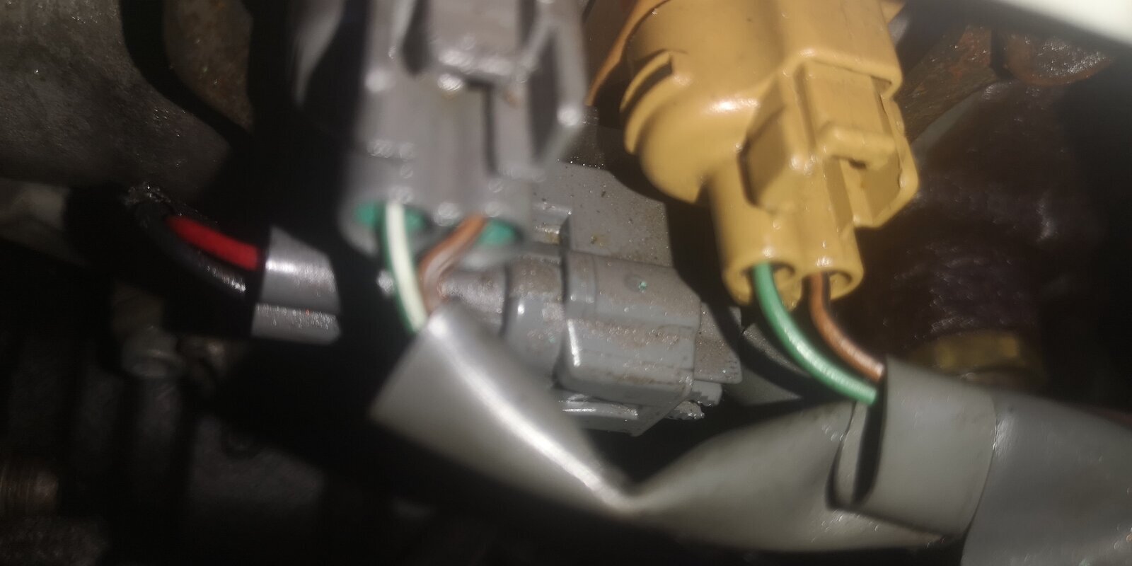

Yes, is an EFI. first time it started and runs perfect for 20 sec and than stalled. Also, when the ignition on, i can hear the relay of ecd and the thing on the top of the engine(black small one, wich is in the picture)

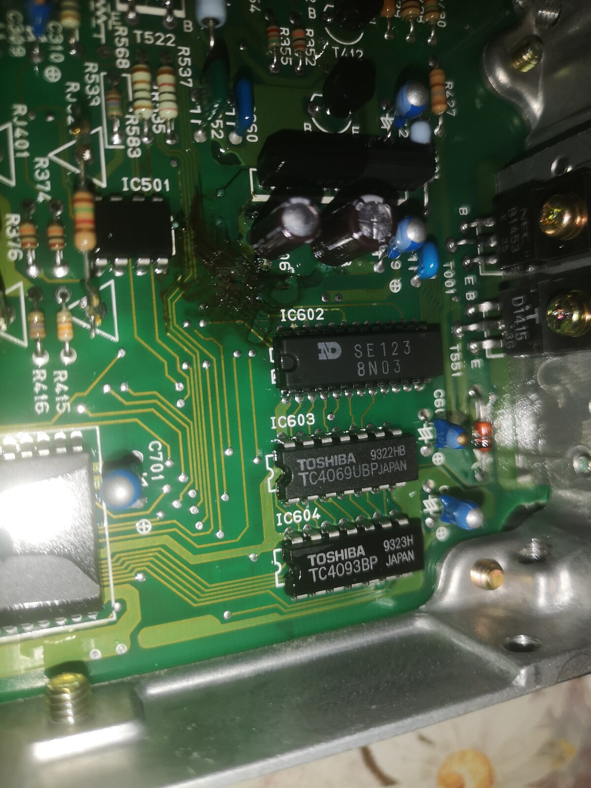

Depends on how confident you are with a soldering iron, but I would replace both of those capacitors with new ones, clean the board up and hopefully should be fine
Can’t see to clearly from the photo, but the left of the two capacitors looks like it’s bulging so has probably blown, though they usually make a bit more of a mess from experience. I would clean up the board with some fast drying contact cleaner, or similar, to make sure the tracks around are not damaged and definitely replace at least the left of the caps. Capacitor will only be a few pence, look on the side of it to see what value you need should specify voltage and capacitance. Don’t worry too much about the voltage as long as the replacement is at least what you have in there now. Also ensure you get it the right way round, these are electrolytic capacitors so have a right and a wrong way.
